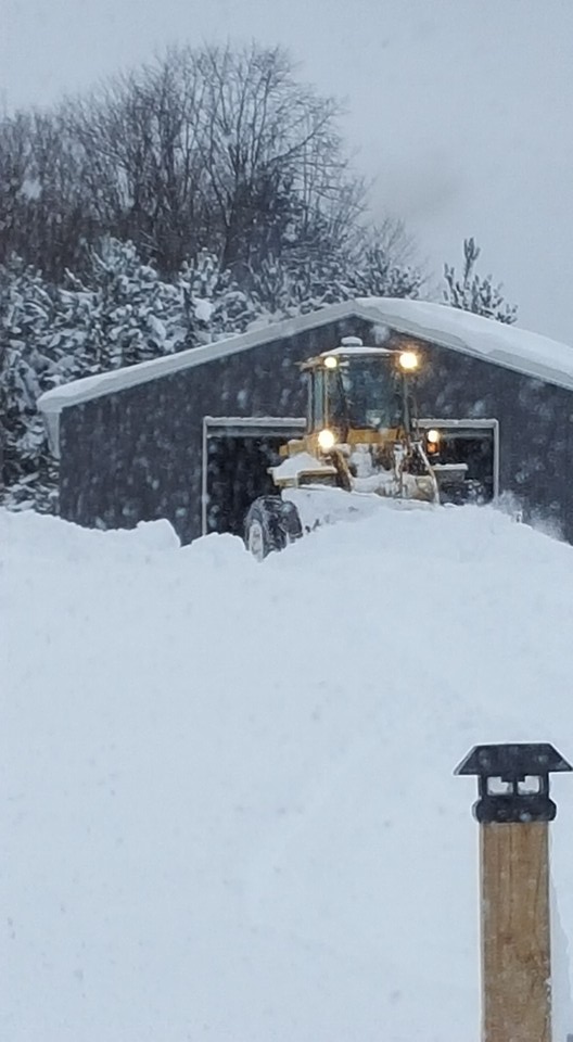

Driveway is sandy and straight, approx 200 feet off the road. We are not on a lake, but we do visit 12 months out of the year. We average 151 inches of snow per year. It has been as high as 245 and as low as 88. The tractor would be stored inside the Pole Barn. I have trucks to move the equipment.
I also have an old jeep with a plow that I use for snow removal. The tractor would be a back-up in case it gets too deep like last year. I didn't get a chance to get up there for approx 3 weeks and the snow piled up. The snow was about 3 feet deep with 6 ft drifts in areas. Needless to say a nice gentleman on a giant construction loader assisted me.
I have also looked at older 40-50 hp 2wd tractors with FEL for the weight. I can spend 10-15 k on a 30 year old tractor with 50hp or 25k on a brand new 4wd 30-35 hp tractor with a warranty. I like the idea of knowing how the machine has been used. That is why I am leaning toward a new machine. I can go either way. I was looking at an older ford 445 with FEL and cab for a great price in good condition. My only issue is parts availability on a 30 year old machine in the future.

Holy crap man! The jeep will snowplow better than the peanut tractor! A loader tractor DOES NOT STEER without FWA (front wheel assist, which is what these tractors are. 4WD tractors are those huge ones you see in the prairies).
Think bigger.
Forget the old 2WD. They are marvelous and nice to drive in the summer out in the cultivated fields.
Find a good used FWA one or spend more money. Be careful with ancient FWA tractors. Many of those were problematic.
50hp... still a little tractor.
block heater, loaded rear tires. Beet Juice or Calcium.
Do you want to buy another one in a year when you find out that 30hp is not enough? Like so many people do?
25 grand is a good chunk of change and will buy you a good tractor in the size you need. Used. Tractors are like cars except they are more reliable. And have way less crap in the way of seeing them for what they really are.
