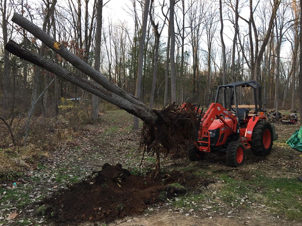

Regarding the small tree removal. I was surprised how this worked out with my first tractor.
My 19hp tractor (same weigh as modern 25-30hp CUT) could push over may trees in the 6-8 inch diameter range because the trunk was ridged enough to pop the root ball out. However, for smaller trees, the trunk would just bend and the roots would not come out. The loader was not strong enough to pull out most smaller trees with a strap so it didn't work well for that.
Then I got the 45hp tractor and this one seems to be able to cleanly remove about any tree (within reason) because it can pull the flexible ones straight out with a strap. it can push over most that are <12 in diameter and pop the root ball up. And it has enough loader to dig up a root ball trees too big to push over using a narrow stump bucket - sure a back hoe or better yet excavator would be a better for this but for the occasional stump it will get it done.
I'm not actually sure how much loader is required to rip out the small trees that you have. On my property, 1600 pounds breakout force with a pinned bucket was not enough for 3-5 inch trees. 3800 pounds breakout force is plenty but I usually remove the attachment and strap directly to the SSQA mount. I can't tell you where between those two is just enough. With forks you can pop out nice size root balls very quickly. Push the tree over then put forks under the ball. lift and dump at the same time to pry the ball out of the ground. In about a minute you've completely removed a fairly good size tree.
