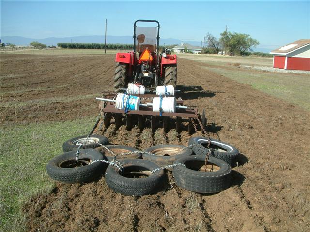

I plow my 6-acre hayfield with an old 7-ft Towner offset disc with that Mahindra 5525 I mentioned previously.
It's a heavy disc--probably 800 lb-- and I add about 500 lb of extra weight with those concrete-filled buckets strapped to the disc to get the disc to bite better and use a tire drag to help break up the clods. I tow it at 5-6 mph in 4L gear. You need high ground speed to get discs to work properly.
So the tractor hp you need will depend a lot on the soil condition in your food plot areas. My soil is pretty gravely and hard, not like typical Midwest soil so I have to make several passes over my hayfield at different angles to get the plowing done right. If your soil is softer, your disc probably with bite deeper and you won't have to make as many passes as I do. But, remember, the deeper the disc bites, the more tractor hp you need to pull it. I'd check with nearby neighbors to find out what tractor hp and what type and size discs they use and recommend.

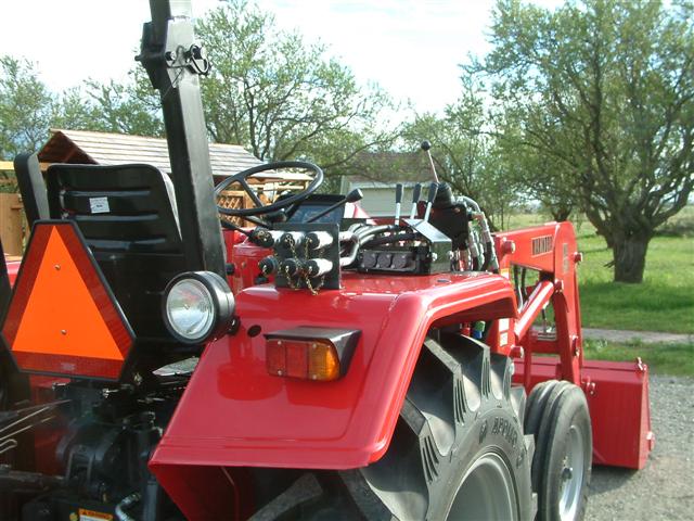

Don't know if skid steer FEL QA is a standard Kubota feature, but I have it on my Mahindra 5525 and highly recommend it.
Also, get double or triple remote hydraulic attachments on your new tractor. It's easier (and likely cheaper) to get these when you buy the tractor than retrofitting them afterwards. Here's a photo of the triples on my 5525

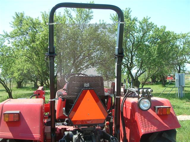

I also recommend a metal safety shield to protect yourself when you're using your bush hog rotary mower. Here's mine-- a piece of expanded metal screen from Home Depot (or a local weld shop) attached to the ROPS with hose clamps (don't drill into or weld to the ROPS).

I took a pretty good lick in my back while operating a rotary cutter about 10 years ago. I went to the house to have my wife see what the damage was and she found buried in my back a piece of fence wire about 3/4 inch long. She just pulled it out and no long term harm came of the incident, however, I went straight to my shop and cut a piece of plywood to go behind my tractor seat. That metal screen or something similar would be a must for my cutting, if you don't have a cab. Ken Sweet

That metal screen is a great idea. I will definitely put one of those up. A buddy works at a welding shop/manufacturing facility. I'm sure he can hook me up.
