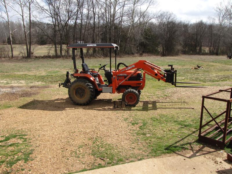

I kept it pretty simple square tubing and some flat stock notched welded to it.. 48 forks.jpg

I kept it pretty simple square tubing and some flat stock notched welded to it..View attachment 480715
These both look pretty clean and I think would be easy to put together. :thumbsup:
Dieselcrawler: So, it if you used 3" channel the plate welded on must be .5" x 4"? Looking at it, it looks like it might be perfect for the tractor that it is on, but a bit overkill for mine (I wouldn't be able to carry any real load!)
Mykleh: Similar in concept to Dieselcrawler's... and it doesn't complicated at all. Again, do you remember what size stock you used and also, do you have any idea what your's weighs? Is the frame solid under heavy load or do you have bit of flex? Did you just grind out the notches?

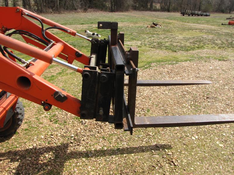

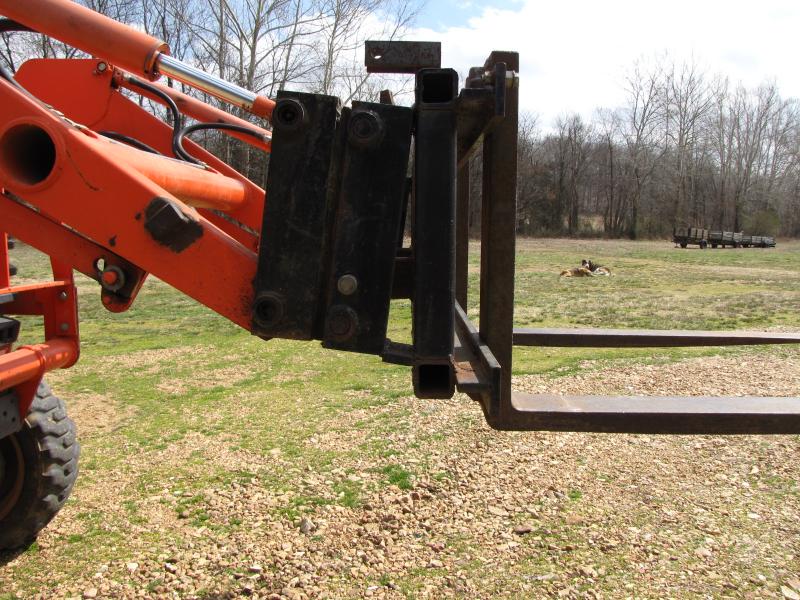

Here is another picture, of the part I built standing up, and attached to the original quick attach part, also homemade, laying on the floor.
Yes, the 3" angle has half inch x 4" plate welded to it, I actually salvaged 4" angle, cut it at the apex, warped the he!! out of it, straightened it out, matched the straight edges so the forks would have parallel edges to fit on, and got it to work... alot of work to save a few bucks and a trip to town to just buy half x 4" flat bar!
This is fitted to a Kubota L4310 with westendorf loader, handles 2400 lbs and lots of abuse well. Your 790, like my 3005, is half or less of that tractor, and could get by with lighter construction. I also tend to overengineer things, for safety, and I hate to fix stuff that breaks.

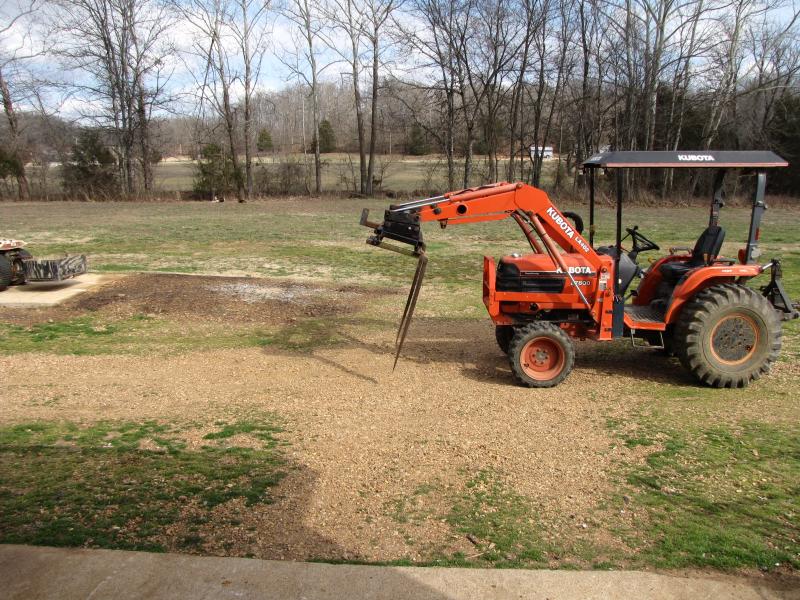

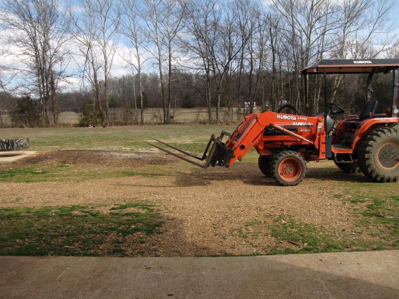

Here is how I did mine. They work on the 3 point also.

Thanks for the extra pictures. Yours certainly looks more than strong enough and way stronger than what I would need. However, like you, I like to over engineer a bit just to cover those contingencies that always seem to come up expectantly. However, as you understand, I have to put something together that hopefully still gives me some real working capacity with my wimpy loader.
Maybe drop down to a .5 x 3 flat bar with a 2x2 sq tube welded on the back or even a .5 x 2 with a 1.5 x 1.5 welded on the back? Support of the vertical forces could even be enhanced though the use of a bit of truss system.
What my main concerns are centered on is the twisting force that a load on the forks would exert on the carriage in addition to the downward force. A load extended out over the forks would also tend to pull the top bar of the carriage out (or forward away from the tractor) while pushing in (or towards the tractor) on the bottom bar.
In addition to looking at a bit smaller bar and backer, I think that the verticals that connect the top and bottom .5" bar assemblies (and maybe even the backers to the bars) could be swiss cheesed full of holes just like an aircraft frame. This would certainly lose some weight while maintaining most of the real strength.
