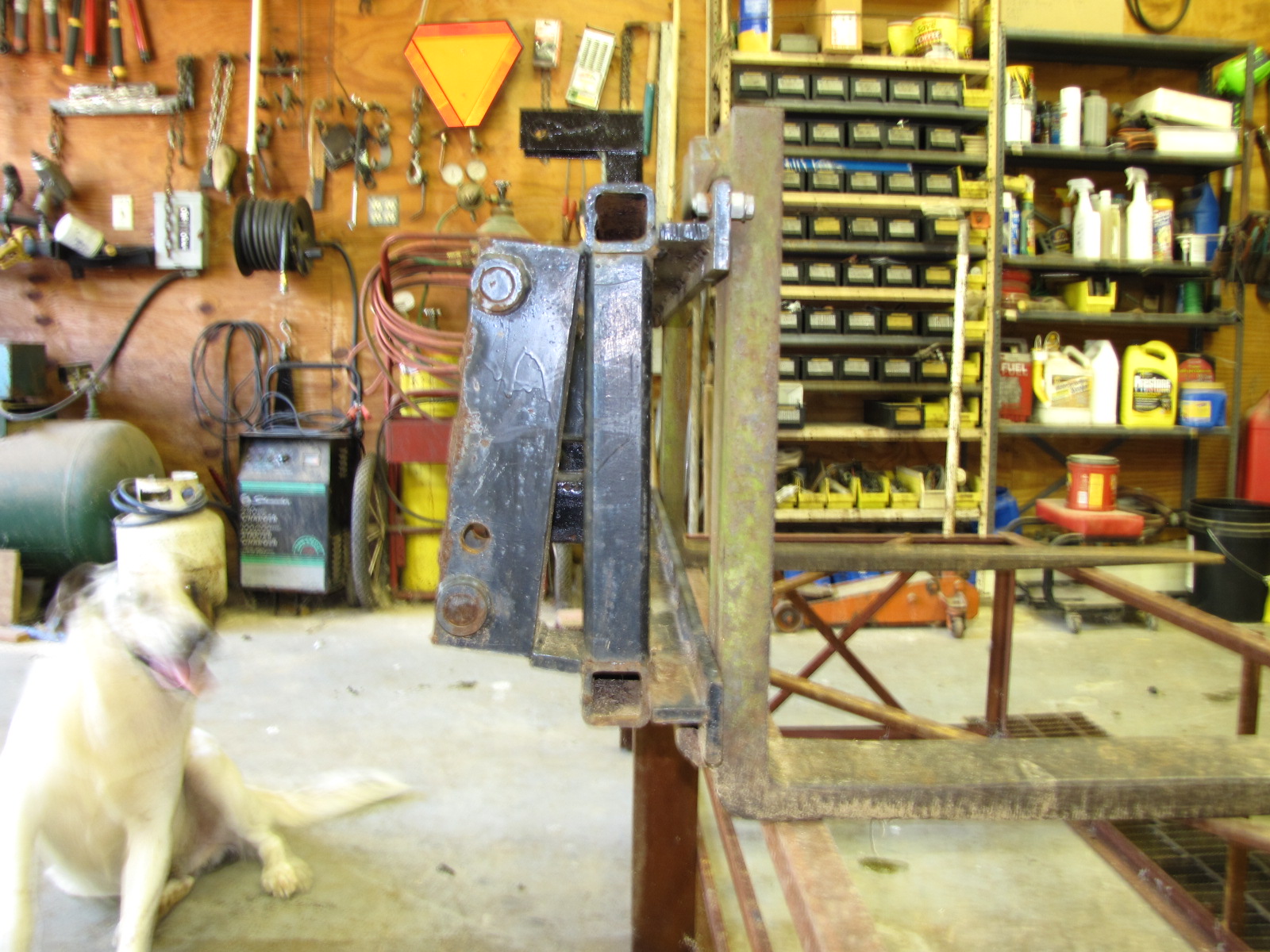

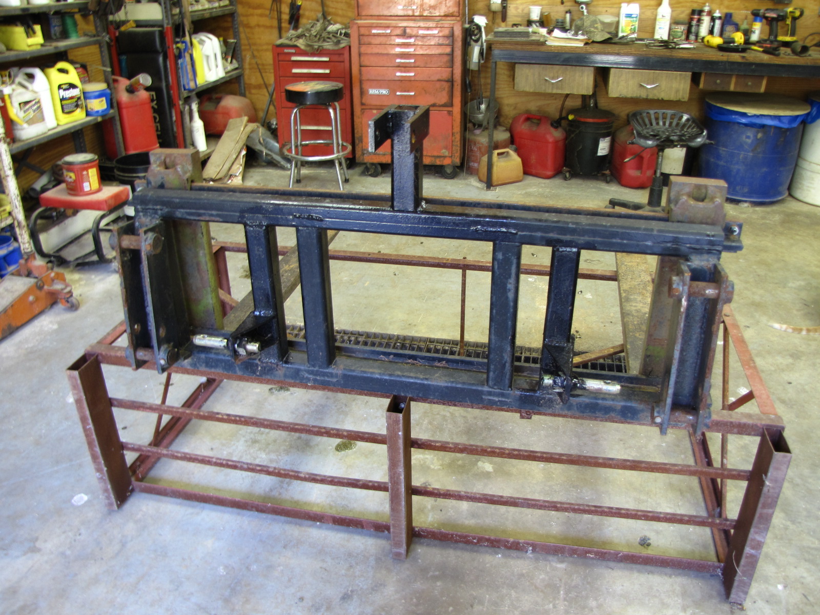

The T is 2 3/4"X 1/2" on the face and 1 1/2"X 1/2" for the web. You have to make sure the face is up high enough to clear the fork lip after welding. Same for the bottom T and it's the same as the top.
The frame is 2"X 1/4" wall, that does not have to be that thick, 5/16" (Did you mean 3/16"?) is enough by far. I always keep 2" tubeing around and the 1/4" must of been what I had at the time. Also it does not need 4 center pieces, I added the 3pt later.
If you think you might add the 3pt later set the 2 center pieces at 12" from C/L to outside edge and that well give you 24" outside to outside of tube. With the pins takeing up 1/2" on each side and you use 1/2" stock for the pins you well end up 26" or cat 1.
My mounts are kicked out 10 degs. and 44" wide to match my tractor. The fork frame is 48"

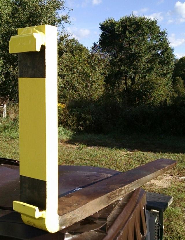

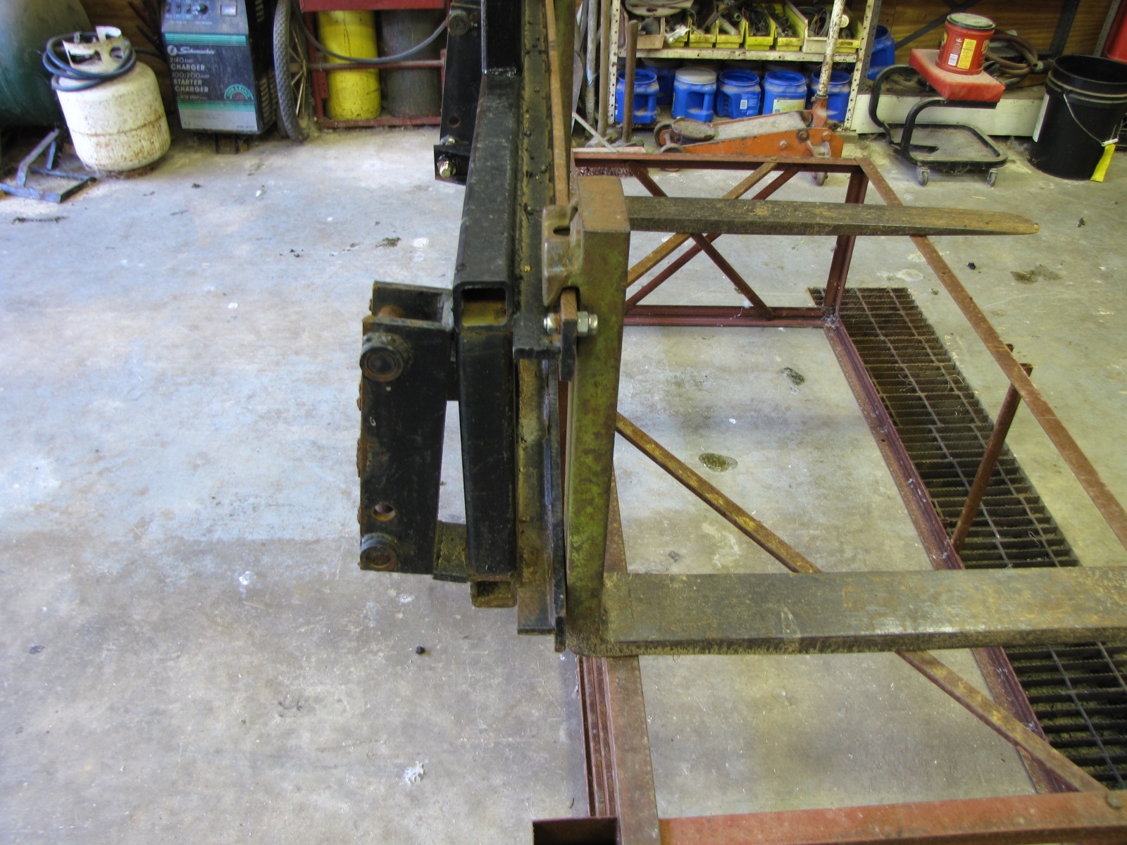

Here's one of the forks that I'm dealing with. The pin assembly has been removed, cleaned and also painted with the springs themselves replaced. The little cam lever that lifts the pin was gone and only a bit of wire was used to pull up the pin in order to move the forks along its rail. I'm going to have to find out where they can be bought (can't be that expensive) or at the worst, take piece of sheet stock and cut, bend and drill out a set.
Obviously the yellow paint job is mine. I had some old tractor yellow laying around so I cleaned and de-greased and then painted those areas that will not come in contact with a payload or floor/ground and also a 3" area where it should contact the carriage. Why paint? Well, why not? Actually, I must just be excited about putting a real set of steel forks to use.

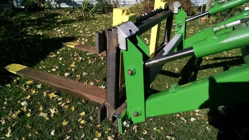

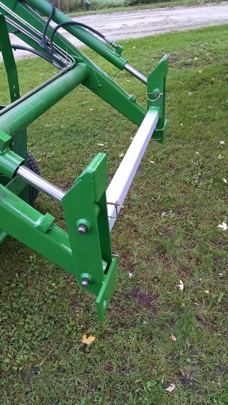

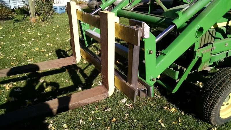

OK, got part one done (quick attach conversion) done and just finished up part two which is the fork carriage.
I want to thank all of you who made suggestions (either here or in the other "Gotta convert loader to Quick Attach" thread) and especially a big thanks to Xfaxman for suggesting the "rollback" - I went with two inches back in 16 inches of height.
and to zmansmac for the heavier crossbar suggestion. I went with only 2" but that's up from the 1" that I had planned.

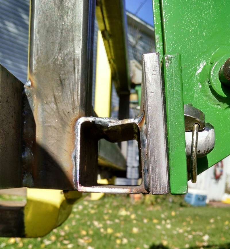

and I also borrowed the wing concept to help catch the loader arms from sd455dan. Hard to see in the picture, but they angle out about a half an inch.
Finally, I looked at a number of suggestions like from DieselCrawler to come up with just a simple basic frame which is way stronger than anything I'm going to be able to carry. I used 1.5 x 1.5 x 3/16 inch tubing with the bars being 3" x .5" - everything welded up solid.
Thanks again all for your support! :thumbsup:
Now, for some paint.....
