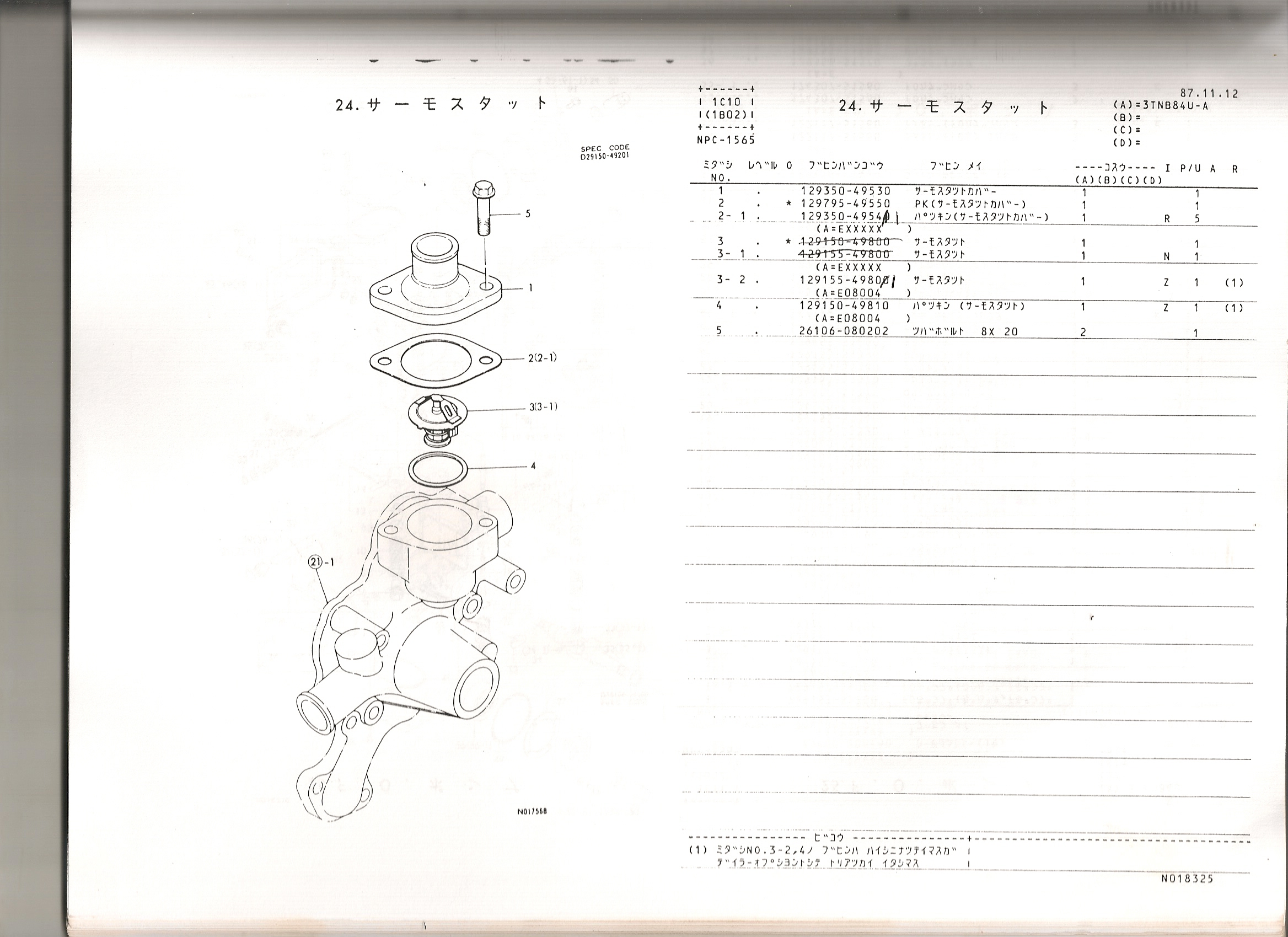

Check the thermostat. It must be removed to flush anyway.
   / Need Help - F24 Overheating #4
Were is the Thermostat on the F24 just to clarify were it's located? Apparently not under the Flangy thingy do hicky.
   / Need Help - F24 Overheating #5
Unless missing, it should be where the upper hose attaches to the engine, either inside or under a housing. Have never seen a F 24, but that's where all tstats are located.

Yup! The Master of the Manuals. Getting a little slow finding this one though.
Bad news: my tractor is missing part numbers 2, 3, & 4 shown in the exploded view above. Other (bad?) news: the radiator cap holds pressure indefinitely, but the radiator itself holds no pressure at all. It leaks air as fast as I can pump it.
