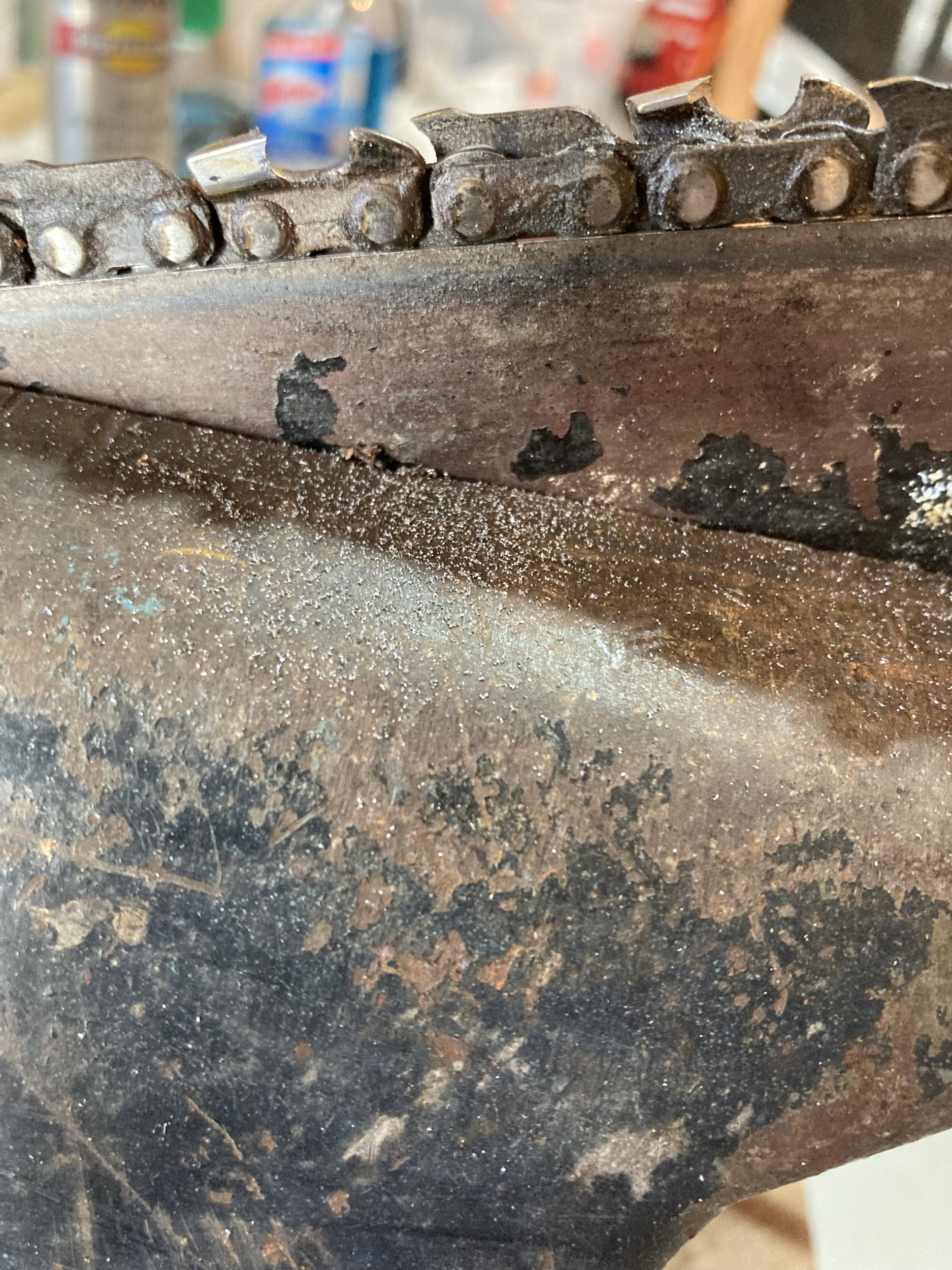

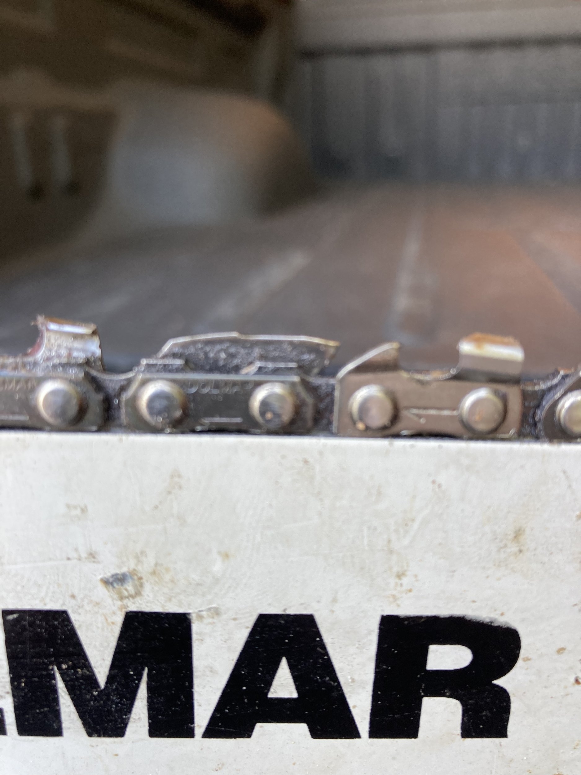

Here they are...
View attachment 822334View attachment 822335
In looking at these ( from two saws) magnified, I can see the anti-kickback things are just thin rakers the same height as the rakers. What do you think I should do?
I take the chain off of the saw when they come to the shop for sharpening. Bend the chain on each side of the safety link and run then across the bench grinder. And then treat the depth gauges as normal.

I went back and looked at the OP’s pics again. I don’t understand the purpose of the weird extra link? Almost like a skip chain? I assume it’s a antikick back feature.

I'm the OP and that's just the way saws came out of a local place that sold saws. I believe it to be anti-kickback. I used to cut a lot 30 years ago but it's not 30 years ago any more. There are almost no trees here and I'm older and rusty. I sharpened according the the clip from Billy I inserted in this thread and the saws cut perfect. I wear chaps, boots, Kevlar gloves and a helmet since I've seen saw cuts.
the extra weird link is a safety link to help prevent the cutters from contacting the wood when they go around the nose of the bar. When the chain goes around the bar nose the rear of that link will extend higher than the depth gauge.

grab the 4" angle grinder and get rid of that crap between the cutters!!! Thats the first thing I do when I run into one of these stupid design chains!
This is what I do.^^^ Then buy non-safety chain in the future.
