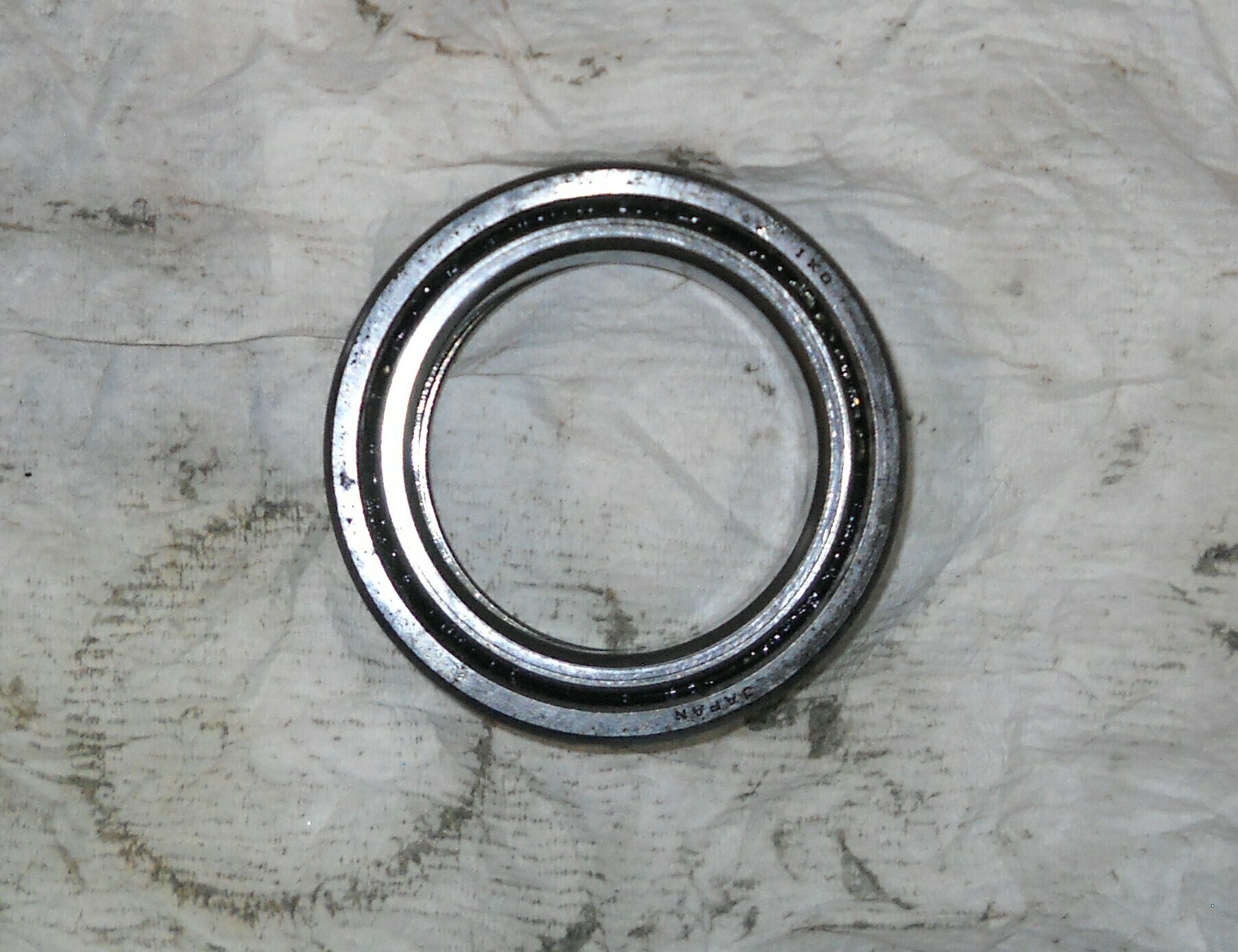

At this point, stuck on one bearing and one seal. Cannot find online or at local houses.
Bearing was completely destroyed, so pulled the other hub to see what was needed. It is a needle bearing with inner and outer sleeves, 40mmID x 58mmOD x 15mm. Only markings are "IKO Japan." No part number. Can't find any bearing those dimensions, other than a thrust bearing which won't work of course.

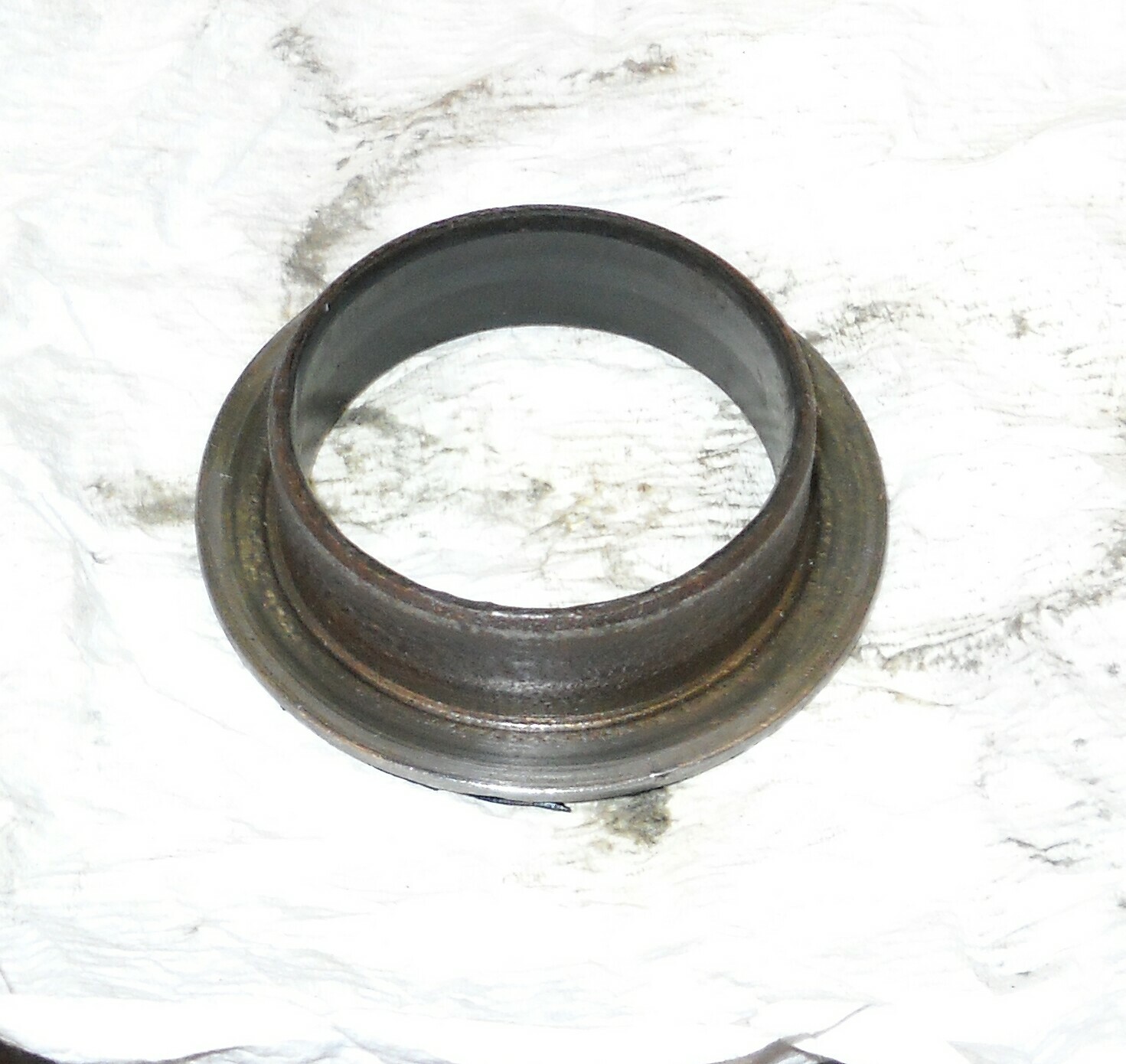

The oil seal has a part number on it - AQ2671E - which cannot find, but from the few cross reference charts I have found (all in foreign languages) I can deduce it as having dimensions 45mm x 68mm x 11/17. The ID and OD fit with what I can measure on old part. Don't know what the 11/17 means. It is a flanged seal of some sort. Metal with rubber on face of flange and along inner wall. As with the bearing, local supply houses not able to match.

It says IKO and Japan, does it have any numbers?
IKO makes a ton of needle bearings.
Question, do the needles fall out when the inner ring is removed? Cause it is possible you are searching under false measurements. With needle bearings, sometimes there is an inner race, sometimes not. So the bearing you have could have been sold as just the outer race + needles, and the flanged inner race is a separate part. That would change your ID measurement and thus change your search

Yes that occurred to me after I got home and started searching web again. I do know the inner race pulls out. As for needles falling out don't know but will call tomorrow and ask. Unfortunately I don't have the bearing here. No part number at all on the bearing (see photo), and of course they do make tons of bearings. Wonder why no part number.

On one of those foreign sites, the AQ2671E seal also appears to be the PTO seal on a JD 3350.

Interesting. A good reference. Can't seem to find a part number for a JD 3350 PTO seal so far from perusing a few sites, but a good lead nonetheless. Looks like the part is an 'oil seal sleeve.' That helps.

BEARING 40x57x24 NSK

Thanks. The very same bearing I had under consideration as my Plan B. In fact, after more extensive searching, I ordered one just like it last night. Not a needle roller. It is however a double-ring bearing and will bear considerable weight. Small tractor of course, so I am reasonably confident it will do the job. Thicker than the 15mm needle roller that's spec'ed, but it's a sealed bearing so I will leave one or both oil seals off and it should fit within a mm.
Oil seal remains an issue, but I have ordered one based on cross ref of the original number, and I think it fits on the flange of the metal part, which is basically a shaft sleeve (separate part). May be wrong, but will know when the seal arrives from Hong Kong. The fact I couldn't get one over here is probably a good sign it's what I need. We'll see.

D-1600 is fixed and back home. Hub bearings were easy enough to run down with the one exception previously noted. That one required improvisation. About decided Mitsubishi had the D-1600 hub housings cast, and then realized the OD for the shaft bearing into the transmission was an odd size, and had IKO custom make a needle roller bearing to fit. That would explain the absence of a part number on the bearing. At any rate, couldn't find one anywhere for any price. Ended up using a double ball bearing from VXB. Right ID and OD, but thicker. It's a sealed bearing, so left off the oil seal from one side and it fit nicely. Hopefully won't be an issue, as the oil levels in the hub and the transmission are below the level of the bearing. The double roller won't bear the weight of a needle roller, but hopefully that won't be an issue as it is there more to keep shaft centered than bear weight, and the tractor is small of course. Time will tell.

45MMX68MMX8MM TC Metal Spring Double Lip Oil Shaft Seal
40MMX58MMX8MM TC (omit one of two seals NEEDED IF using 40BD45DU sealed bearing to replace OEM needle roller)
