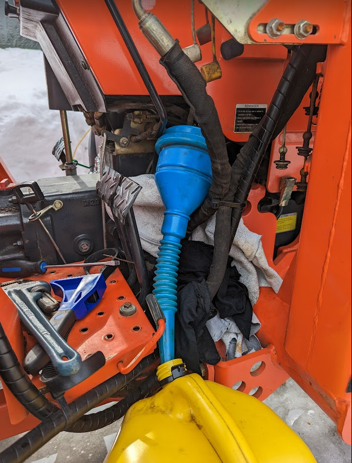

Ok, I added this small heater to the side of the tank and I've let it run for about 5 hours. That did the trick :) Diesel flowing was warm to the touch so I guess 5 hours was an overkill lol.
This is how I drained the diesel from the tank. At first, it was just water, then diesel started flowing. I emptied the whole tank, then added about a quart of fresh diesel that I also drained to make sure all water was gone.
I finished by checking the filter. There was no water in it. I emptied the bowl, cleaned it, put fresh diesel, screwed it back. Followed the bleeding instructions. Tractor is now ready for the next snow storm or spring cleaning :)
Thanks all for you help.
Oh yeah, using my Mr Funnel, I separated the water from the diesel. There was about 200-300 ml worth of water the tank. I'll let it settle down for a week and drain again one more time.
