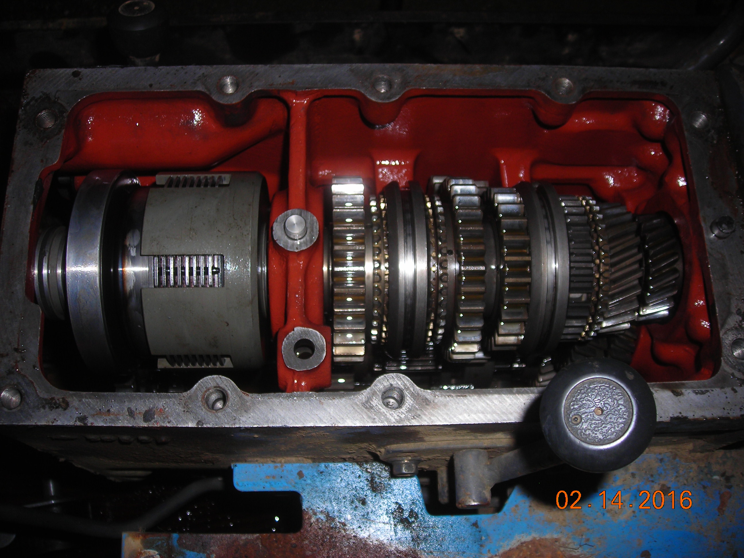

I have a Mitsubishi MT250D 4x4 tractor. Iwas using it and heard a clunk sound and it wouldn't move. I split the tractor to check the clutch and found the pressure plate fingers broken so I replaced the entire clutch assembly ie.. pressure plate, clutch disc, pilot bearing and throwout bearing including having a new hub machined that holds the throwout bearing. I put the tractor back together and the clutch works as it should, I can shift gears and the PTO shifts as it should and the output of the PTO spins as it should.
My problem is that when I put the tractor in any gear and let the clutch out the tractor won't move, no matter what gear. I thwen split the tractor again to see if any splines or shafts were stripped or broken and all seem in good shape. I have taken the cover off the tranny to see if there is any damage and all looks good, no metal or shavings in the fluid either..
Since I have it split between the rear end and the tranny, I can manually put the tranny in any gear, when I spin the shaft by hand it won't spin ( as would be expected ) When I spin the shaft to the rear end, one wheel tries to roll, when I block that wheel, the opposite wheel tries to spin ( appears the rear end is working )
I am really hoping someone can tell me what might be wrong or what I should check next. If the tractor is low on fluid, would this cause the tractor not to move? Thank you in advance for helping.

I am totally unfamiliar with your transmission, but to me it seems that it may a shift fork problem causing you to actually be in two gears at once.

I agree with bcp.
Your transmission is in two gears at the same time.
Take the cover off and try to get all gears into the neutral position. In this position all the shift forks should be lined up.
Take a picture if you can

I do have a pic of the tranny with the top of the case off. I attached it. Hope it helps tractor 008.JPG

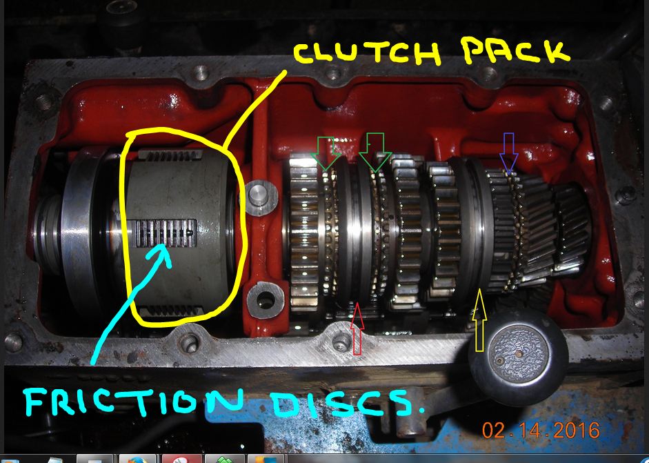

I have marked up your photo with some colored arrows to help me explain what I see,
The red arrow and the yellow arrow point to synchronizers which slide to either side to engage a gear.
The two green arrows show the possible gear positions for the red arrow synchro.
In this case the synchro is in the middle and not selecting a gear.
The yellow arrow synchro only has one blue arrow because the synchro ring is slid to the left engaging a gear.
Try sliding this one to the center position.
I cannot see the lower part of the gears so I am assuming you are in reverse plus one forward gear.
I hope this will give you n idea of what to look for.
Can you post a photo of the inside of the cover?

To me it looks like the collar on the right is fully engaged with the gear to its left.
The collar on the left looks partially engaged with the synchro to its left, enough to be grabbing that gear. I'd say try to re-center the collar on the left and see what happens. May want to run through all the gears to make sure the forks behave and let you get in and out of all gears. Looks like a 4-speed, or maybe 3 with reverse I can't see??
/ Need help fixing my tractor #7
Edit: what Dave calls synchros I call collars. To me, the synchros are the toothy-rings to each side of the collar, between the collar and the true gear.

I see a clutch pack on the mainshaft , I'll bet that is where the trouble is . Either the friction discs are shot or the splines are torn out . That Blue heat mark should not be there either .

Hello , I didn't mean the clutch you just replaced , I was referring to the INTERNAL clutch pack that is part of the mainshaft (circled in yellow) It may have an issue , but going on the picture , the friction discs look fine . The blue heat mark behind the clutch pack is a worry though . That blue mark indicates heat and more than likely from slipping clutches .
Your original problem would not have been caused by broken pressure plate fingers . They would cause the clutch to NOT disengage rather than stopping the tractor driving .
I think your original issue was the INTERNAL clutch pack slipping , either because of mechanical damage or the oil pressure pump not supplying pressure to it(depending on if it pressure applied or pressure released , or both) . I wonder if the "clunk" you heard was a pump shaft drive key breaking or something similar ? I think when you found the broken pressure plate fingers , you prevented a different problem taking place in the future

I've worked on mechanically actuated clutches like that in machine tools, and that clutch looks fine to me. As far as the blueing goes, it could be from a heat treating process and be normal, or possibly be from friction from some failure in the actuating part of the clutch. Is this hydraulically actuated? If so you may be able to check its operation with compressed air. I would be looking at that part of the clutch closely.
