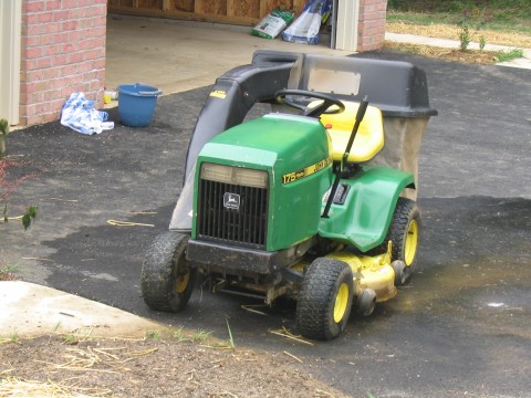

Well, I got it running, It was the ign trigger, 55 bucks from JD.
Thanks again I wish I could figure out how to post a pic on here.

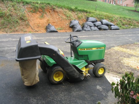

I figured it out check out the tractor.I have ~260 bucks in it.
