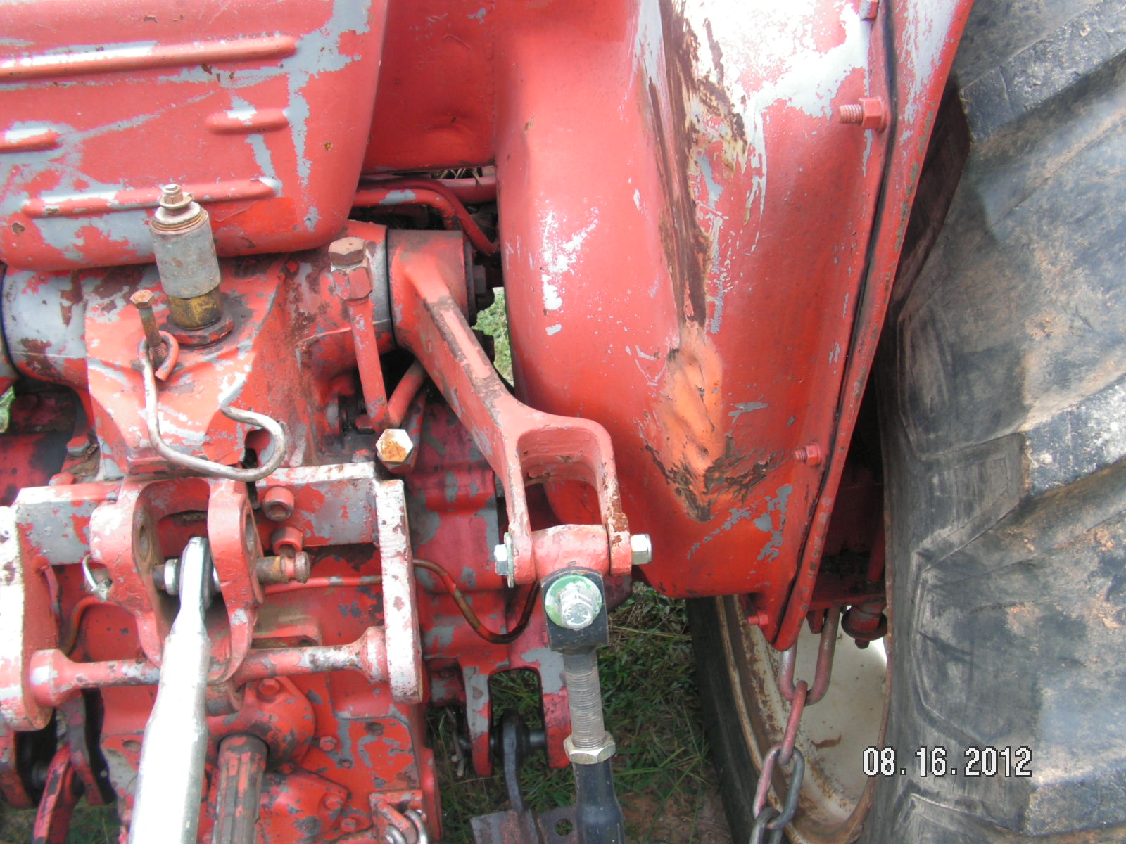

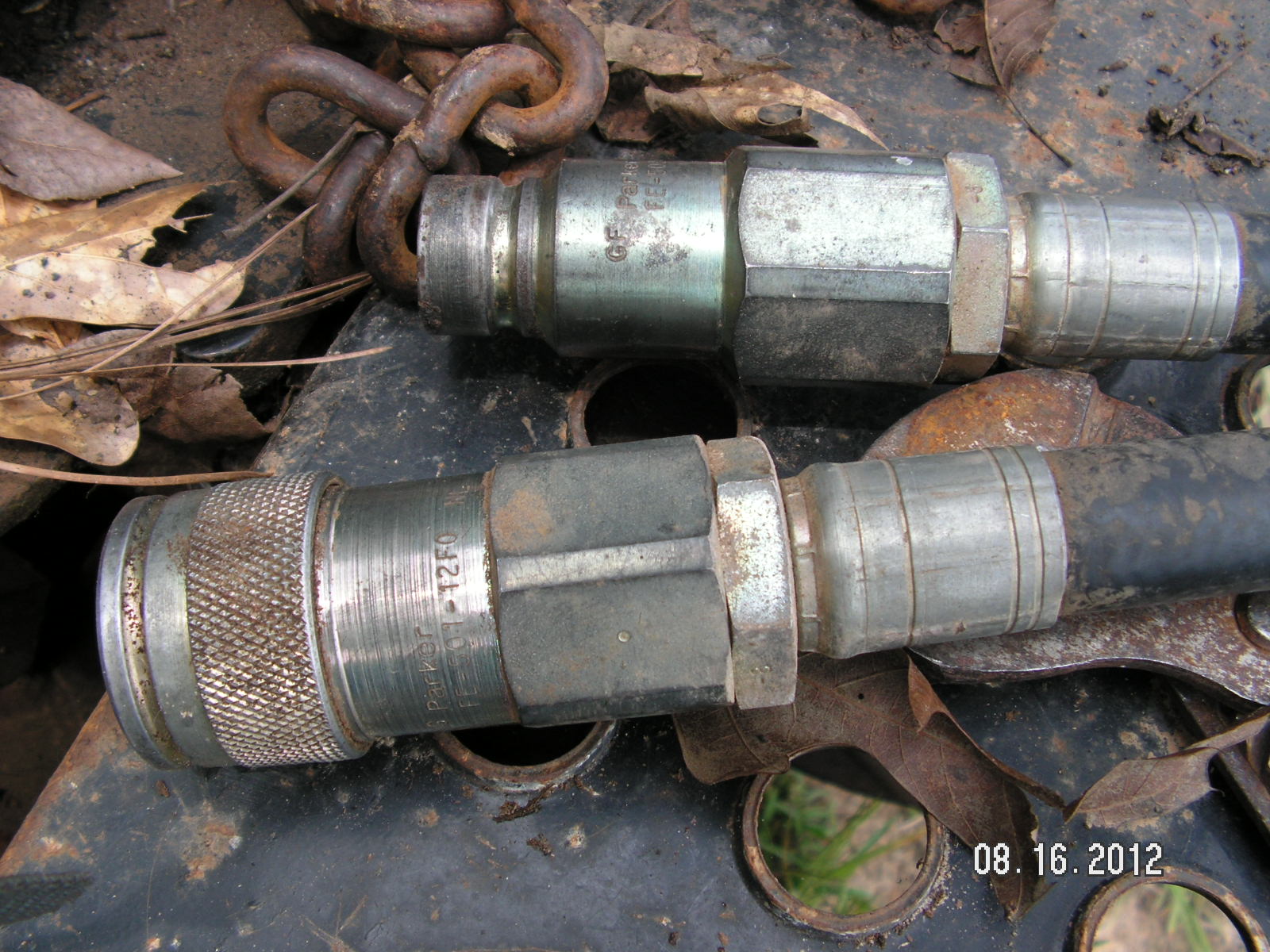

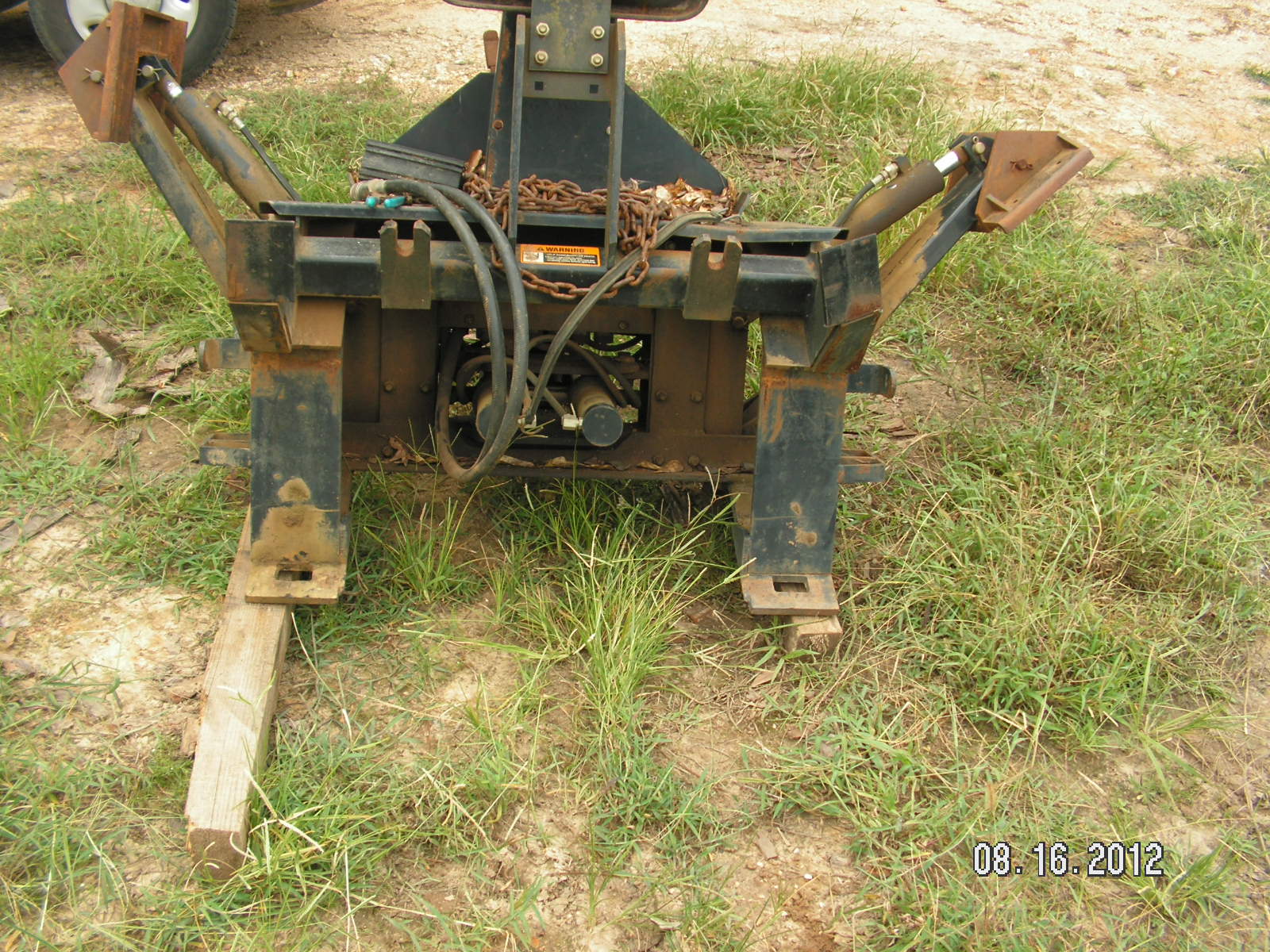

I am going to try and post pictures of both. The two capped hoses on the tractor go to some sort of box beside the controls for the three point hitch,etc but I can't see any kind of lever,etc to turn them on or off. I can build any type of furniture, build my own sawmill, etc but when it comes to hydraulics, I'm lost. Thanks so much for you help.

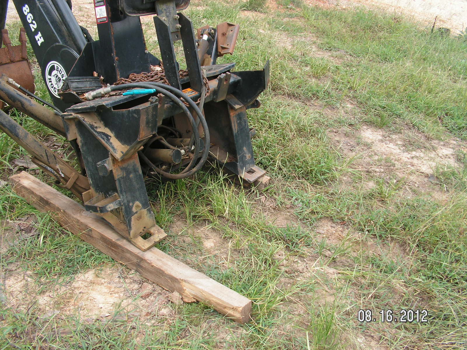

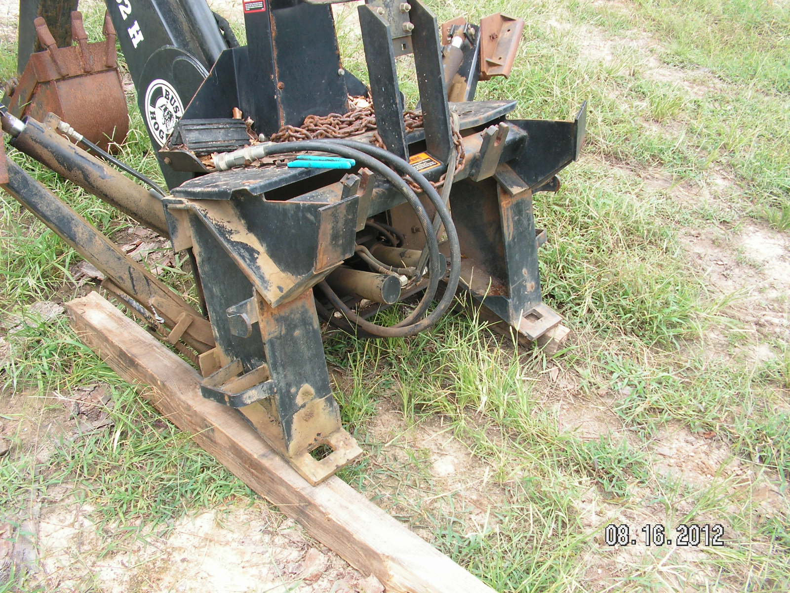

   / Need help hooking up backhoe attachment
J_J
I'm not sure if I replied to your message or if I just added another reply. Anyway, I posted some pictures and any advice you can give me is greatly appreciated.

The simple way to connect the BH is this, since your BH is a two hose BH, you need one pressure line going to the BH IN hose, and then run the other BH hose to the tractor fill cap.

J.J. is on the right track. I cant help but think that there is a lever next to the right fender (next to the 3 point lever?) to operate a rear remote. the only thing here is that someone caped off the lines instead of installing a pair of quick couplers. Do you have a lever/valve that doesnt seem to do anything? if so, then my money says that lever runs the rear remote. Its not very likely that your tractor has a closed center hydraulics.
Keep us posted on what you find.

Thank you guys so much!!!!!!!!! I took a cover off and looked where Steve was talking about and found a thing under there (don't know what you call it) that was supposed to have a lever, but there was just a nail in it. Where its located looks like your foot would hit it a lot and I know the guy that had it the last 10 years or so never used anything with hydraulics, so I figure it either broke or they took it off.

Once I get the caps off tomorrow, I will go to Tractor Supply and try and figure out what connections I need to put on the tractor to hook to the backhoe and I will let you guys know if it works. I need the hydraulics to work before a build something to mount it to.
