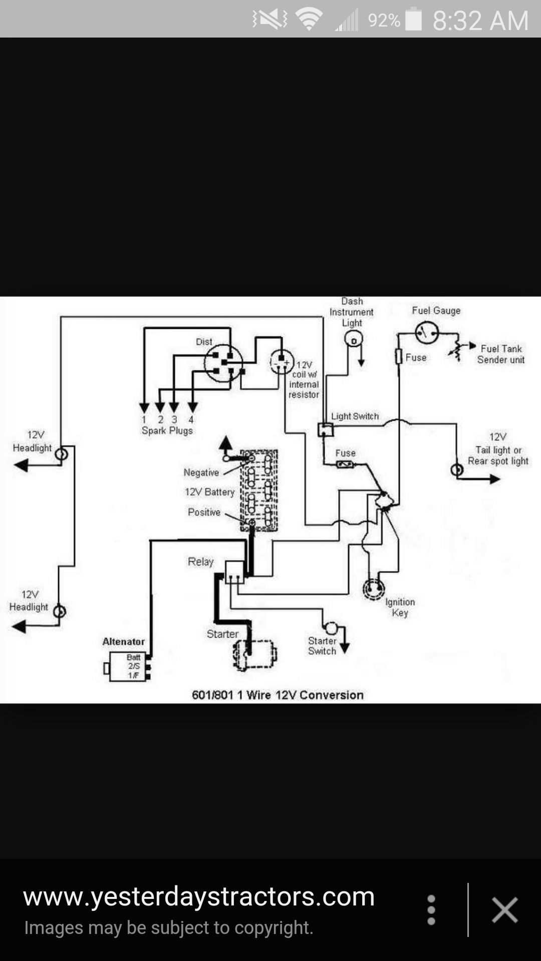

I found a manual for the later models, I'll keep looking for mine. In the meantime I found what I think should be very close to a good schematic. I'm going to just go through and run all new wires, it's a mess lol. I attached a screenshot of the schematic, if it looks way wrong let me know.

I can't help on the schematic, but here's a link to a reprint of the factory shop and parts manuals for your tractor. The shop manual is reasonable at $50, but the parts manual is a bit pricey at $115. I think both are worth it, but it might be worth looking for a digital copy...usually those are like $25 and you can print only the pages you need to (if any).
