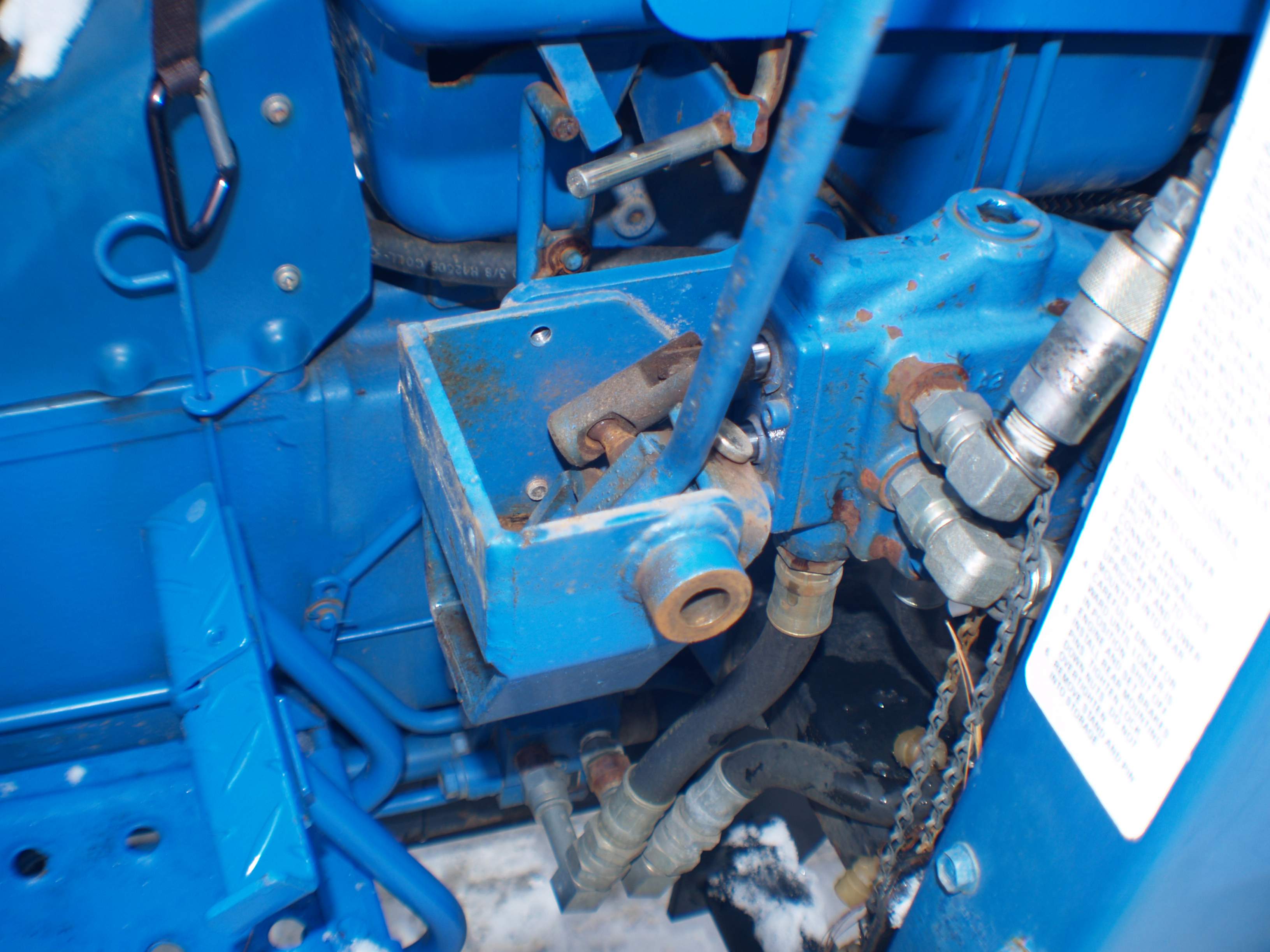

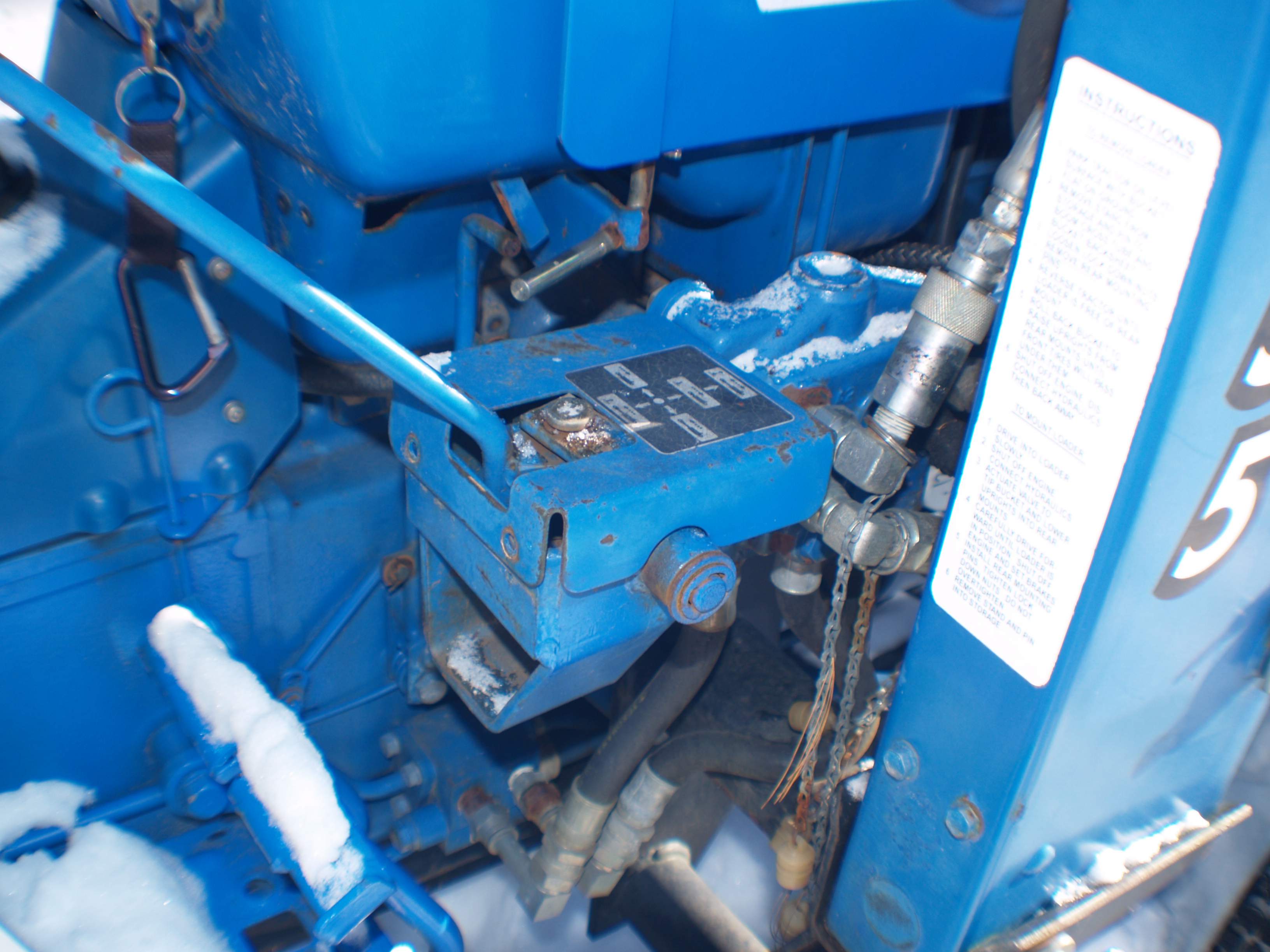

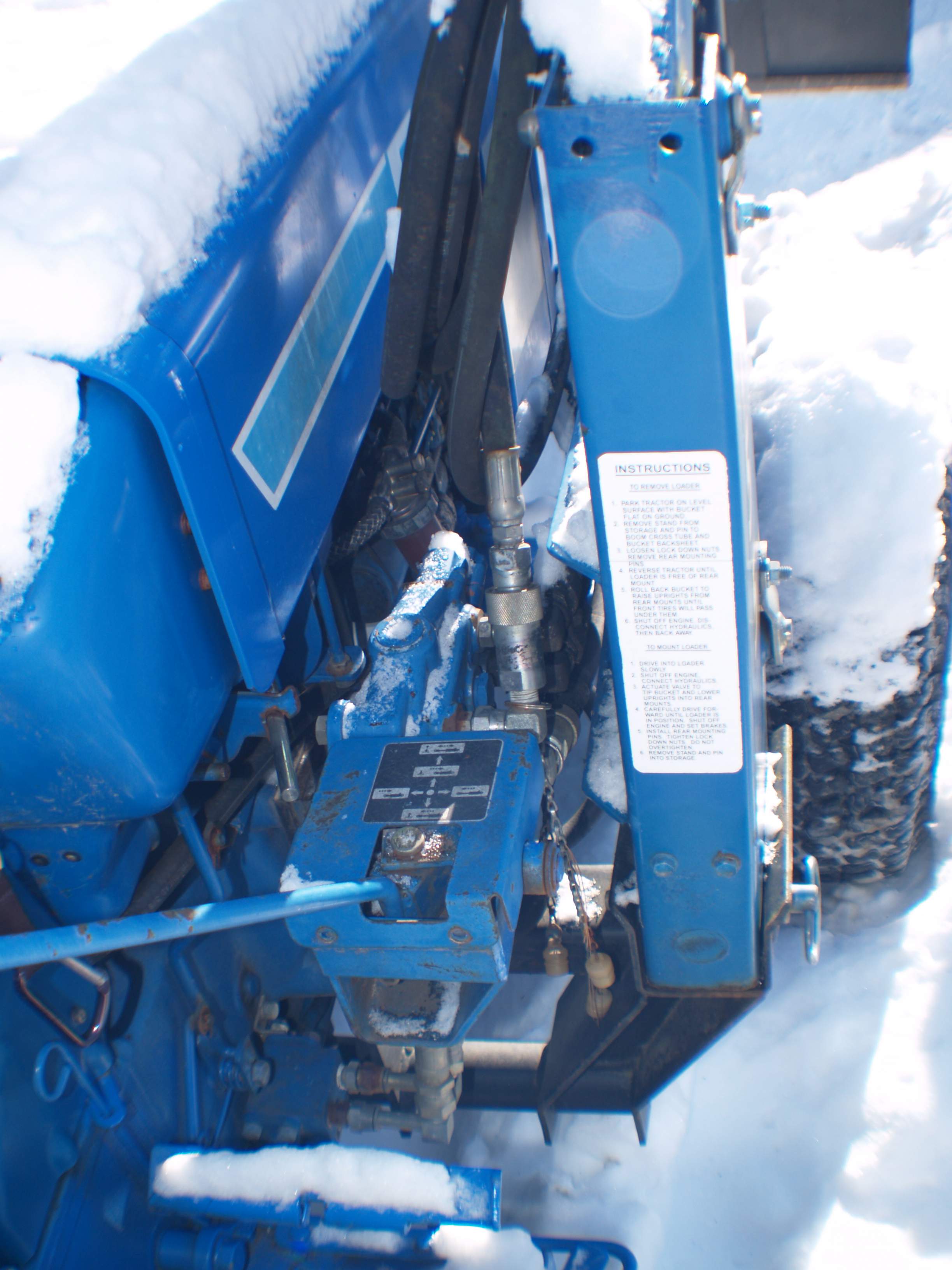

Hi,
I need to replace the lever assembly, but can't identify the vendor, etc.
It's mounted on a Ford 1310 tractor, with a Woods Dual 155 loader.
Any ideas who made this?
Thanks, John

Why wouldn't it be a Woods valve? Find any ID numbers on it, maybe under that tin cover?

Take the top panel off, any info is going to be on the valve itself. Considering its a woods loader, they should be able to help you considering you can use the model to determine the year and kinda reference that to what they were using then. If you can't find anything then you should probably look into a new valve or something jerry rigged.

Hi Jim,
I sent the pictures to Woods, it's not theirs.

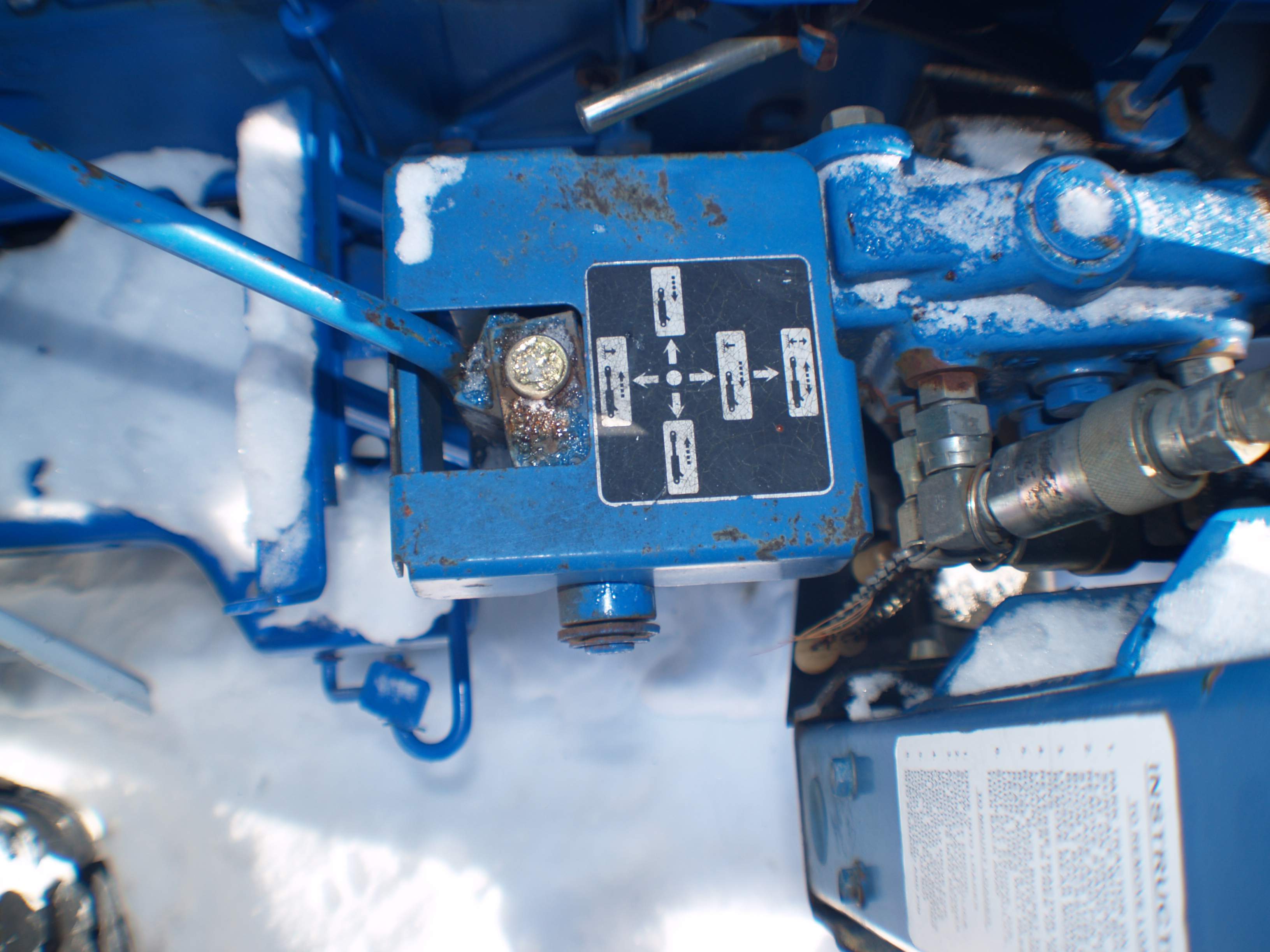

Pull the cover off and see if it says the manufacture, Cross, Parker, Greeson, etc are common valves.

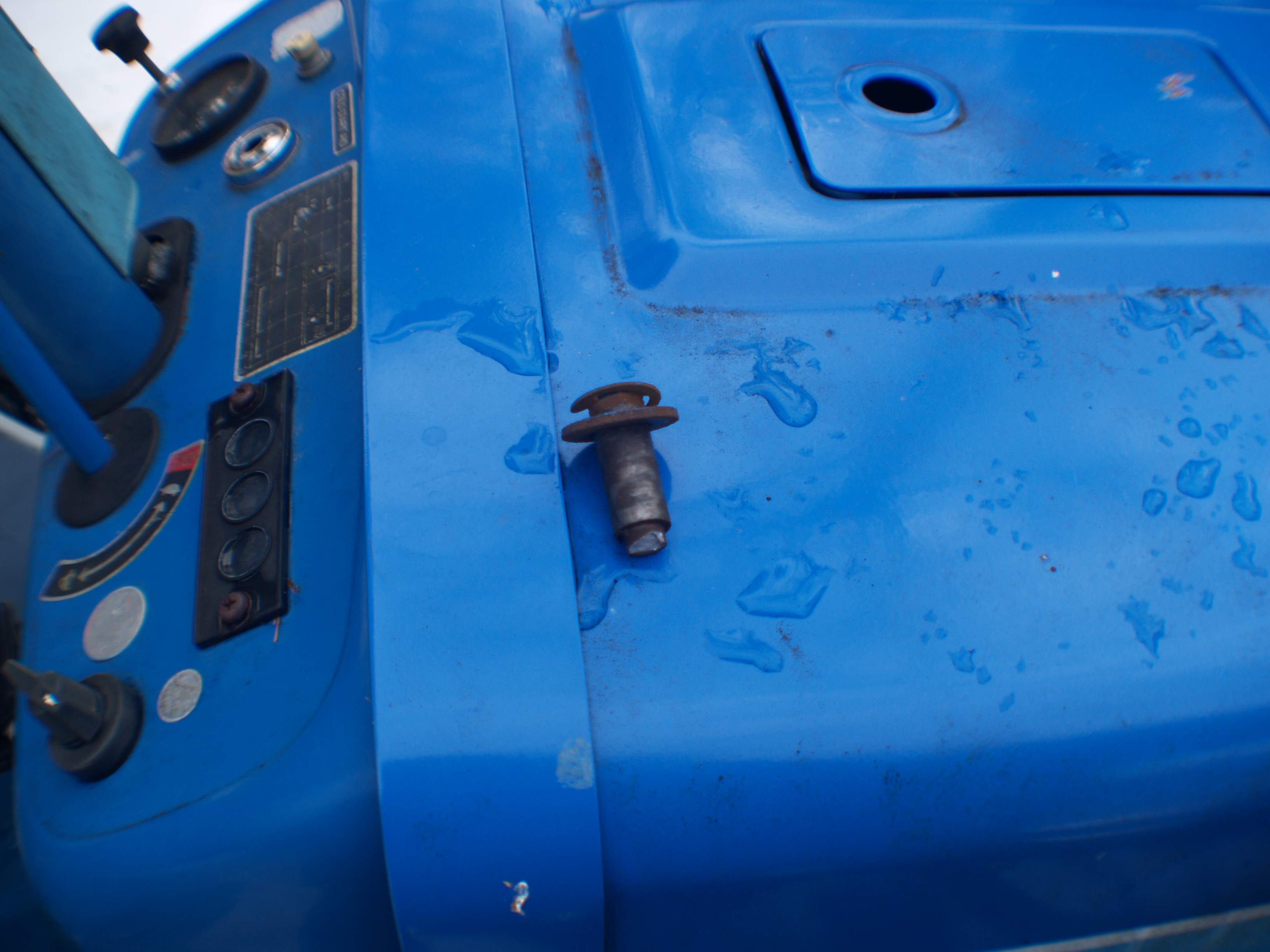

What is the problem with it?

Hi,
The shaft on which the lever is mounted, gave up!
John

That looks like a pretty simple part. Can you make a sketch of it with dimensions? It might not take much to have one made.

That 2 spool valve is an OEM accessory to your Ford 1310. Parts are listed in the 1310 catalog and what parts can still be found new can be ordered by your New Holland dealer either directly from New Holland or resellers of NOS OEM parts such as Vintage/DPNI or Parts Depot. Vintage/DPNI and Parts Depot will require you to purchase through a New Holand dealer.
   / Need help identifying Lever and Valve combo
My 1310-1510-1710 Repair Manual does not show any accessories, unfortunately, just the basic tractor. Although one picture leads me to believe that it may have been originally a two lever setup. I'll have a look at the WEB sites you suggested.
The part is simple enough, I may take it to a local machinist and have him turn a replacement, maybe two. Removing the piece which is broken off in the lever assembly will take more work, but no insurmountable. Looking at the broken surface, it has been cracked ~1/3 way through for a long time, there is rust and dirt.
