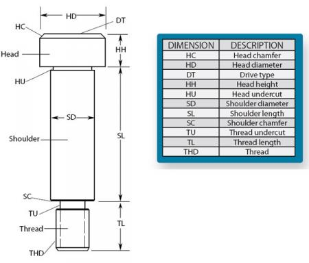

hello @aczlan
Thank you!!
So can you or someone else explain which is the unthreaded shoulder?
Maybe this image below helps?
Thank you

HU and TU is designed to shear (undercut). The shoulder center of the bold remains in place when either end shears. The threads are just to hold the bolt tight with the use of the nut. They are not part of the shearing mechanism.
Shear bolts are designed with specific lengths in mind. I would think twice before substituting regular bolts that are not designed to shear, even of the same grade. - But then we all take shortcuts, and sometimes it works, or doesn't.
Research slip clutches - might consider working one of those in, more costly than just a shear bolt.

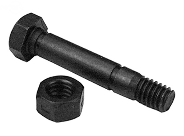

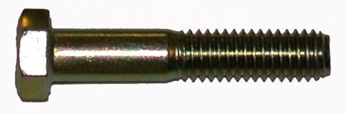

This bolt has an un-threaded shoulder and the a threaded portion for the nut. 003700.jpg
This is a shear bolt with the undercuts in the unthreaded shoulder for shearing. 5575.jpg
