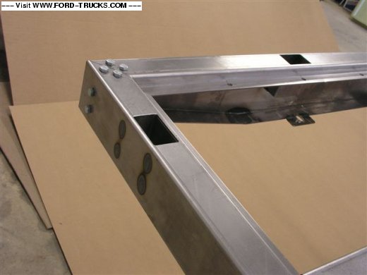

Big Barn--I thought about the rub rail down the length but it isn't historically true to the 1967 truck I have. Not that it needs to be but stake pockets in a flat metal floor would look better I think. What do you think? Take a look.
Here's an example off the net--but with a wood floor.

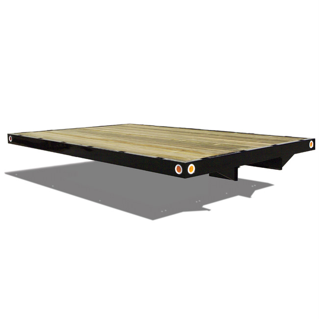

I've also discover what appears to be pre-made sides for building truck beds. Look at the photo below and it sure looks commercially made. That would make life easier?
Thoughts?

I like the way you think. I'd go with the "historically correct". When we bought our F600 new in 1960 we built our deck with the enclosed stake pockets similar to your second photo.
We used 3/16" 3"x4" (I THINK) angle iron for the outer perimeter. The stake pockets weren't available commercially that we were aware of so we had them preformed to accept rectangular (steel)square tube.
As far as premade goes I suppose it would depend upon cost.
Terry
