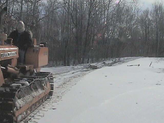

All good advise from others. I bought a JD350 dozer backhoe because I was tired of getting wheeled things stuck in mud. Would not clear forests with it but is an excellent trail making machine. Landscape around house etc. Weight is 10K lbs can be trailered behing a 1 ton dually. If you get a portable one work requests from friends relatives etc. will pile up /forums/images/graemlins/grin.gif
