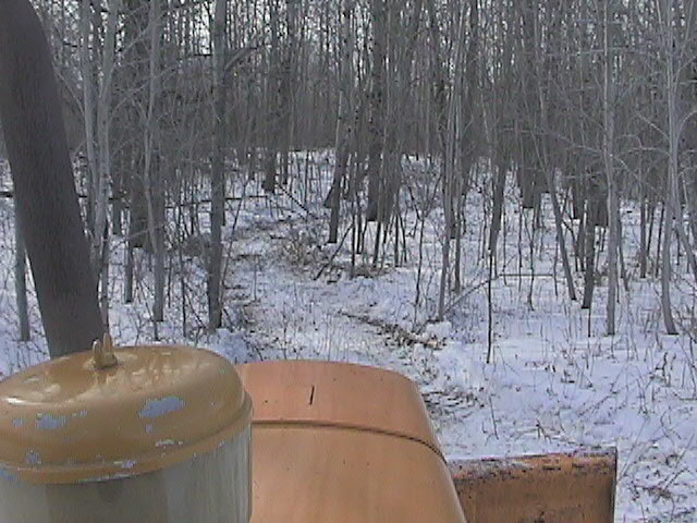

   / Need help on dozer pick. #27
My JD350 dozer oil filter costs $3.11 same one as my ag tractor. Crankcase takes 2 gals + 1 Qt of 15W40. Fuel filters are $3.49 ea. takes 2.
My only major maintenance expense over 3 years was rebuilding the injector pump for $500.
Something major may break but then again it may not /forums/images/graemlins/grin.gif
A dozer is still the best machine to build a trail

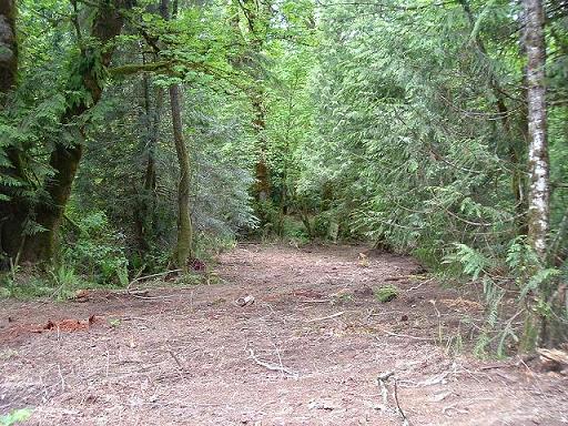

   / Need help on dozer pick. #29
"As to maintence being cheap our operator broke a hydraulic cylinder on the tilt yesterday. It cost him $2600 just for parts. The operator told me they put in a new transmission in their D7 and it cost 40k."
If you have time to be creative there is no reason a tiny little tilt cylinder on a small dozer should cost a tenth of 2600$, then on a 200,000$ tractor a major component like a tranny will likely cost 40k$ but on a 10,000$ tractor it won't. That operator sounded like a commercial operator where time is money and the quickest way to get it running was the msot expensive.
A big trackhoe is a fantastic tool but for pioneering a cat road/trail/property line a dozer is so dang convenient.

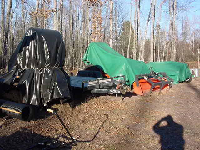

   / Need help on dozer pick. #30
Spark - I've got a 1962 AC H-3 crawler with dozer blade and winch and it has been a fun working machine. I never looked at it from a cost/benefit ratio, as I just plain wanted a smaller crawler. Have built several woods roads, driveways and a small dam. Use the winch for skidding tree length out of wet areas and on steep slopes. Had to put in new steering clutches, starter, fuel pump, etc., but assumed up front that repairs would be required. Mine runs around 9.000 # and had a trailer made, with surge brakes. Pull it with my 2500HD PU (slow and cautious). Get the owner operating book and repair manuals and have fun. The older crawlers are fully depreciated. As mentioned several times, they can be high maintenance, but that just goes with the territory. Go for it.
penokee /forums/images/graemlins/smile.gif
Ps: Only pic I have is with a black tarp on it - can see size relative to kubota L3130 under green tarp. Putting in a culvert in a few weeks, so will take a few pics at that time
