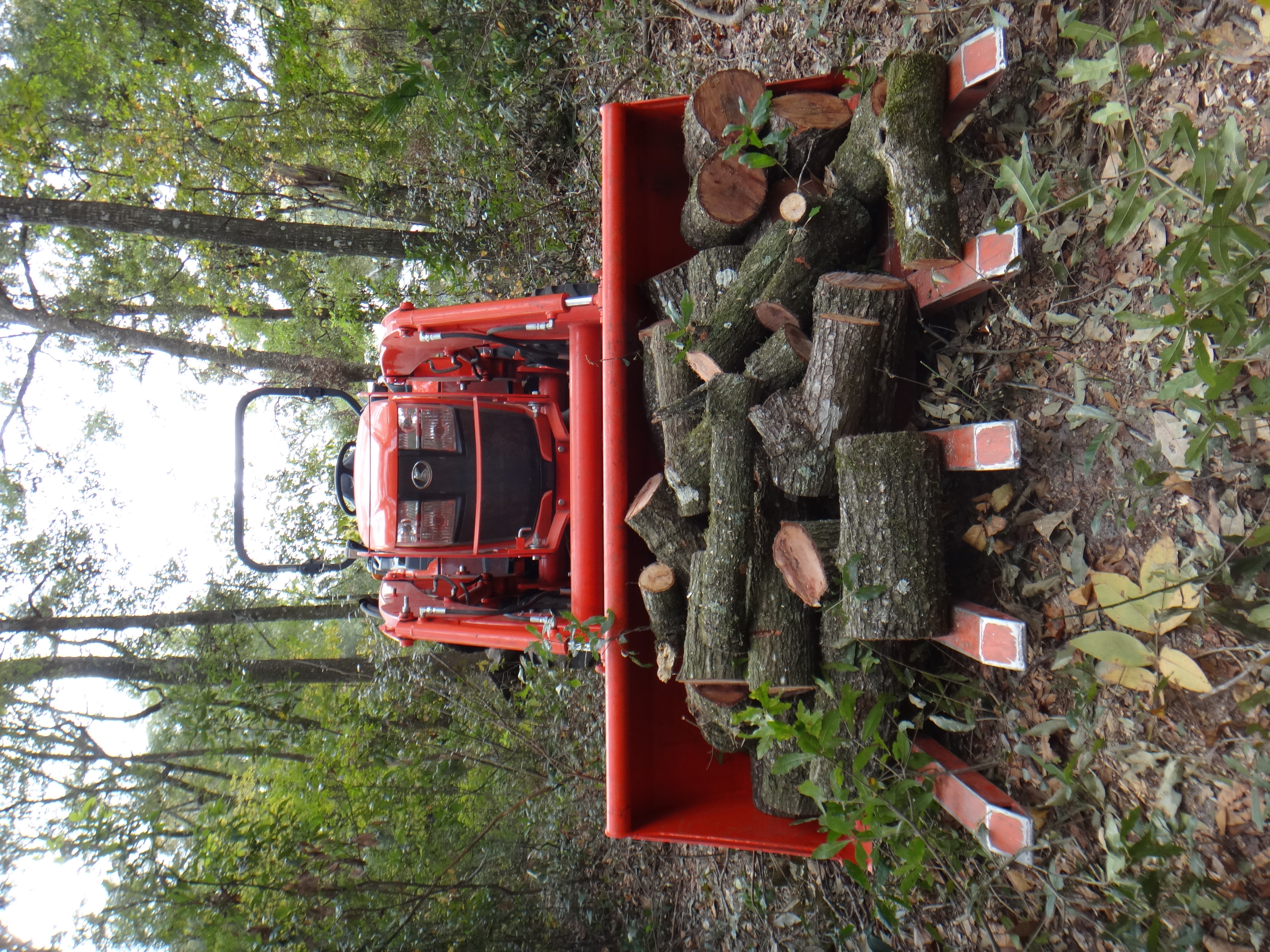

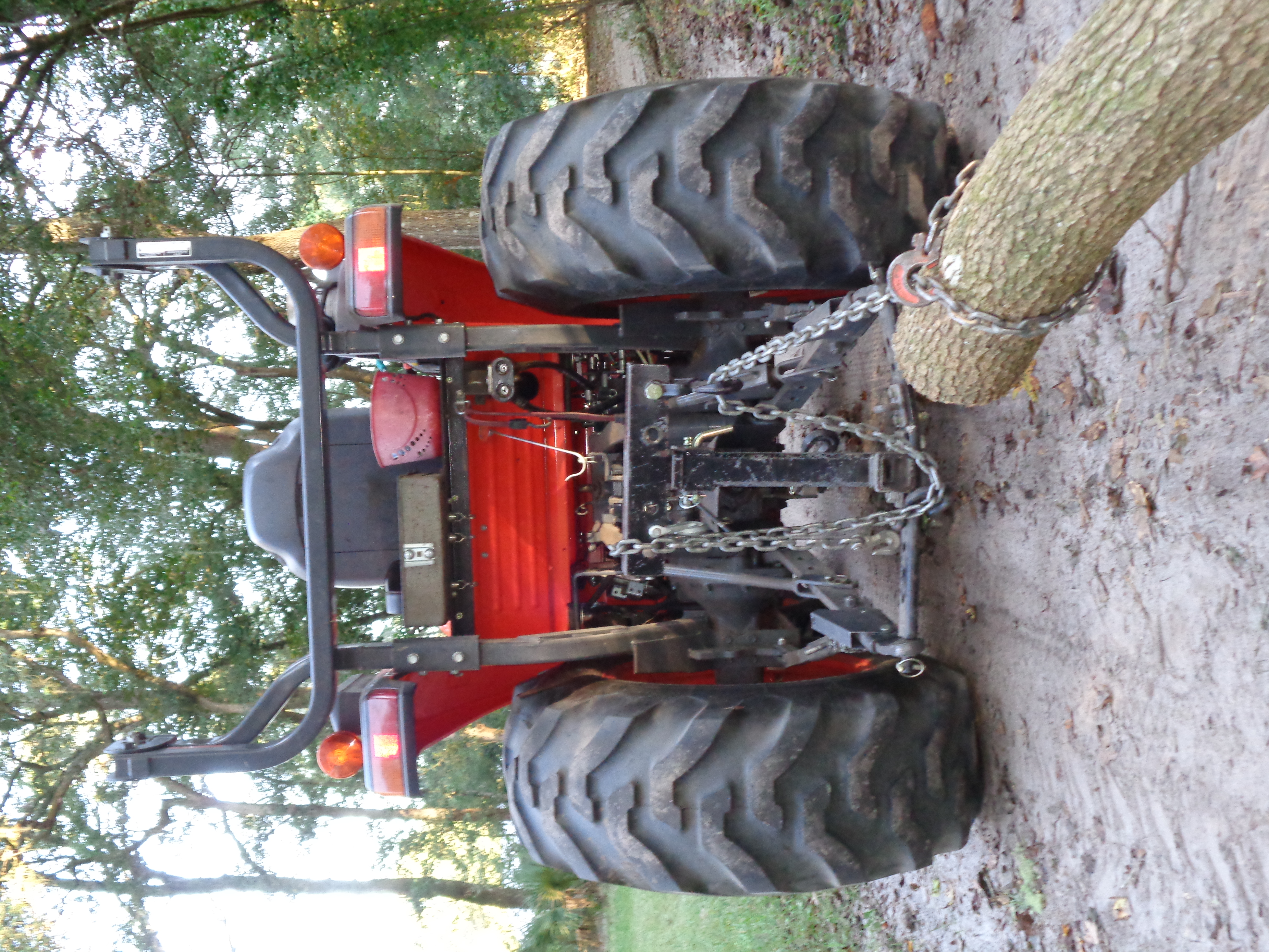

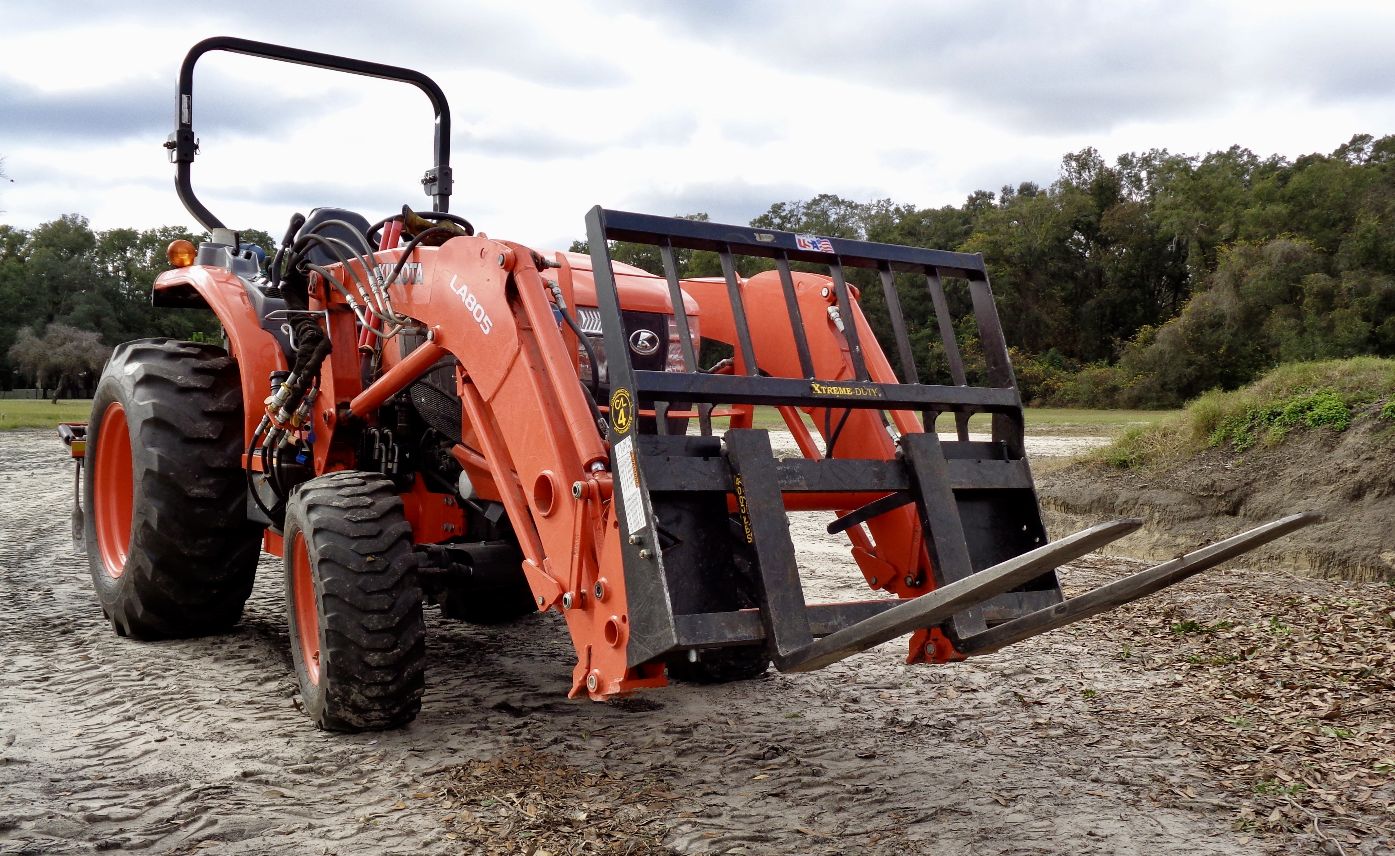

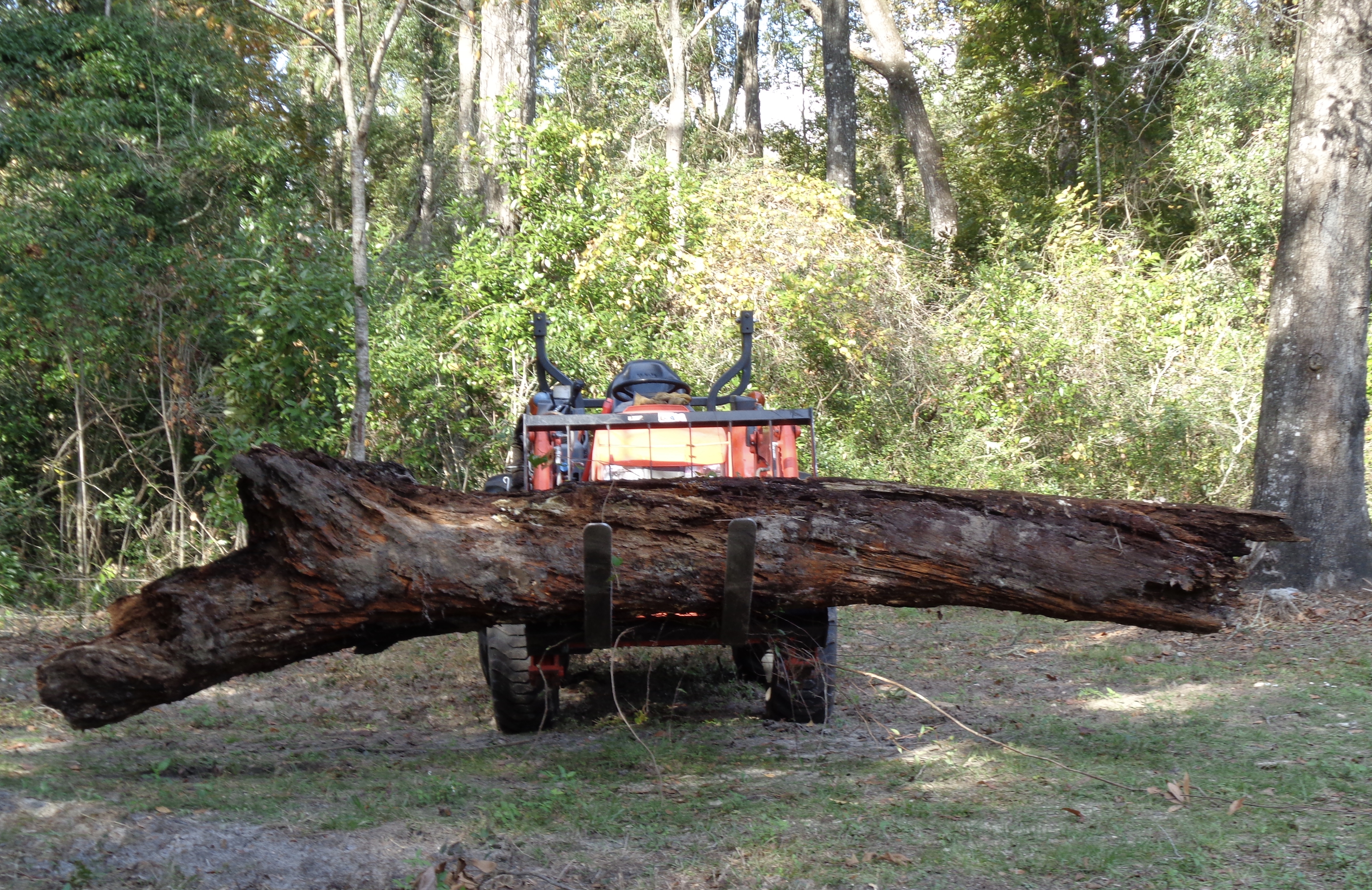

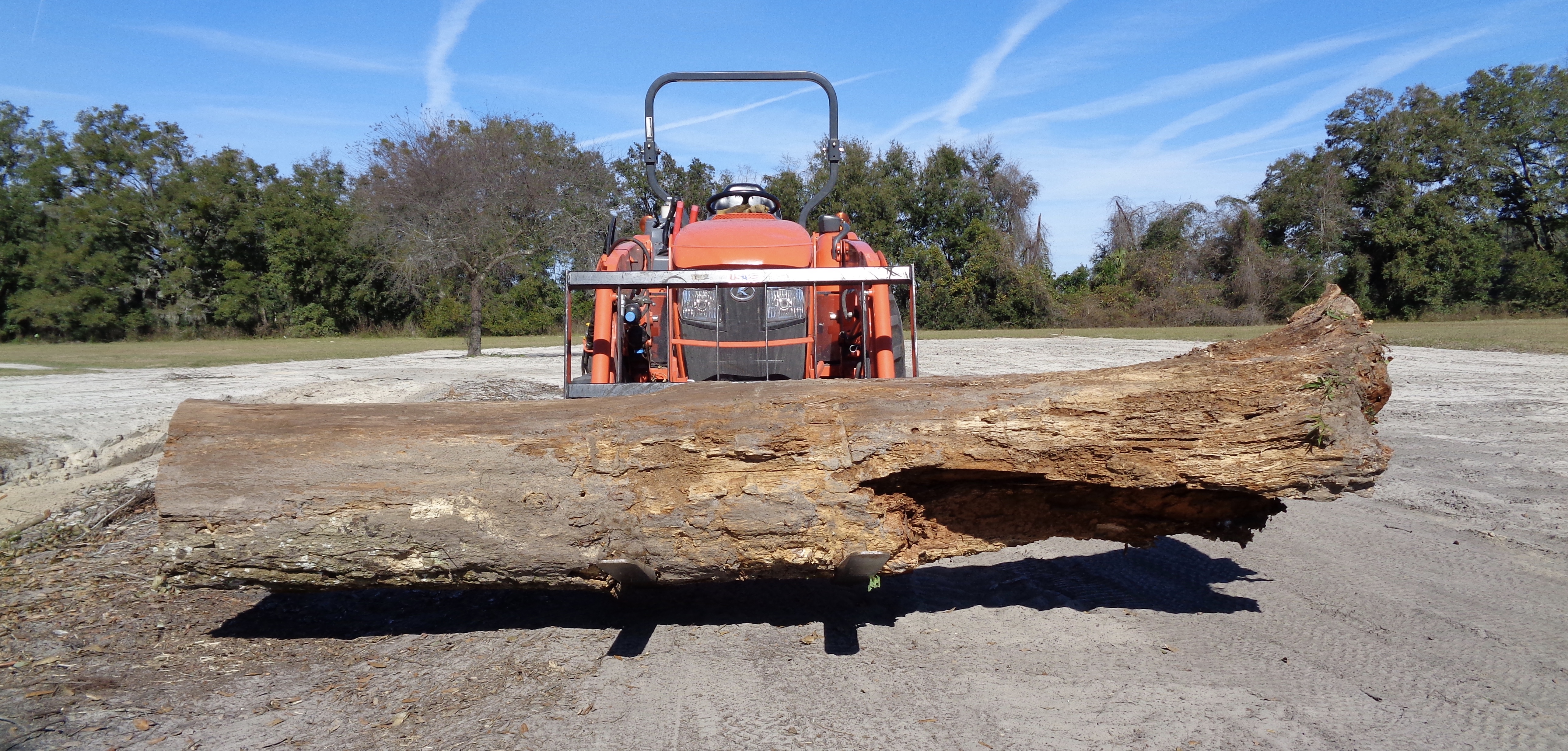

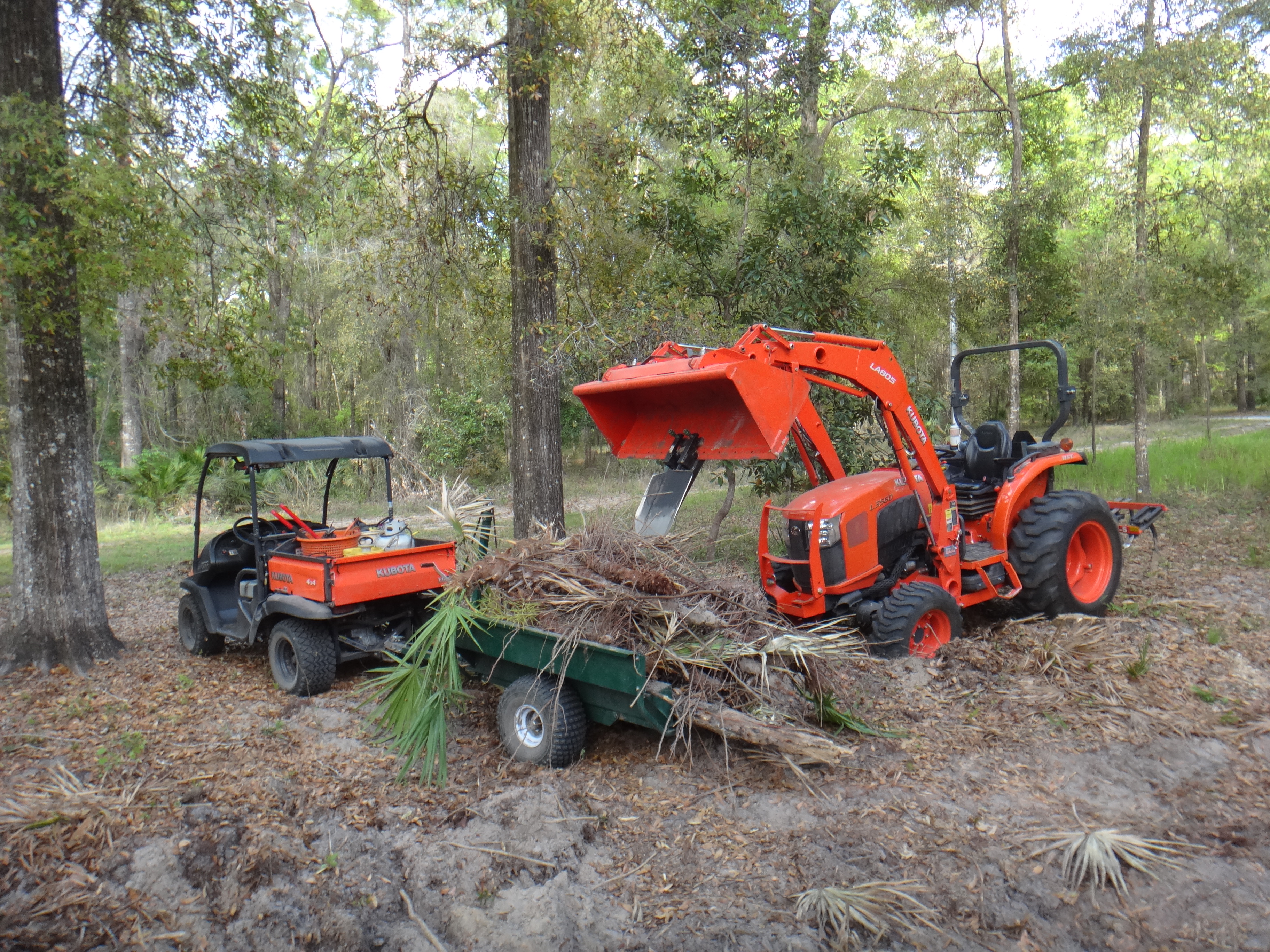

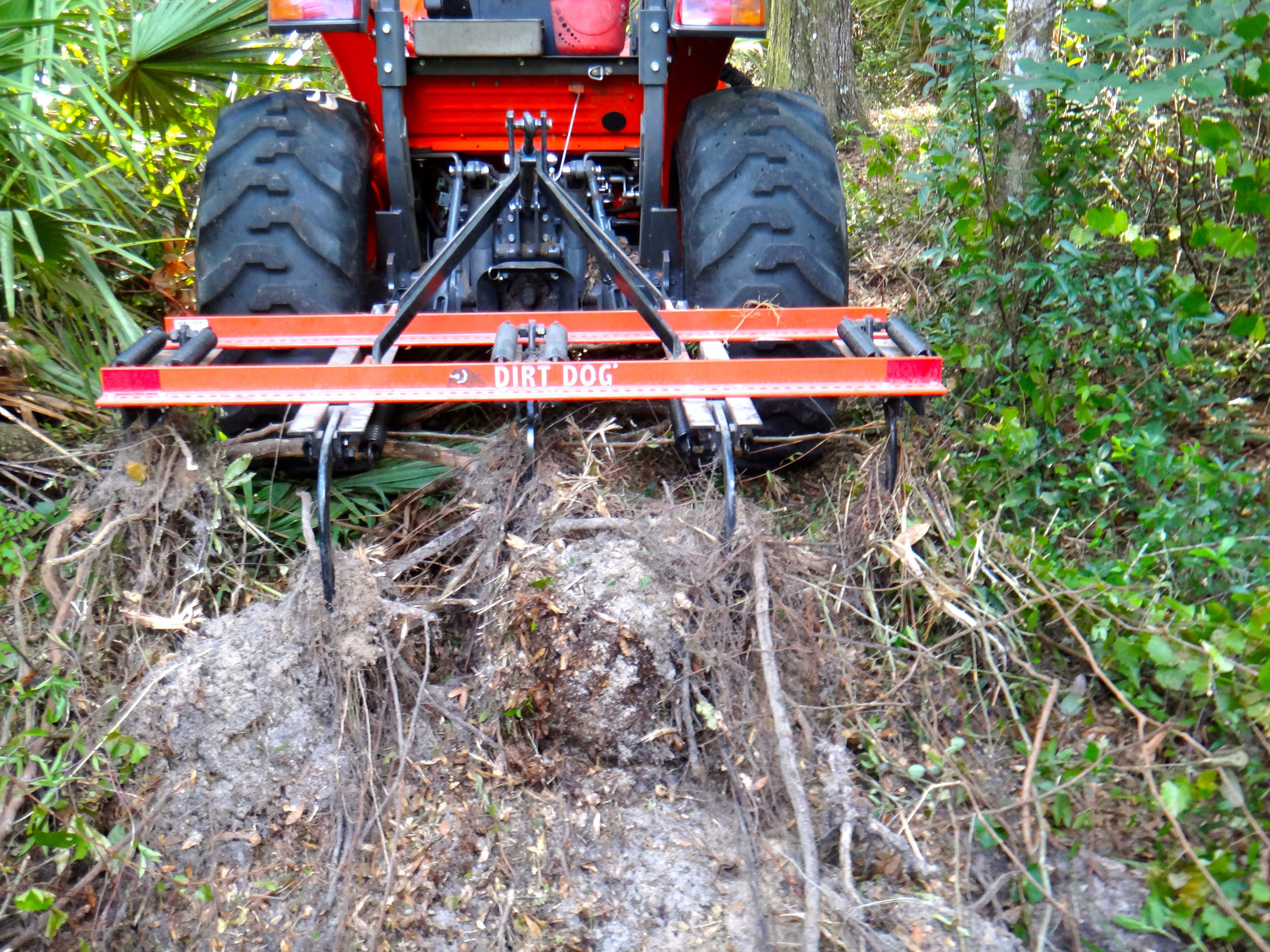

The fundamental importance of TRACTOR WEIGHT eludes many tractor shoppers. Heavier tractor weight is more important for most tractor applications than increased tractor horsepower. Bare tractor weight is a tractor specification easily found in sales brochures and web sites, readily comparable across tractor brands and tractor models, new and used.
Shop your weight range within tractor brands. Budget will eliminate some choices. Collect a dealer brochure for each tractor model in your weight range. I spreadsheet tractor and implement specs, often a revealing exercise. I have a column for cost per pound.
Most tractors under 3,000 pounds bare weight operate in residential or hobby farm applications on one to ten flat acres.
Selling a used tractor is easy. Selling multiple light implements in order to buy heavier, wider implements for a new, heavier tractor requires a lot of time. Depreciation on implements is generally greater than depreciation on a tractor.
Heavier tractors are constructed on larger frames and longer wheelbases. Heavier tractors are built with thicker steel to withstand greater stress. Heavier tractors have larger diameter wheels/tires, increasing ground clearance. Heavier tractors with large diameter wheels/tires have more tractive power pulling ground contact implements, pushing a loader bucket into dirt and pushing snow. Larger wheels and tires permit heavier tractors to bridge holes, ruts and tree debris with less operator perturbation.
