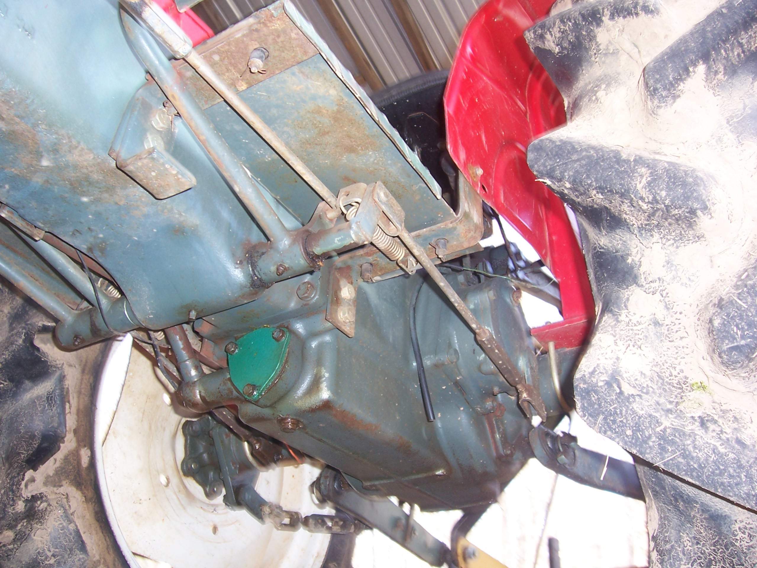

Thanks for the info. I took some pics. On my 240D the pic looks the same as Carey's . How do you clean the screen ? Does the screen act as a filter ? I think I have my 240D figured out. My red 220D , I'm not too sure of. I seen a filter and wasn't sure if it's the filter for the hydraulics. I'll post some pics and if anyone wants to chime in please do ;)

DOES THIS COVER HAVE TO COME OFF TO REMOVE OIL FILTER ? :
IS THIS THE HYDRAULIC FILTER ? :
IS THIS THE BOLT TO DRAIN THE HYDRAULIC ? PIC 1 :
OR IS THIS THE BOLT , JUST BELOW IT ? PIC 2 :
/ Need Help Please #5
Good thats it on the 240. I thought it was the same. Use JD 303 my notes says 16qts. that sounds about right the best I can remember,15-40 eng.oil 4-5 qts. I used parts cleaner on the old screen and hit it with the air, seemed to work fine kept it anyway. It was in pretty bad shape so I replaced it.Better safe than sorry IMO.

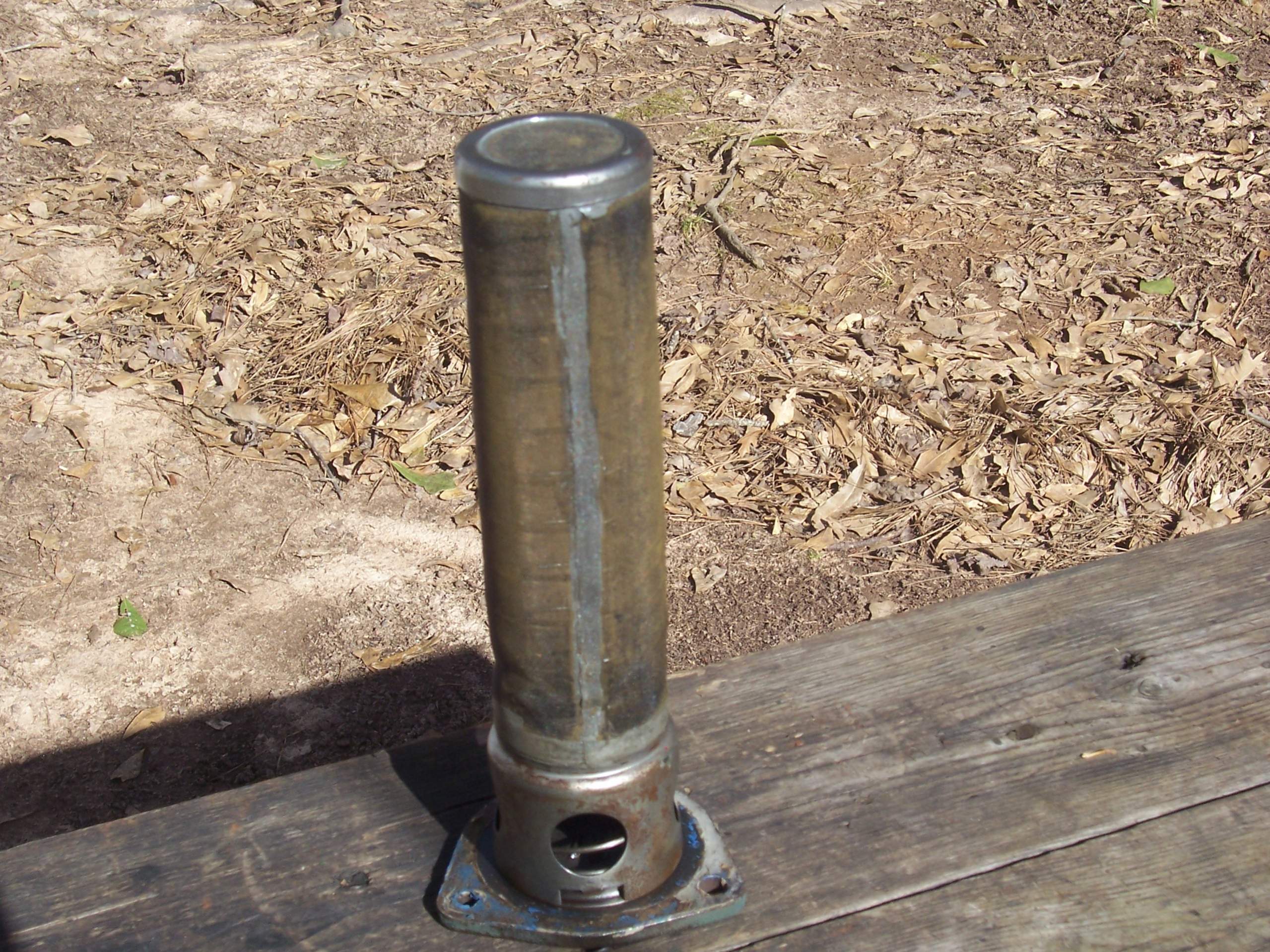

looks like water had contaminated the fluid. the screen looks brand new again.
/ Need Help Please #8
Is that much grit normal on the hydraulic filter? I would be really uncomfortable knowing that much stuff was getting into my hydraulic oil. I've never seen a screen pulled out before, but it looks excessive. Someone with more experience than me want to comment?
/ Need Help Please #9
Yes. Mine was as bad if not worse when I bought it and pulled all the maint. on it. And I don't have a FEL or BH. :eek:

Here you go .Here is just how bad it was. This is cleaned as best I could get it. Notice the forma gasket still on it and what looks to be were they tried to repair the screen. I new it was best for me to replace it. :rolleyes:

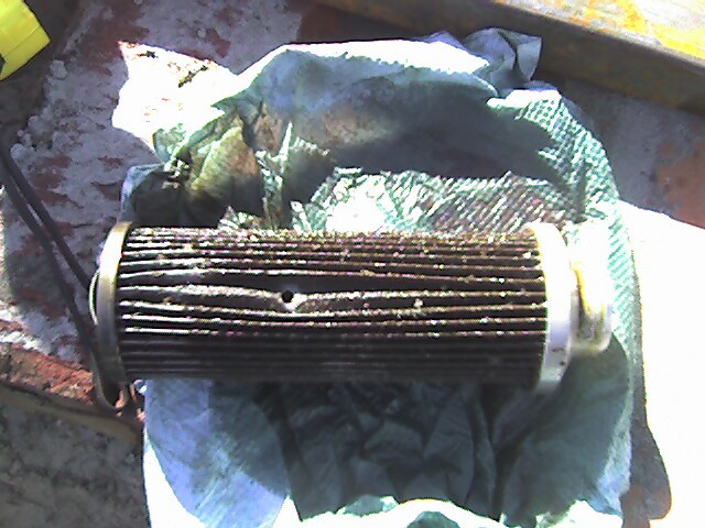

That is about what mine looked like except that mine had a hole in it.:( I think that the suction of the pump pulled the hole.
Mike
