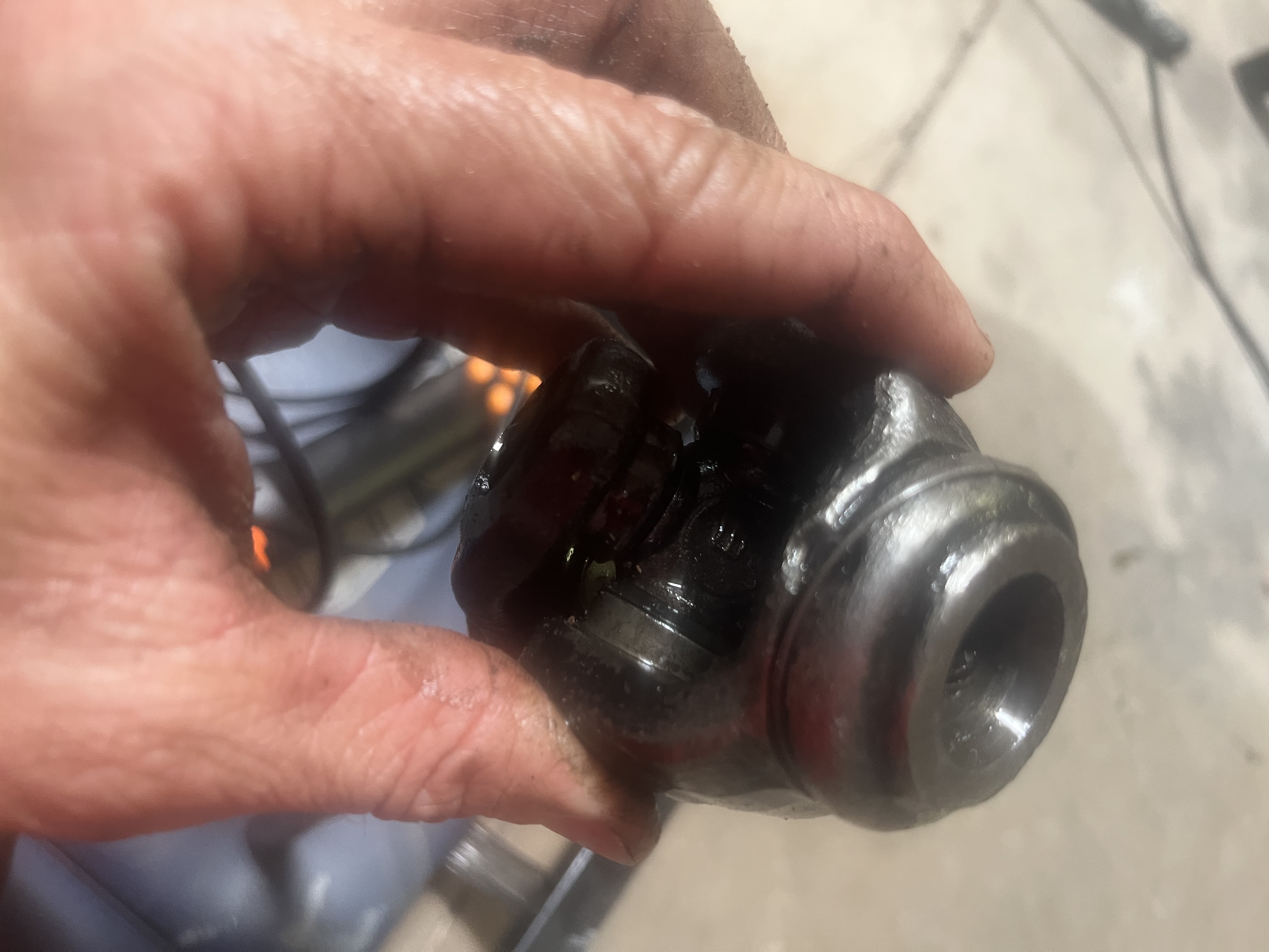

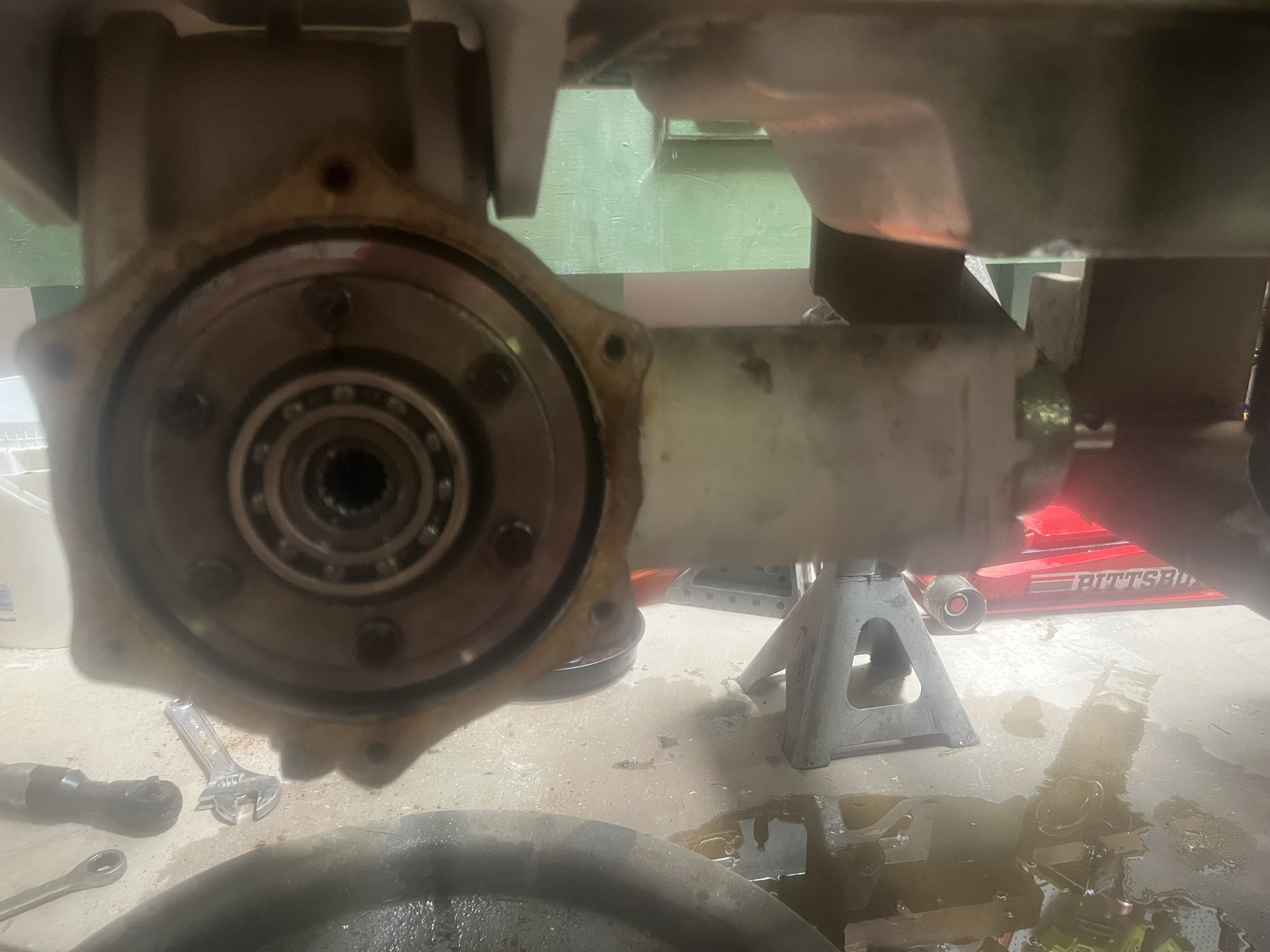

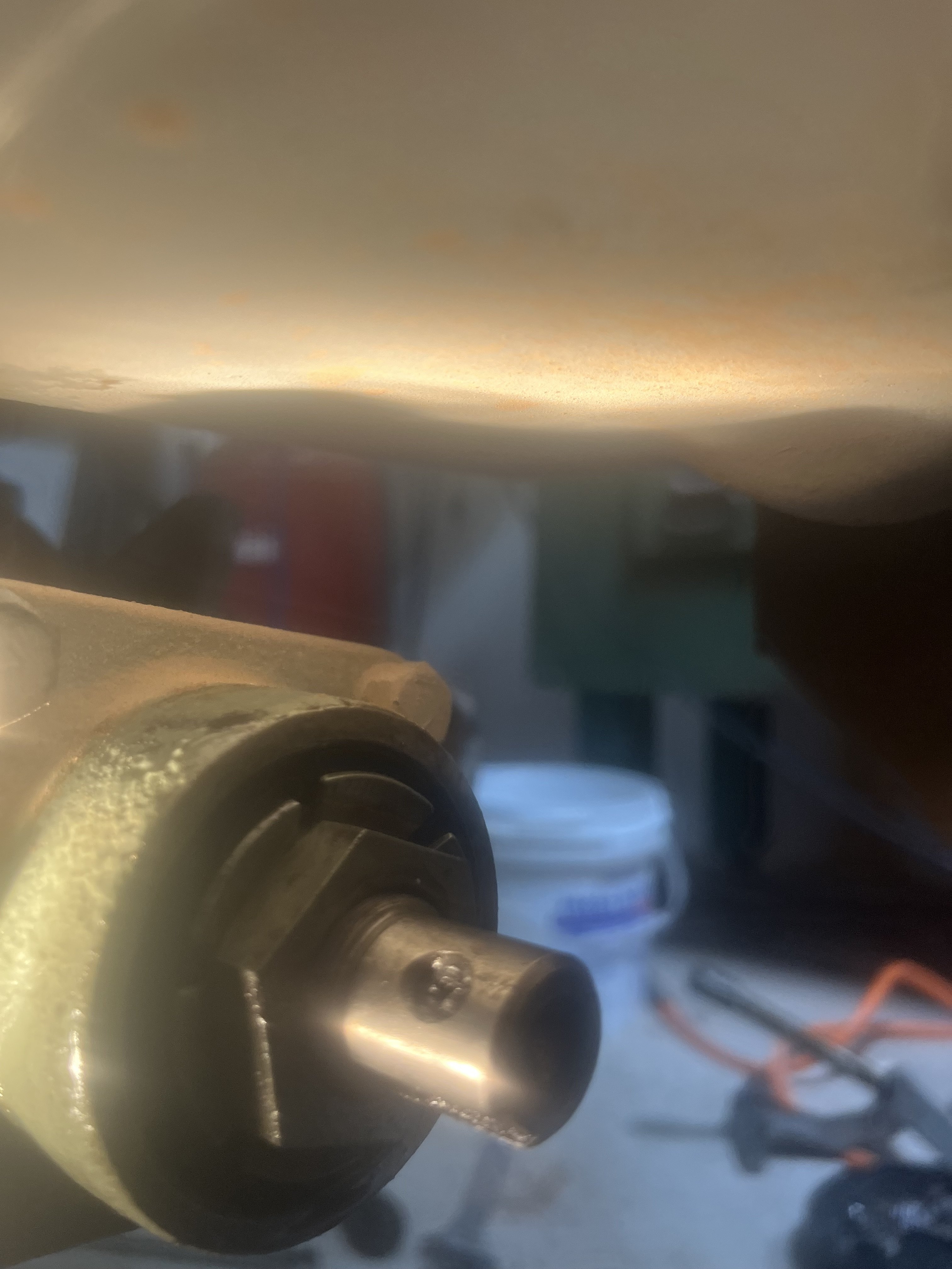

Update:
Thanks again, everyone, for all your help so far. It’s been reassuring to know that I can ask questions here and get such thoughtful advice.
I was working on my tractor again today and wanted to share what I’ve found:
  • I removed the left axle cover to check for stripped gears—so far, nothing looks destroyed in there.
  • I pulled the driveshaft, and the lower U-joint looks a bit scuffed up. It’s not completely broken, but I think I’ll go ahead and replace it.
  • One thing I’m still debating: On the front differential, where the driveshaft connects—if I spin that input gear, I would expect the axle spindles to turn. However, they’re not.
  • Looking behind the left plate, I can see a gear spinning, so something is moving internally.
My main question now: Is there some sort of clutch or mechanism in the front differential that engages the wheels? If so, I’d like to understand how it’s supposed to work so I can troubleshoot more effectively.
So far, I’m encouraged not to have found any completely destroyed gears—just the chipped
gear I posted about earlier and the U-joint that needs replacing. If anyone can help me identify how this front differential functions, I’d really appreciate it.
Thanks again for all the guidance.
— Matthew
