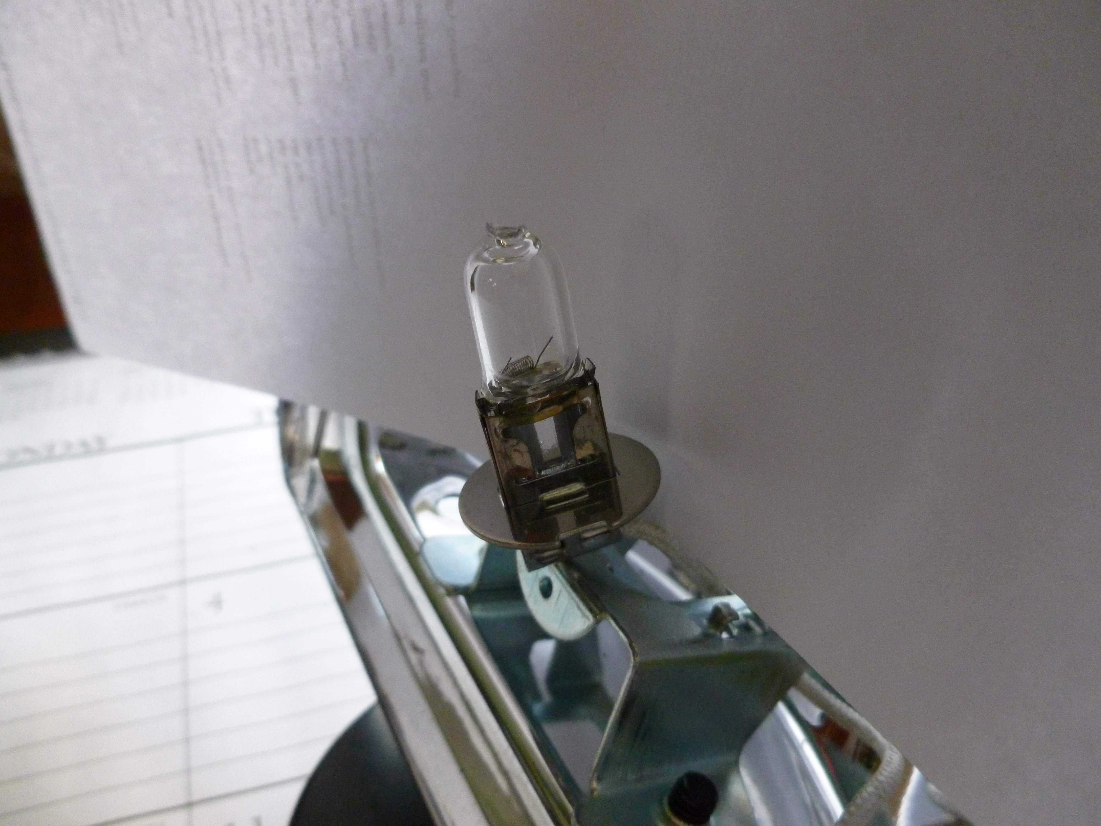

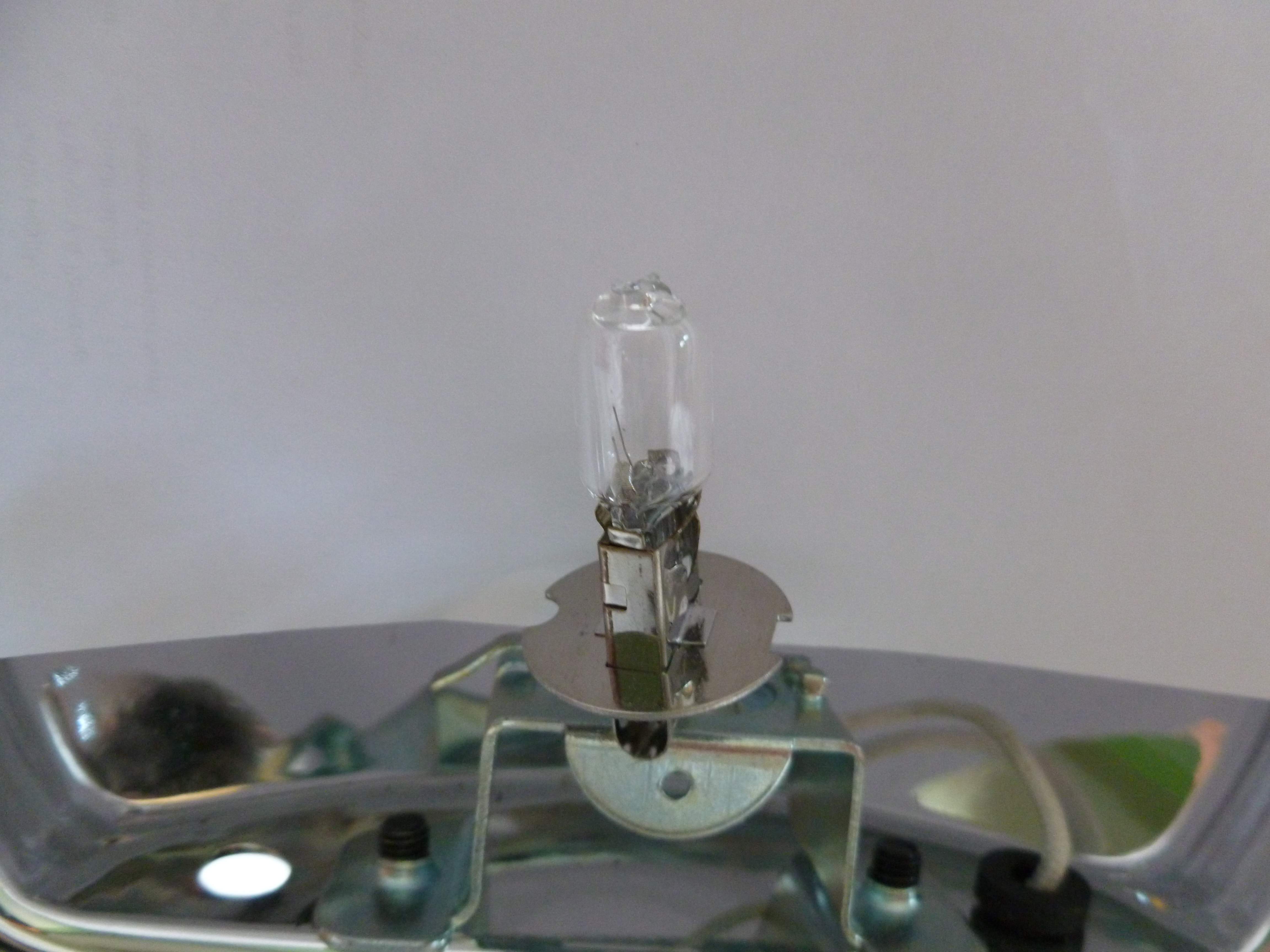

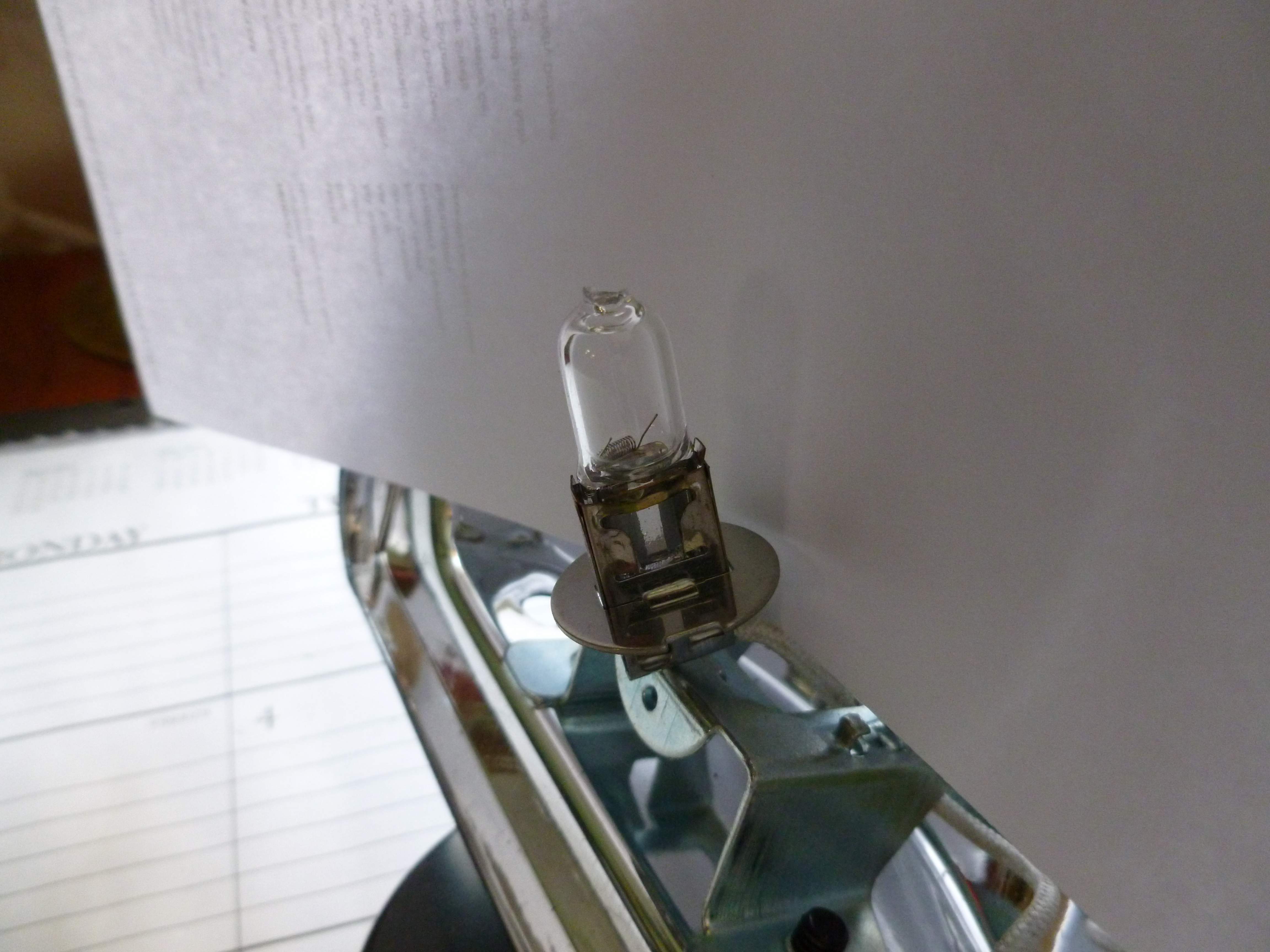

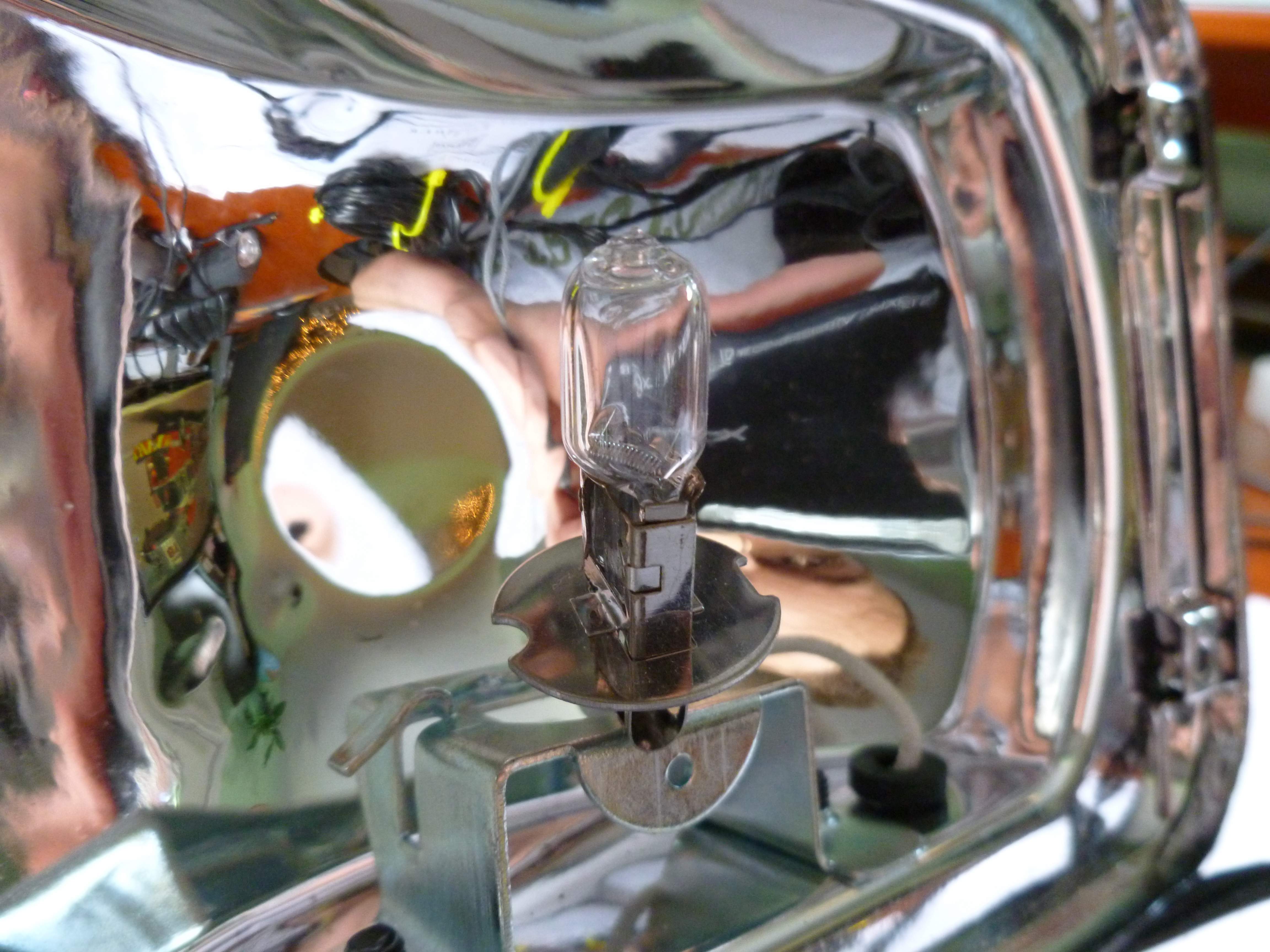

I need your help! I have a magnetic 12volt worklight I purchased at TSC. A few months after I bought it, it stopped working. I took it apart, and I found that the filament in the bulb was broken. Now I can't get the bulb out to find a replacement. I tried and tried, but it would not budge. I was wondering if anyone on here knows a way to get it out? I would really hate to toss the whole $20+ light just because the bulb is broken.
Of course, attached are some pics:
Thank for any advice you can provide.

Looks like an H3 bulb, the lead comes with the bulb. I dont see hows it mounted but seems like the most logical. Google H3 bulb and you should get a lot of hits.

looks like a headlight bulb. The metal base plate is part of the bulb. The new bulb should have a lead too.

G'day as said it is a H3 globe and it comes with the pigtail on it you will have to pop the rubber grommet out of the base of the light and you should see a blade type connector.

I'm with banjodunn, pull out that little rubber grommet and follow the wire to it's connection point. The glass bulb doesn't come out of it's mount - it's all one piece. Those bulbs blow easily mostly from vibration - especially when they get hot. Good luck....

The bulb runs about $5 to $7 and should plug in somewhere on the other side of the gromet. And the life life can very do to vibration . Some times Wal-mart is closer to $5 , get two then you will have an extra bulb, for next time ...

I was looking at the problem all wrong by trying to take out just the bulb and not the whole unit. I found the connector, and the rest was easy. I will look for the replacement bulbs later this week.
