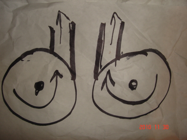

I agree with others, it certainly sounds like it's going backwards. Since the impeller is essentially an axial fan, I find it easiest to tell if it's correct by observing the rotation of it: it should rotate toward the exit hole.
See my fine artwork below.... (no, those aren't smiley faces!:laughing:)
Hope yopu get it fixed soon- won't be long now!

just got off the phone with the dealer.He thinks the pto wasn't engaging all the way.
He's going to put it threw its paces today.What ever that means:confused:.not enough snow to do that:confused:
   / need help setting snowblower
#14
good news it was in the switch .something about not enough amps going threw to engage all the way. all fixed:thumbsup::thumbsup:I talked to one of my neighbours today which owns a new kbot,same issue.so I quess it doesn't matter what color we own everything has its defects

they told me the switch was defective and wasn't putting enough power to the relay.I thought the switch controled the hyd valve which engaged the hyd pto
