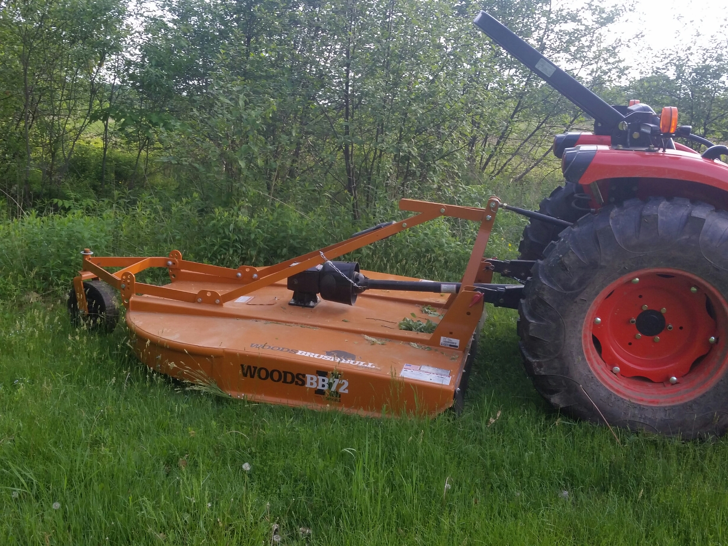

That's why I have a 5 footer rather than the 6 footer I was looking for. I knew that routine mowing would be with my 6+ft flail so I wasn't that concerned about number of acres per hour mowed etc. And as it turns out, in thick brush it is sometime better to have a slightly undersized bush hog just to concentrate power and increase maneuverability. All things being equal I'd have gone for a six footer but the price on the barely used BB600 was just too good to turn down.
$900 is a really good price for a BB600X. I paid $3500 for my BB720X. Size wise, I do like that the cutter is as wide as my wheels for my ability to quickly clear spaces. I'm running my tractor at 2000 rpm in the following video the only time I bog down is when I'm mowing dirt, rocks, and large windfalls.

No doubt the BB720 is the preferred and standard bush hog size for a 40+hp CUT.
The way I use my BB600 however is mostly in backing into thick brush. I cannot walk the area before cutting as it is thick brambles and briar and so I couldn't be sure about absence of obstacles anyway. I call my technique reconnaissance by mowing. I simply make what looks like the start of a Y turn, back into the brush about 8-10 feet then pull out, move 5 feet along and then back in again.
As I don't drive forward with the brush mower often the narrow width doesn't bother me.
