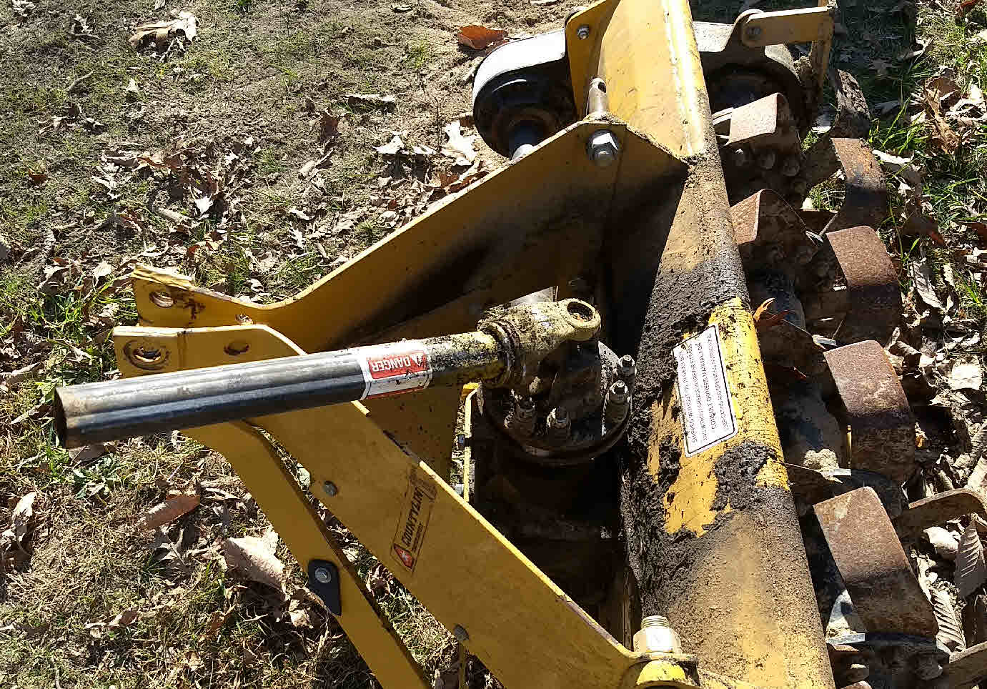

Make sure that's not just a regular PTO shaft. Your tiller goes into a gear box, not a splined shaft, so you would need to take apart the universal joint on the tiller side.
That's correct. I doubt you will find a shaft including clutch for $150. There are sources for 1/2 shafts. You could also shorten a regular male shaft if that's all you can find.

From the pics you've posted, I would try to get them working. The tiller doesn't look like it has many hours on it. Many people treat implements very poorly. Fail to lube, store outside, etc. I see them as a major investment and treat them accordingly. Most of them can be brought back from the brink to be usable tools.

Since the paint is worn off of the shaft, I think it is the male half. Not sure how the safety label survived, the female half must have been cut off real short.
Go look at a new tiller and measure the male shaft diameter.

I have that exact tiller. I bought it from TSC approx 5 years ago and it's been a good tiller thus far. I changed my brackets around some so it would better fit my quick hitch. I had a fitment issue and thought I had cut my PTO shaft to short. I looked in the manual, called the company, and they sold me a complete new shaft with slip-clutch for about $180.00.
Yours is on backwards and you can easily buy a replacement. Just bolt on and go to work. If you want to save money you can listen to all the great advice you receive here and search for a replacement end. It does get confusing in the individual piece department tho. and you still have to reverse the slip-clutch section. Up to you.

I looked again at the picture just above my post. It looks as if that may indeed be the female end and not actually installed backwards. If so you just need to go to TSC and match up with the male section. At any rate, just go to TSC and look at their tillers on display and you'll soon see whatever part you need. Maybe they have the end section you need on their shelf and it'll be much cheaper than a new shaft. Good luck.

Thanks for all the support and recommendations, everyone. I ended up buying the shaft $117 + shipping (around $150) from a seller on eBay. I sent him the manual for the tiller, and he responded with the link to the shaft - which he said was specific to that tiller - and included the slip-clutch. Here's the link to the shaft.
I was originally going for his listing that was listed for the King Kutter tiller. He said that one would need to be cut to fit, where the one above (which he recommended) should fit w/o trimming. It arrived today, but I haven't had time to install it. Hopefully in the next day or two. Will post back here with the results.
