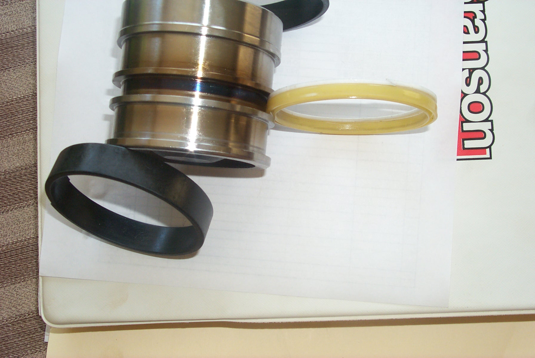

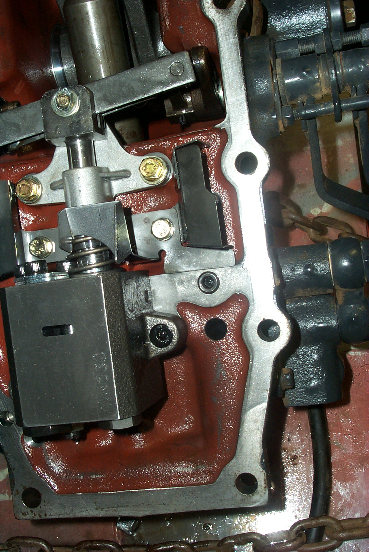

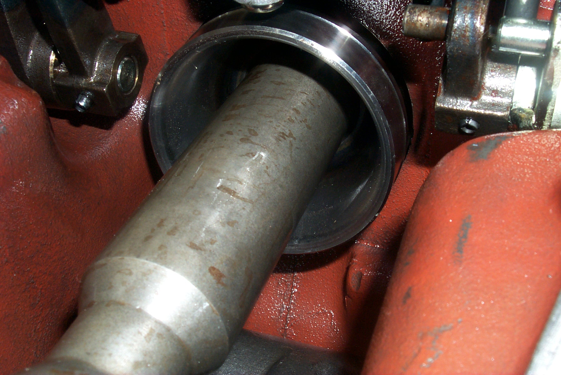

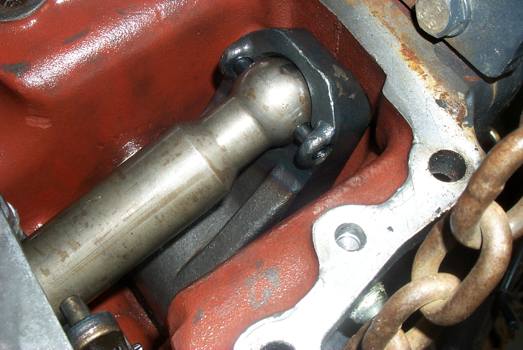

Sure , I took about 50 pics or more. Unfortunately, I did not take any of the valves disassembled for cleaning and inspection. I'll enclose some of the piston and seals, the crank and piston inside the bore, and view of bottom of hydraulic assembly.

I suspect most folks would have just repaced the piston seals and put it back together. I have to try and figure out why this is happening and the cause of the problem more than the fix. I just can't fathom these piston seals wearing out so fast, and needed to solve it. Hopefully I have.
A couple of things: I checked my warranty paperwork, and at 155 hours, the dealership shows replacing all 4 piston rings, the 2 wear rinmgs, the lip seal and the backer ring. There was no mention of checking or cleaning any of the hydraulic valves. I now have 338 hours, and its shot again. I suspect that the pressure relief valve has always been sticking or stuck. These should last more than a little over 150 hours usage. If the mechanic at the dealership had inspected the relief valve, he might have corrected the problem.
Second, I have had more than one Branson mechanic advise me to be cautious when holding an implement in full lift. Some mentioned it could cause excess heat. I don't really understand that statement. What is the difference in holding an implement up with the piston halfway up the cylinder bore, or full out in max lift? Unless, something is happening at full lift that is not midway in the bore. That is what led me to really examine the piston relationship to the bore. In the one shot I posted earlier, you can see that it doesn't take much protrusion of the piston out the cylinder that the bottom wear ring is exposed and partially out of the bore. Some people have made posts that the heat gets so great it melts the backer ring, and probably collapses the lip seal, too. Why the heat? I haven't got a real good grip on it yet. Hopefully my attention to indexing marks and attempting to keep the piston fully inserted in the bore when in max lift will alleviate that issue. Time will tell.

A stuck relief valve could indeed have been the root cause of your problem. It should limit both a steady state case of an overloaded hitch and the dynamic case of a a heavily loaded hitch on a tractor bouncing around on a rough field. If the relief valve doesn't relieve, than the weakest link in the system will relieve (piston seals?).
A stuck open relieve valve or one that is constantly open due to overload will generate a lot of heat because it will recirculate high quantities of fluid through the pump which, due to pump inefficiencies, will cause the fluid temperature to rise.
After reviewing you pictures I can see where the lower seal could protrude out of the cylinder and I believe the action you took to correct this was probably correct. However that seal probably is not that important since there are three seals ahead of it and the fluid presure drops between every seal. But if it isn't going to seal anything, you can question why it was put there.

"After reviewing you pictures I can see where the lower seal could protrude out of the cylinder and I believe the action you took to correct this was probably correct. However that seal probably is not that important since there are three seals ahead of it and the fluid presure drops between every seal. But if it isn't going to seal anything, you can question why it was put there."
It sticks out a lot at full travel Here is another picture, clearly showing the piston protruding out the bore. Keep in mind that the rings are not on the piston while I was measuring and taking pictures. If the bottom wear ring was on the piston, it would be way out of the bore.

The relief valve didn't have any real evidence of heat, other than stuck. And I know it was stuck partially open, because when I was air pressure checking the passages, just a trickle of air was flowing through the passage. After I got the valve free and removed, cleaned and reinstalled, the same air check allowed a HUGE flow of air through the passage. If no air had gone through, then I would have believed it to be stuck closed. But, I saw no heat discoloration on the valve.
Look at the picture above of the piston. There is a lot of heat discoloration aroung the lip seal and backer ring groove on the piston. So I believe it has been pretty hot at some time. Thats what led me to make changes to limit how far the piston protrudes out the bore at the bottom. Of course that picture was taken at extreme travel of the crank, rod and piston. I believe the original Branson setting most likely had the piston stopping about 3/8" short of crank contact with the case. Even then, the bottom wear ring was protruding out the bore. That can't be good.
What caused the heat discoloration on the piston, and probably the premature wear on the lip seal? Nopt sure, but I feel that me changing its travel can't hurt, by keeping the piston fully iin the bore.
