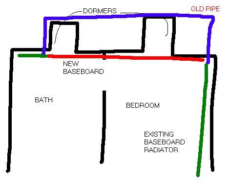

Good News: It works, pipes thawed
Bad News: Pipe burst
Good News: Leaking in garage, not house
Bad News: Tractor got wet & has to spend night outside.
Plumber is coming tomorrow morning to fix pipe. With one lame hand, I figure it is money ($50 base + $16 per every 10 minutes for Emergency work) reasonably well spent.
How it works: Makes 300 amps at 5 volts. need to be able to put clamps on either side of frozen pipe, near freeze. 10-15 minutes later it melts the ice enough for the water to move thru and melt the rest.

Plumber came today, It is a toasty 68degrees as I type this. We've got heat again woo hoo /forums/images/graemlins/grin.gif /forums/images/graemlins/grin.gif /forums/images/graemlins/grin.gif Supposed to get cold again soon too! Don't know what the damage is yet.

#38
Mike,
Hand is healing nicely
Egon,
the plumber cut the pipe where it went into the outside wall & ran new baseboard heat along the knee walls inside the house. See attached pic.
