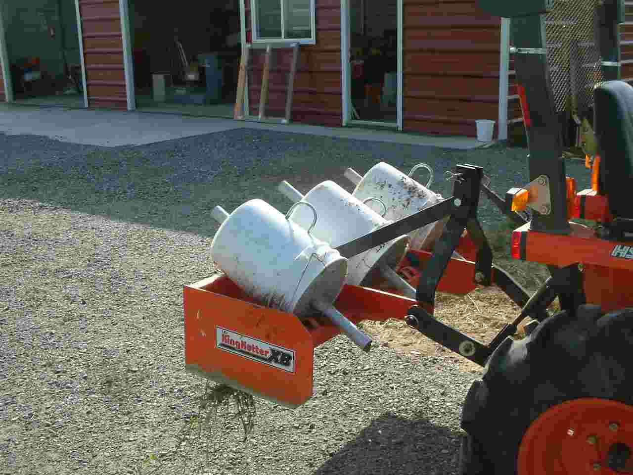

We've got similar situations, except that I'm a bit farther along now than you are. I've got a small, two wheel drive tractor with a FEL. When I first got it I tried to move some of the clay dirt I had stacked for over a year. All I could get is about two shovels full. Through trial and error I learned. The first thing I did was to add a good=heavy box blade. That helped a bunch. Then I made a tooth bar to help break up the clay. A little more help, but that big stack of clay was still formidable. Then I started adding weight to the rear end. The more I added, the better it got. I even filled the rear tires with water. Now I've got around four hundred pounds of weight, plus the box blade, plus the water in the tires. I've got good traction with all that weight and it will safely carry a full bucket of dirt if I can fill it. It's still not easy, but with practice you become better and better with your technique, and the tractor works better and better.
