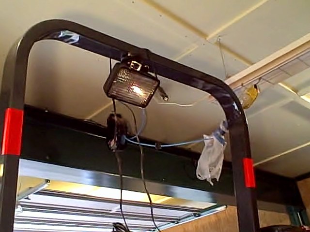

It is my understanding that there should be an aux wire /connector somewhere under the seat of my BX22, which can be used for a work light.
For the life of me I cannot find it. I've unwrapped every bit of tape covering the wiring harness exposed under the seat and found nothing. Can someone please describe the exact location of this wire, better yet provide a picture or a drawing? Thank you!

I don't know if this could help. I bought a magnetic work light from NT for my BX-25. It costs about $40 and plugs into the accessory outlet--if you have one.

On my BX 25 it's in the rear by the left side 3PH arm. I can snap a picture tomorrow if need be. Don't remember the color but they were terminated with bullet connectors and I'm pretty sure one was black.

On many Kubotas it's up under one of the rear fenders. Normally a bullet style connector, prob female. Would be taped back against the harness. Both Kubotas I've had used blue tape for that part.

Thanks guys...I finally found the two wires. They were really wedged under the large plastic part under the seat, which I believe must be the fuel tank. Once I freed up the harness, I was able to easily aces the two leads, which were wrapped in black tape. All is well.
