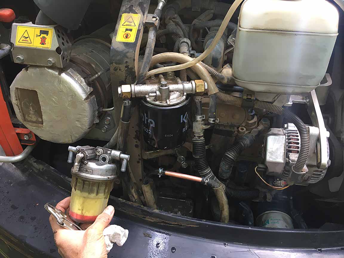

655919d1589736260-need-help-kubota-kx040-fuel-bypass-water-separator_9427-jpg
I took the separator off. The wiggly outlet holds vacuum, it cannot be the leak. There must be an O-ring in there. Nevertheless I eliminated the whole water separator with the copper tube -- and I'll go dig again but I'm not optimistic.....

655996d1589761879-need-help-kubota-kx040-fuel-flow-out-filter_9431-jpg
I was moving forward on my project to watch (while operating) for bubbles going by (thru a clear tube) to the injection pump.
I started the lift pump to pre-fill the tube and noticed the flow is almost nothing out of the filter. So thats a big clue of course when a machine could be starving for fuel.
:thumbsup: Clues are good. :thumbsup:
Filter looks "new", so we didn't suspect it, but could be plugged with algae or something?
I ran the lift pump for awhile (ahead of the filter) and it was pretty slow but then started belching out air and the flow increased. The air depleted and it doesn't seep like any more air is entering the system. So the pump was cavitating, not building flow or pressure.
I took the filter block off and inspected it carefully. No apparent problems.
But where do I get another filter on a Sunday....??
I'll try putting it back on and see if the flow out of the filter increases.

I bypassed the filter block.
I sealed the wiggling nipple on the water separator.
No change. It still burps air out of the bleeder.
So I proceeded ahead with my plan to add a clear line to observe the fuel that goes directly into the injector pump.
attachment.php
That hose is the last hose, directly to the injector pump
All that air is going into the injector pump.
It seems to run OK, I tracked it up a steep hill but I didn't push a pile of dirt with the dozer blade.
I'm gonna dig with it tomorrow and see if it can put out work with that much air in the fuel.

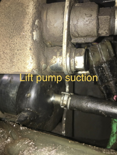

I ran the fuel out of the water separator, thru a long clear vinyl hose past the operator seat so I could see the bubbles going into the injector pump. I conclude that the Kubota injector pump can tolerate or eject some air. I don’t know how much - but it tolerates much more than I expected. Long strings of bubbles.
I found several possible leaks on the suction side. Fixing them didn’t solve the problem.
1) water separator had no o-ring. I was certain this was the culprit. Nope!
2) Elbow fittings at the water separator “wiggled”. I pulled them out, sealed very carefully with Permatex gray and put them back in. Tested with vacuum and it was tight. Still there was air entering the system somewhere.
3) Fuel “wetness” at the lift pump suction hose nipple. This is very difficult to access behind the counterweight. I fussed with it as best I could, moving the clamp to a “more proper” location on the nipple bead. And still it had bubbles passing by (in the clear hose) to the injection pump.
Dealer#2 told the owner that the machine had the “wrong fuel filter”, that the 040 has a “specific required fuel filter dependent upon the _machine serial number_” and said the whole problem was this. And said not to let non-qualified people mess with his eqpt. Well Dealer#1, 4 hours away who put the wrong filter on, and replaced the injectors, holding the machine for weeks, might be non-qualified too I say.
OK good luck! Simplest thing to try is the serial# specific fuel filter. And please let me know if this solves it. I’m curious if Dealer#2 was blowing a little smoke, perhaps not at me but at Dealer#1 (a notorious Kubota sales-price undercutter 4 hours away that other dealers hate on). My impression of Dealer#2 was the tech was very good. I think they like to promote their services, but even so, he was the real thing.
