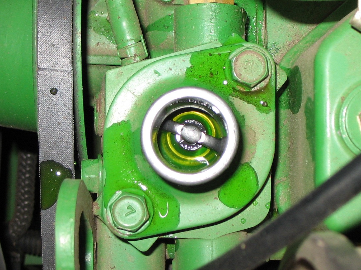

I recently purchased an '04 JD 790, it has a Yanmar Engine MODEL: 3TNV82A-LJNT (so-far-so-good). Since I've just completed all the fluid and filter changes I thought I'd tackle the Thermostat remove and replace task. :cool2:
The on-line JD Parts Catalog excerpt (attached) you'll see PN: 19M7867 (Key # 6) for (2) Bolts attaching the COVER to the top of the water pump assembly. There's usually some additional information in the REMARKs Column like the diameter and length, this time however nothing. :confused:
So off to the internet search and I found a JD1200A (attached) using the same PN (Key # 7) and the REMARKS Column indicates: M8 X 25 (HS, HEAD MARKED 10.9)?GREAT ! :thumbsup:
With that information and my handy-dandy Metric Bolt and Cap Screw Torque reference (attached) , the Torque Value should be 23.5 ft-lb Lubricated or 29.5 ft-lb Dry?. BETTER YET, PRETTY SIMPLE ! :thumbsup:
Just when I thought everything was peachy keen I noticed a small detail, the (2) Flange Bolt Hex Heads in question were marked with "7" (picture attached) :confused:
So off I went through the forums and found your thread with the handy-dandy reference guide for Japanese Standards (BoltTorquesFor_7Tand9T_Bolts) attached. I found the "7" hex head marking column and HUH ? Torque indicates "17.4-20.2 lbf-ft" and so I'm reaching for an answer, is the John Deere Replacement Part to the same spec the Yanmar "7" Bolt was made to.........
ANY SUGGESTION WOULD BE APPRECIATED THANKS...........

I think the torque values in red bolded font should be Newton-Meters, not ft-lbs. Suggest you reread the columm headers of the conversion chart and I think you'll see what I mean.

Actually, got home from work about an hour ago...
Do some more research...although there appears to be a contradiction, I don't think there is.
One chart is listing a minimum torque spec, the other a maximum. Also, the bolt coating and/or alloy can have a different recommended torque. When you do your research, you'll see more values for a given size.

I may have missed your reason for not using the originally spec'd JD part number, but when I search for that p/n on JD Parts I find the following info which includes specs and my local store has 31 in stock for $0.65 each:
There were three engines used in the 790 during it's production run...the bolt sriddle1ny specified may have been the one spec'd for his engine.
I suspect the one you quoted is for the current engine.

Roy, according to his (sriddle1ny) post he identified 19M7867 as the correct part from JD Pars online for his application, but because he didn't find the specs for that p/n, he searched online and found a second p/n. It wasn't clear to me why he abandoned the original p/n.
I was just trying to point out that JD Parts does give the specs for 19M7867 and it appears to be available from JD.
