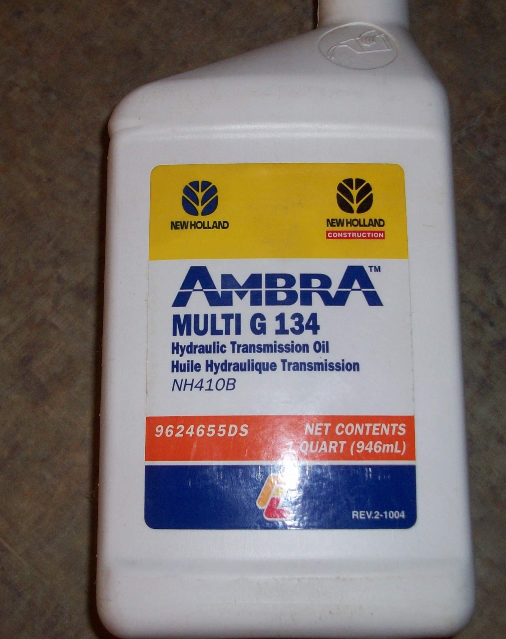

I use the AMBRA multi g 134 trans oil, it is the only one the New Holland dealer told me meets the specs for sure. 100_7612.jpg
I changed it out and cleaned the screen (although it was fairly clean) and replaced the large trans filter-they both go in the left side of the case.
Mine runs pretty quiet, yours may have a partially plugged screen and or filter, causing the pump to cavitate??
good luck

Thanks for the tip, I'll see if I can find some AMBRA 134G locally.
I checked the screen and it's clean. I haven't checked the main trans filter because I haven't found a replacement yet. Looks like they're as scarce as hen's teeth. Any tips on where to look? If there's none to be found, can the old filter be cleaned and re-used?

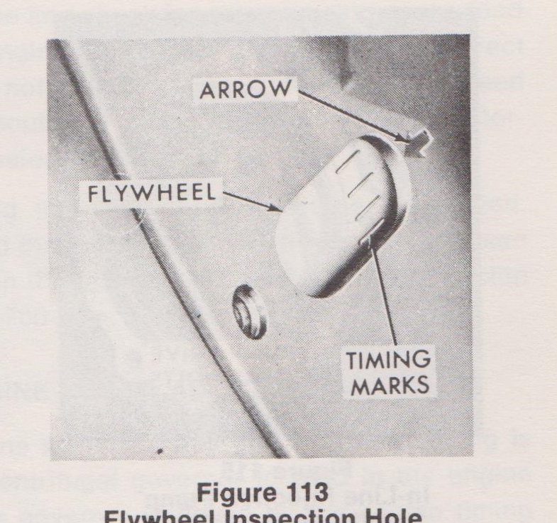

Oh and btw, where the heck are the timing marks on a '65 Ford 3000 with SOS? It's not on the front pulley or timing cover, I know this because I had the pulley off. And I haven't seen an inspection plate near the flywheel... ?

My 3000 is diesel but i did find this for timing ford 3000- timing gas 001.jpgford 3000 timing mark 001.jpg
hope it helps
