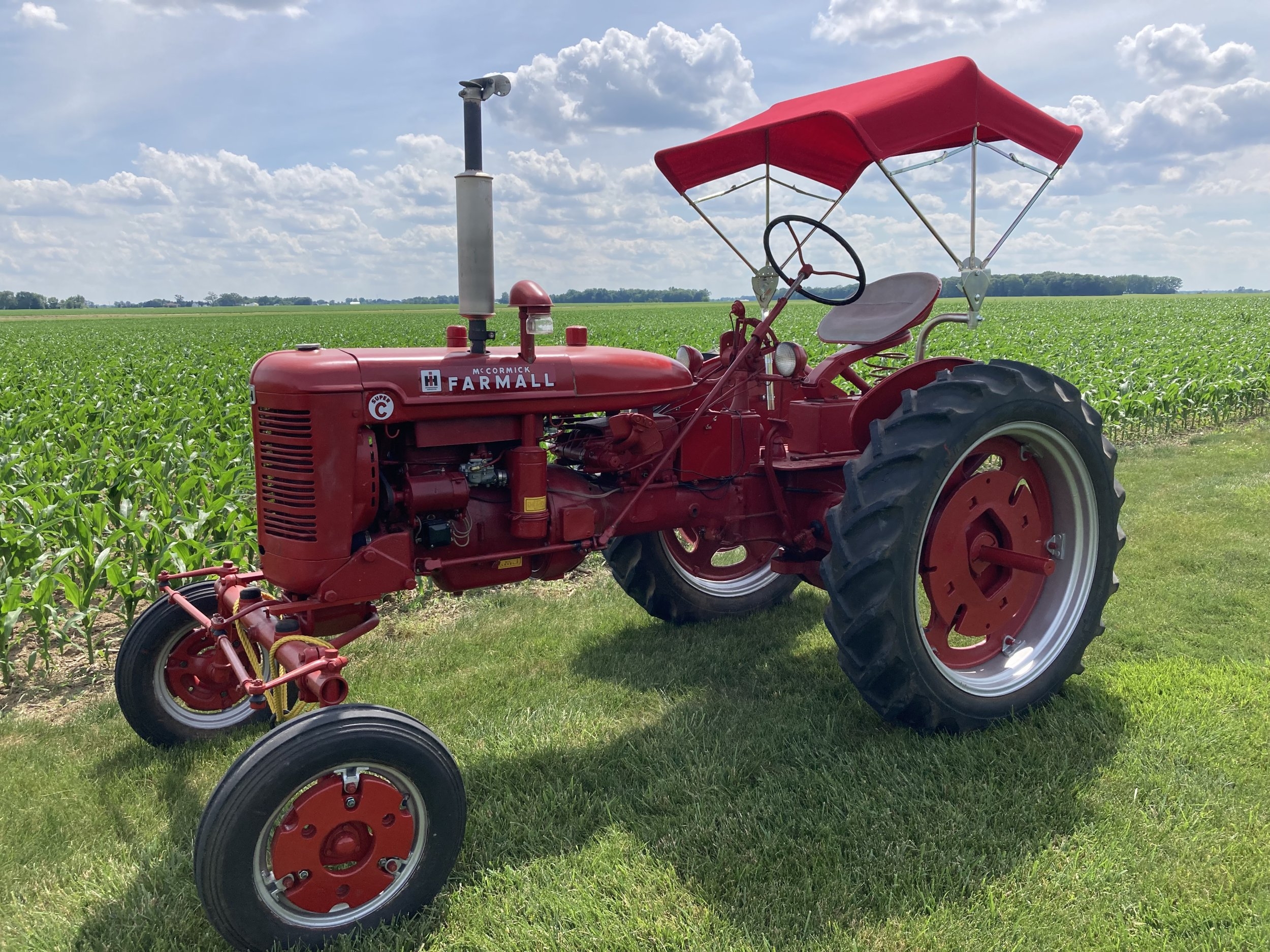

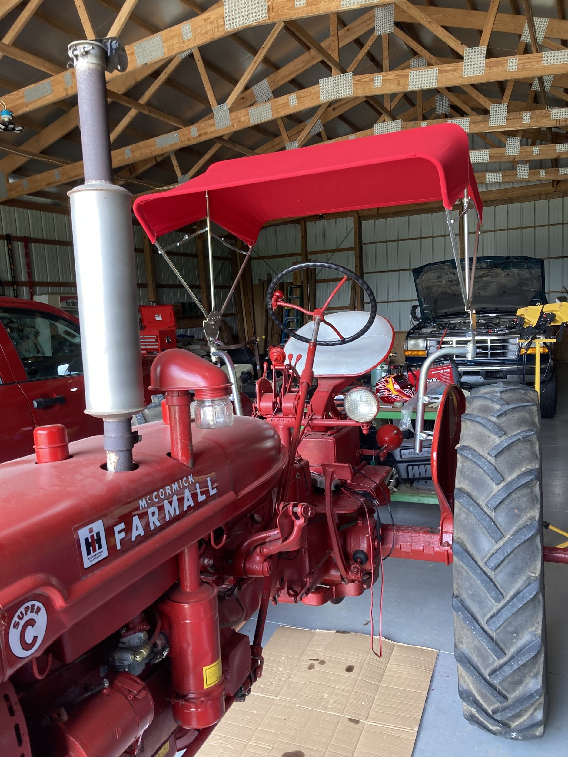

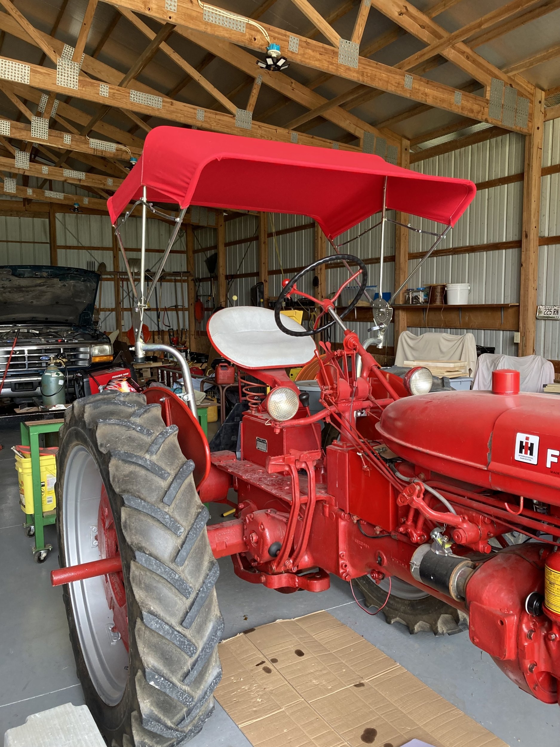

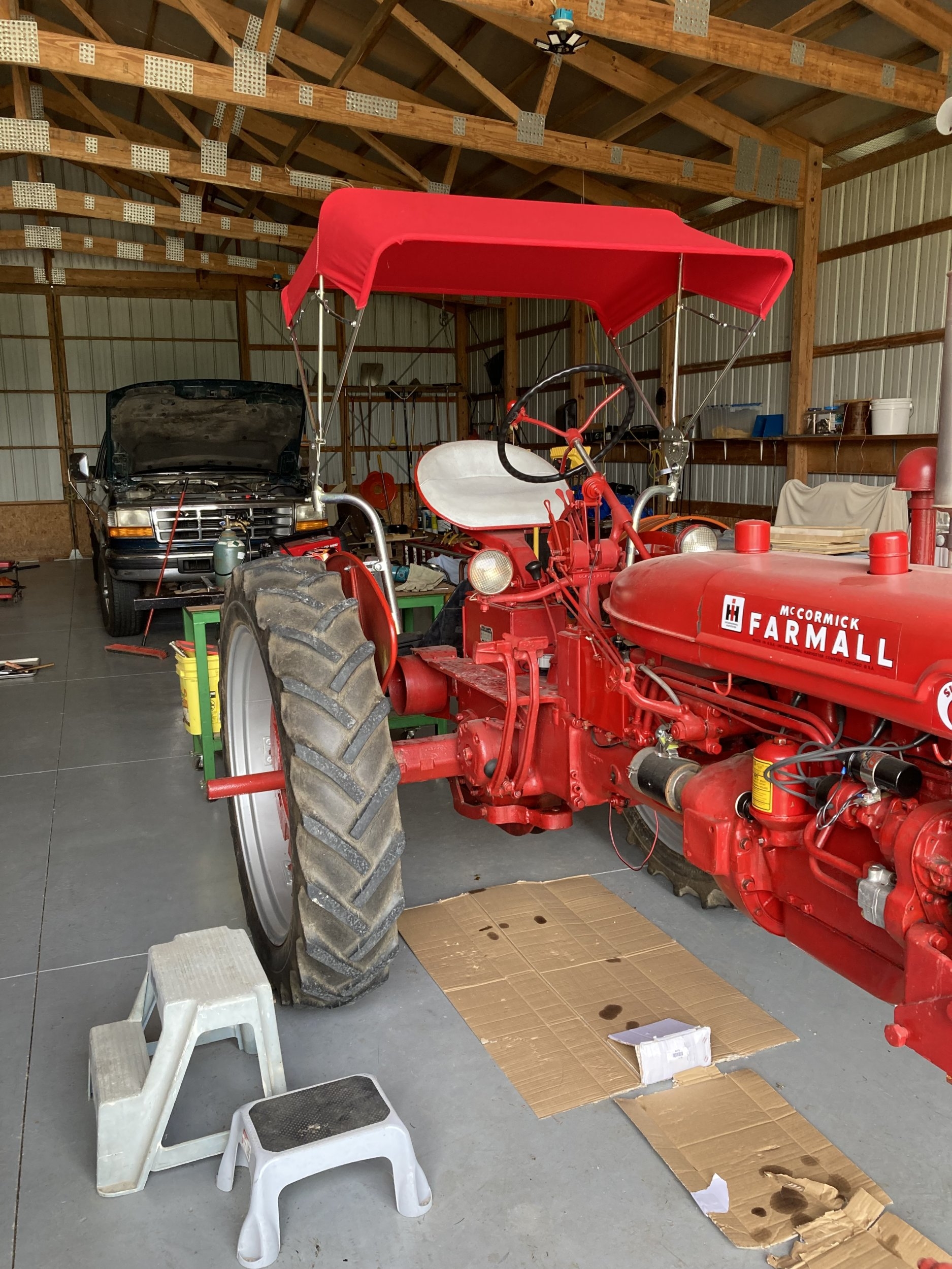

OK. I'm the OP and here's what I did. I bought a Snowco sunshade from Shoup Mfg and put it on yesterday. I got it done and it looks great. Dermatologist approved. :)
The hardest part was where to drill holes in the fender. I didn't want to but no other option. Assembly was easy and then out for a test drive. No problem with a 10mph speed and no problem with 10mph combined with 10mph and 3/4 frontal wind. It's rugged and I could remove the top as unit in maybe 2 minutes if I wanted.
Parades and tractor drives start soon and I'll be out of the sun finally.

I'm the OP and tested out the buggy top installation on a recent 30+ mile tractor drive. The top held perfect at 10 mph with a modest 5-7mph cross wind. Not even a flutter so it will take more. I was completely shaded.
Plus, I can pull the pins and remove or reinstall the top in seconds so it looks good at a parade or whatever.

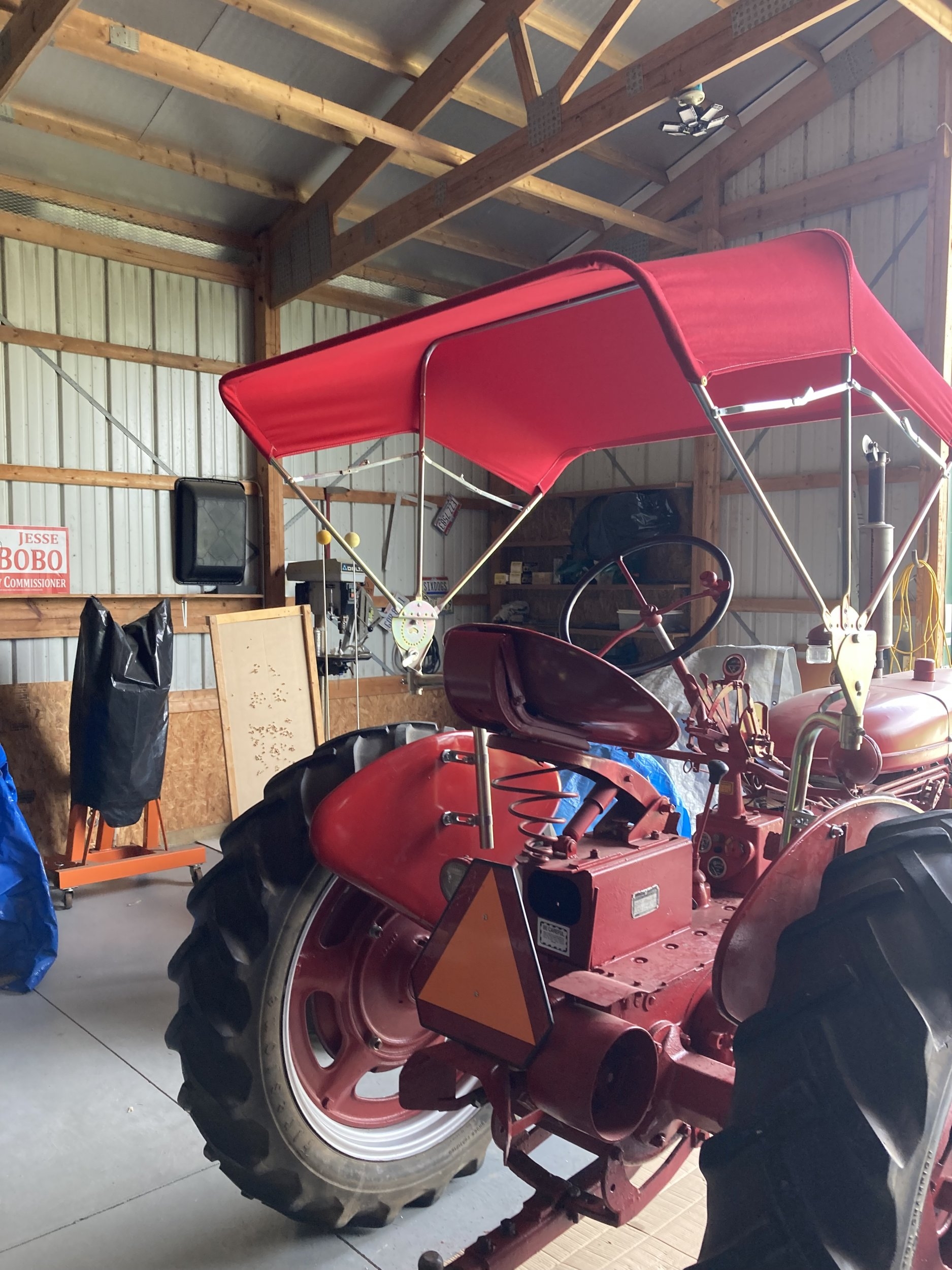

I'm the OP on this with a couple more notes. There were two widths of buggy tops, narrow and wide. I couldn't decide which to go with but went with the wide and it was the right choice. Your fenders will have to be set wide like mine in the pics. The narrow top is tough to get on the tractor and won't fit a hat underneath.
You drill the mounting holes in the fenders to the back of the support brace that runs vertically on the inside of the fender. My holes brush the edge of the bracket and you need that room. Ask if you want pictures.
Choices for a top are white and red. The white looks dirty fast and the red can fade. I went with red, fold it up on extended time in the barn and toss a plastic tarp over it and the tractor for storage. All good.
When you first adjust it to fit and get it right, mark some lines inside with a Sharpie so you can get it back the same way. Also, I slant my top forward one "click" on high speed (10 mph) rides and it handles the wind better. It also looks better.
Important edit--I wrote the wheels had to be set wide but I meant the fenders have to be set wide. Put the wheels anywhere you want.
