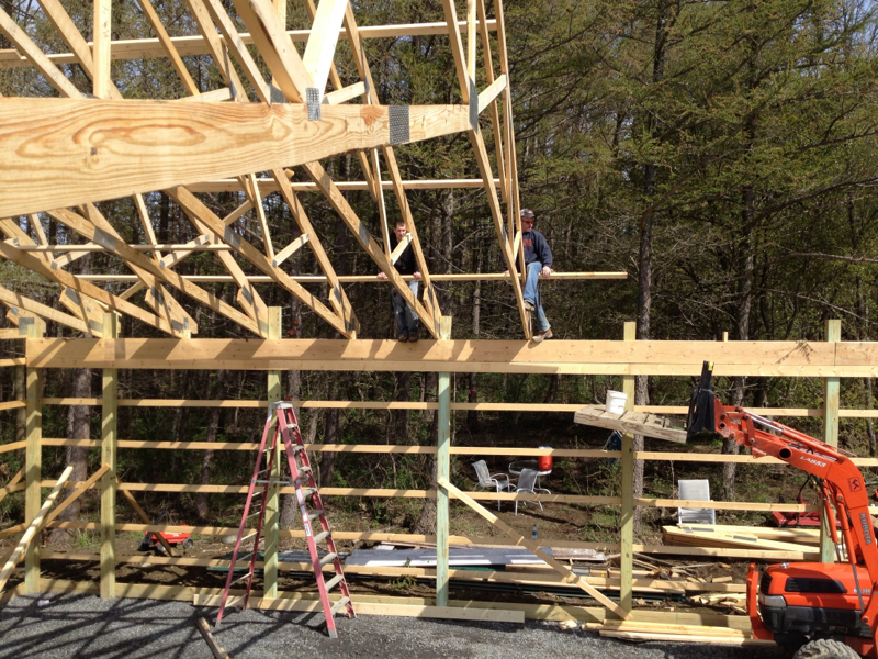

I stood on the side wall and nailed one on as high as I could reach. Then stood on that one to nail the next. Don't disconnect whatever it is you use to put it up there until you have enough supports in place. Also, after you put up a few, run a diagonal brace. Make sure you put enough diagonal braces as I have seen the trusses fall over with not much of a wind.

Thanks for the pictures.
