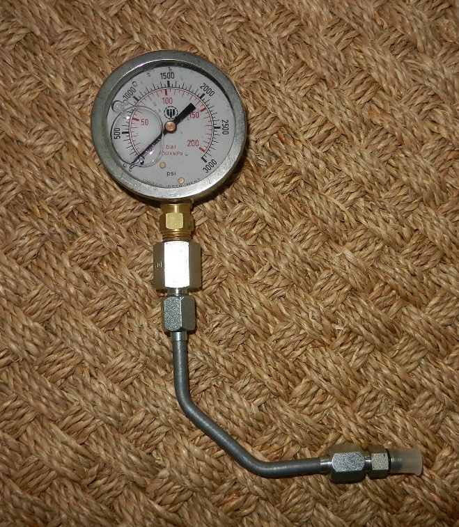

First, a public thanks to CADplans, he had a couple duplicate gauges and sent them to me....refusing payment (including postage). Nice guy and classy gesture.
I contacted someone online about some parts for my IH. He said he had the "Connector" that I'd need to connect the gauge to the PTO port (as contrasted to using a hose) He wanted $60.00 for it.
I stopped by hydraulic shop other day on way home, had page from manual with me and showed it to them. "yeah, we can make that.....it has a BOSS 9 on it" (or a BOSS something or another size, but they had it)
I bought some other stuff but I think this was only like $15 for them to make the entire connector line.
Question... in the manual, it states to use "Oriface IH No. 384-328-R1" Would that infer their part number would reference a "BOSS 9" instead of say, a BOSS 10???
(for the record, I'm not saying this uses a BOSS 9, I forget what they said, I'm just using that as a reference)
Pic of what CADplans sent me along with the connector. I need to get a 300 or 400 gauge for the PTO still.

Probably a O-Ring Boss (or ORB) fitting (that is what it looks like).
They are usually is even numbers that equate to the number of 16ths of an inch for that fitting size (ie: a 1/2" fitting would be a number 8 ORB fitting).

You are right in that it's an "O" ring fitting. (I had never heard of them called BOSS however, there are many things I've yet to hear about I'm sure!!)
None the less... looks like I'm in business for the PTO removal/repair. If a 1/2" (wrench size) is an 8 ORB fitting, then that's what this is. The bolt on the tractor takes a 1/2" wrench and this is a perfect fit.
