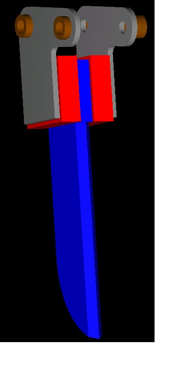

Not sure of the horse power requirements. whith one blade it should not be that much, I only have a bx22 tlb. as for a backhoe attachment ripper I just finished one myself. I do not have a digital camera but drew up a 3d solid of what i made. the cutting edge is 18 " x 5" x 1"thick. spacers are 4.5"square x 1.5" thick. mounting plates are 1/2" thick. I face hardened the cutting edge with weld and ground sharp by hand. goes on the backhoe after removing bucket. I made this for cutting tree roots when pulling stumps.
   / Need idea for toolbar
#9
Thanx Steven
I will make one of these this winter. May try to see if I can get two or three rippers in as I have a full size case hoe.
Hoeman00
Just for clarification, I was wondering if the area around the inserts needed beefing up a bit. They look like they would be the first thing to go in a bind. I may use this on the 50 hp as well as the compact, depends how stubburn the resistance. Most of the box blade main beams I have seen are just square tubing, looks weak, perhaps a added plate top and bottom would be more bulletproof.
