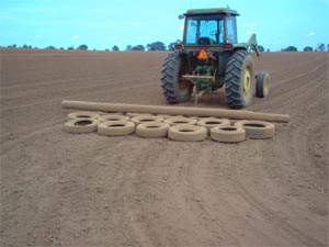

This may be overkill for a lawn, but I have about 7 acres that need to be disked and smoothed.
Got a bunch of free old tires from a guy North of my place. Plan to make a drag out of them.

I ended up making drag out of a chain link gate (4'x4') that I attacked two pieces a of pipe on the top then attaching a small piece of plywood to. I blocked in with 1x2 to hold in place 2 cinder blocks for weight. I was amazed how well it wokred. I pulled it around with my ZTR Dixon because the tractor would have packed the soil down to hard for grass seed. After dragging it level and making sure I didn't change any of my tapers for water drainage I then seeded and drove the ZTR over it one last time to compact the seed into the top of the soil. I then finished off with watering. I'm only doing about 1/2 acres in the front of the home this year. I've never planted seed with much luck in the past but this time I did my research on soil prep and hoping for much better results. I even had my soil tested. Soil was good just needed to be tilled and loosened up and lightly packed in place. I was told after tilling and rolling/compacting you should not have more then 3/8 of a compaction when you walk on it. I'm right at that and maybe a tad less. I recieved most of my info from the local sod farm here. He even took me out to freshly prepped filed ready for seed to look it over.

Oh great! Now we'll have a 20-page debate on "radials vs. bias ply to level your lawn" post................. ;)
Actually, that's a GREAT way to level ground and beat the life out of clods of dirt. I watched a contractor that builds "sports fields" do a seed bed for a soccer field with a tire drag a while back. It worked to perfection.
