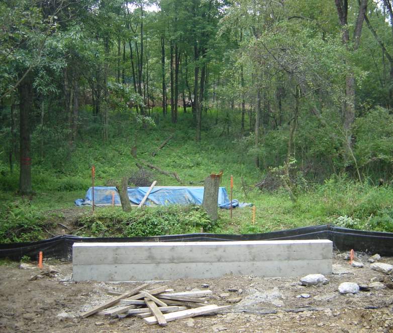

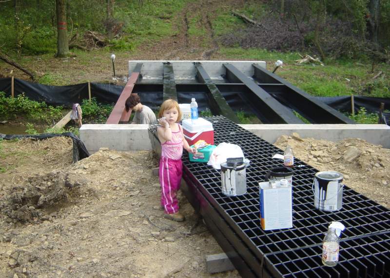

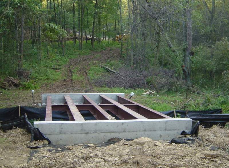

Need ideas for finishing bridge
   / Need ideas for finishing bridge #11
Building on those previous ideas.
Use stone pillara on the "street side" but perhaps use wooden posts on the "house side." In either case, add an additional wood post in the center. Then, add at least two wooden railings or guard rails that match the look of the house.
You could also add wooden "turnouts" on either end that angle down to the ground, similar to how the ends of highwqay guard rails are flared out. This would serve to gather your attention and "funnel it" across the bridge to the house. Would also add a safety factor...
If this is too much wood and stone for you, consider using wood posts and metal chains or cables for the guard rails....
IMO, you certainly need to add guard rails or a "bump strip" on each side. Wet metal is slick, even if it is a metal grate....

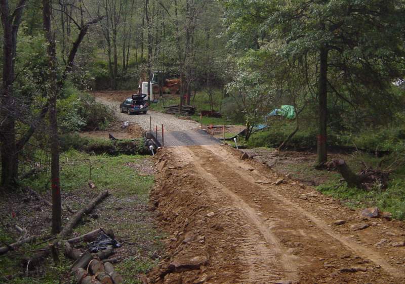

Thanks for all of your suggestions so far! /forums/images/graemlins/smile.gif
I am going to use colums like Eddie posted to cover the wood posts on the front porch steps...I never thought to use them at the bridge. I will have to think about that. Thanks also to Eddie and NSBound for the picture and creative editing. /forums/images/graemlins/grin.gif
I like the idea of using wood railing. I was thinking either log railing or split rail fencing. Flairing it out would be good (another good suggestion Mike).
If you can see the white pipe in the pictues that is conduit I am going to use to pull 120VAC all the way down the driveway. I was thinking about installing AC powered lighting that was on a motion detector. That way everytime a deer or turkey (or any one of a zillion other creatures) walk buy the lights will come on...all night long...every night...maybe I should think about that agian. /forums/images/graemlins/confused.gif
Any ideas on how to connect the fense to the bridge (the middle protion, anchoring it at the ends could be with a post in the ground or the pillars)?

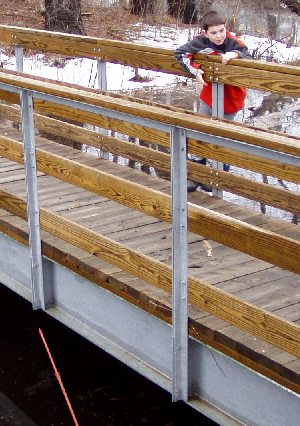

To attach posts, you could use short pieces of angle iron bolted (or welded) vertically to the web of the outer I-beams. The leg size of the angles would have to be greater than the offset of the web to the outside of the flange. With holes in the angles, you can thru-bolt steel or wood posts.
The image attached used welded stiffeners, but the concept is similar.
