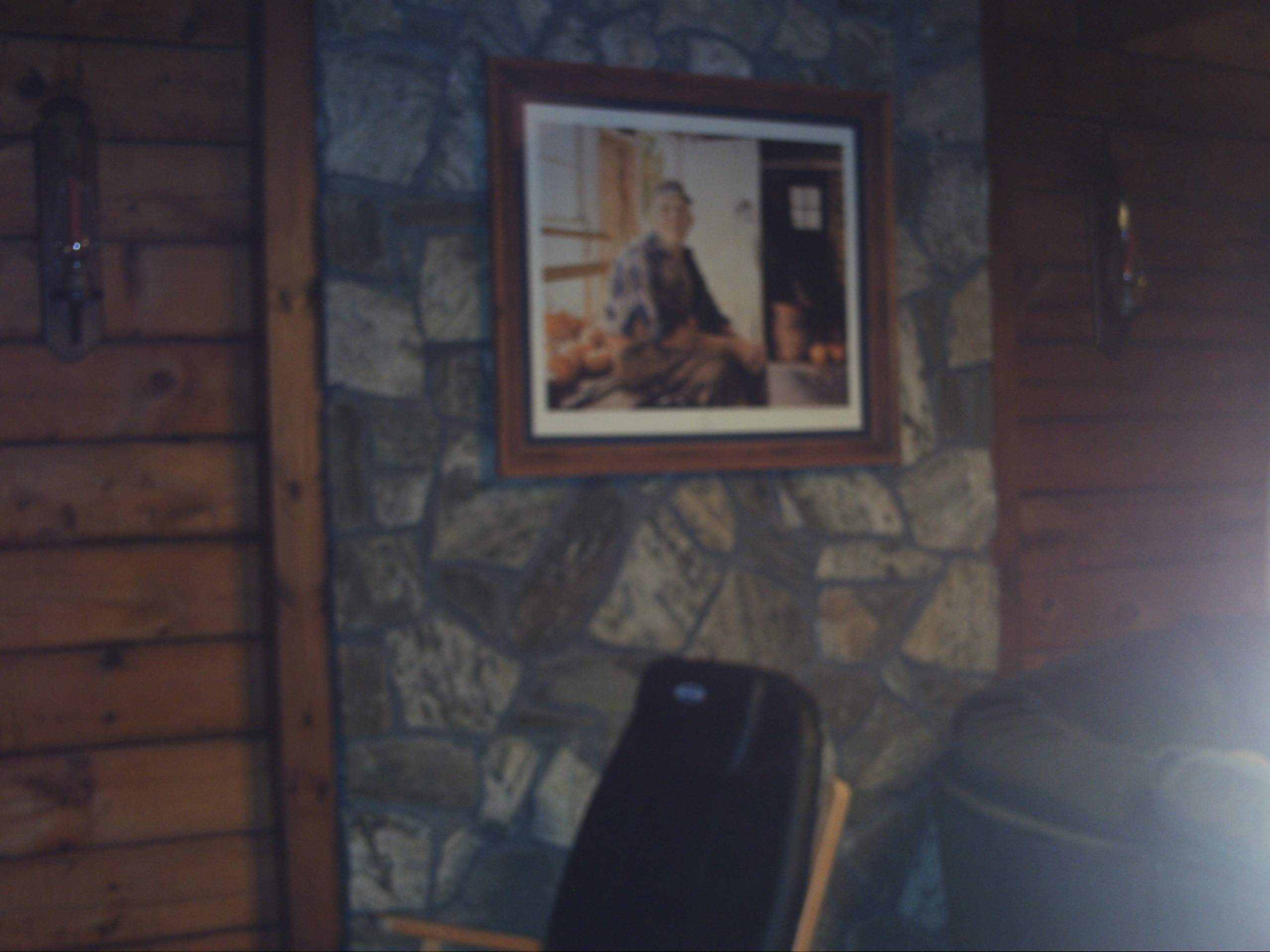

At one point in time, our woodstove was in the living room. We moved it to the cellar so the kids wouldn't break their little heads on it about 30 years ago. Now, this new woodstove which I automatically placed in the cellar when we first got it 3 years ago isn't cutting it down there to heat the entire house as did the old Timberline which you could dump a whole wheelbarrow full of wood into. This new stove allows about 6 chunks of wood so I got to get it where we are and out of the cellar. (That in itself should be fun moving 500# up 13 stairs) At any rate, the wife does not want the same hearth floor as we had which was an 8" raised floor built out of Connecticut stone. She wants it flatter like 2" high at the most. I do not know what is available to go with the hearth wall which are mortered randomly placed stone. To build the floor out of the same stuff would be too high as the stone is 4" thick and pretty uneven. The floor will be 6'by 4' . I was thinking about 2 hunks of slate but at 2'x6' and 2 " thick, I'm thinking I'm not getting that into the house by myself or maybe 4 other people. To get the slate into smaller squares would not go with the look of the granite stonework that the hearth wall is made of and was told if I attempt to bust up the slate to get random pieces, the slate would flake and crumble, so I'm open to suggestions as to what is out there and how to handle this. Thanks

Arrow,
If possible, can you put up a pic or two of your hearth/chimney you are trying to match?
   / Need ideas for hearth floor
