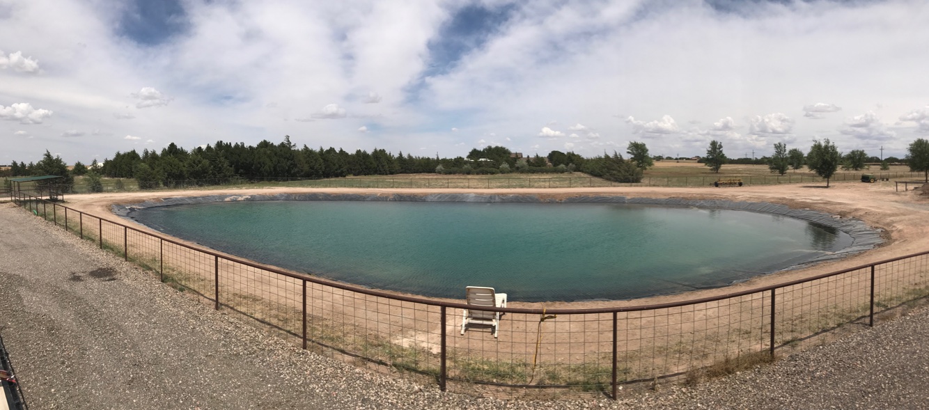

What kind of fence are you planning to install on that curve around the pond? If it's wire, you'll need a lot of bracing between the posts to keep the post from being pulled inward by the wire tension.
   / need ideas on fence layout
#13
All my fence is made of 2 -3/8" oilfield pipe with livestock panels welded to it. I hate stretching fence wire. You can kind of see some of the fence in this picture.

Here is another picture when the pond was first built and still filling up.

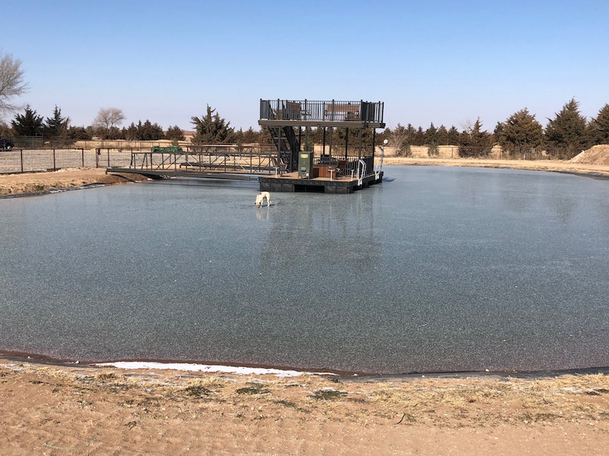

I think the only gate that matters is the one to your floating dock/deck. That is very inviting!
#19
Yes it is. We can't wait to enjoy it. We signed a contract on in last June and were supposed to get it built in August but they didn't build it until December. Been too cold to enjoy but will be fun this summer. The kids are going to love jumping off the upper deck.
