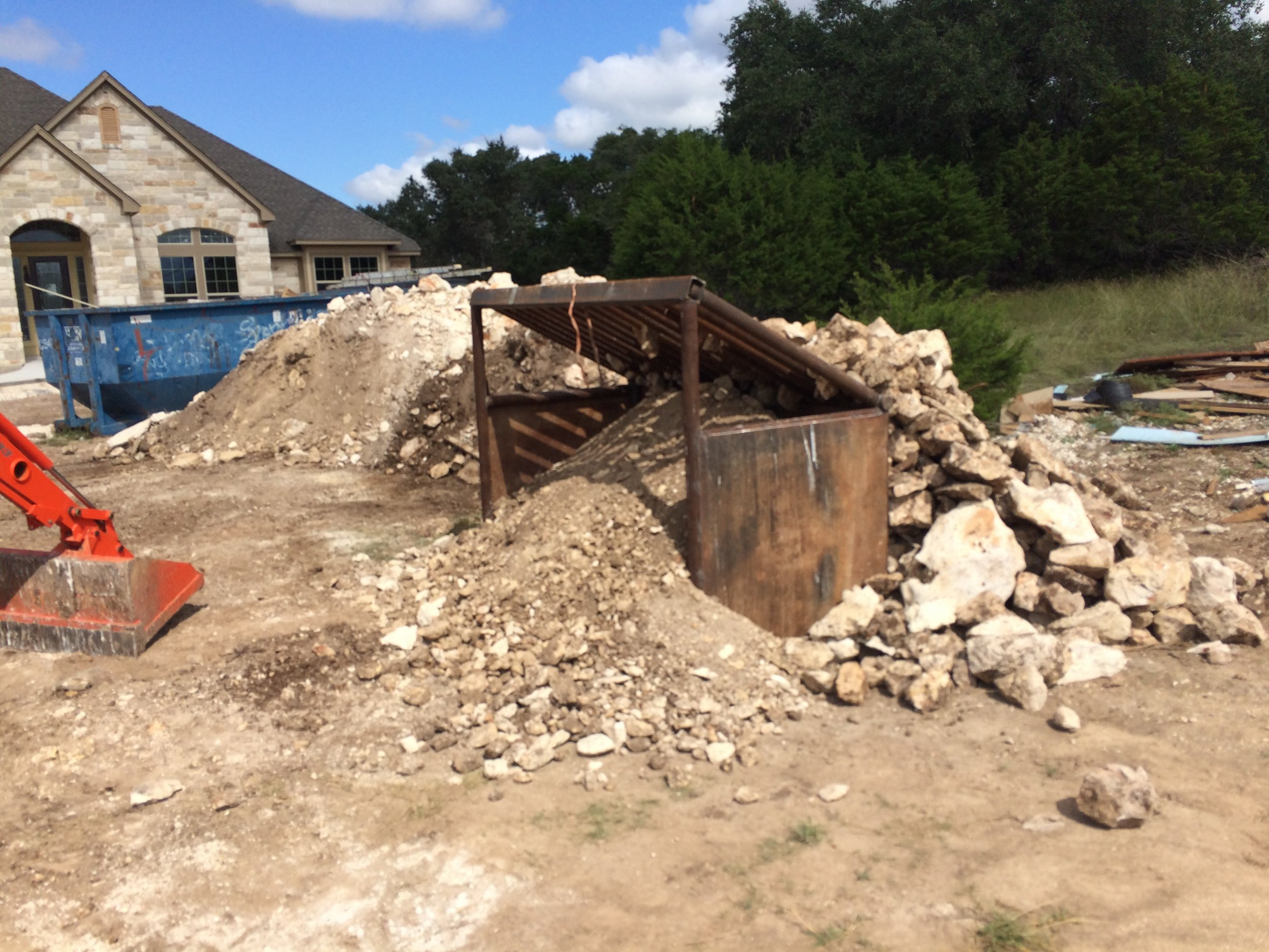

I made it with used well pipe from the oil fields and found a sheet of scrap plate and a piece of square tubing. I built it wide enough for my bucket to fit inside it. It is about 6 feet tall at the front and has a 45 degree angle to the rear/back side. Pipes across the top are 6 inches spacing, small rocks that fall through helped with compaction and drainage where I put the screed dirt. In areas I planted, I brought in top soil to put on top the screed material. Total cots were less than $100.00 and 2 days of welding. I converted it to a hunting blind when I was done screening the rocks and dirt piles on my property.
