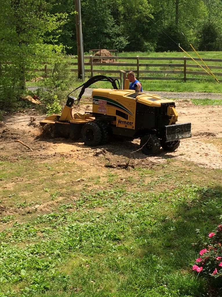

With the right tool, they disappear in MINUTES! I had one 11"-12" cherry and a 4"-5" dogwood that had to go, but after he got unloaded and done with those, we looked over some others. Wife said she really didn't care, but I know it's a pain for her to mow around them, so he also did a 14" hickory, a double 14"-16" hickory, a 12" hickory and 2 partially-rotted 10" hickories. It surprised me how much solid wood was left in those. So, seven total, counting the double as one. He cut them all at least 12" below grade except for the double that was right up against a nice dogwood we want to save.
$325
He did say that his little grinder set him back about $105,000 :eek:

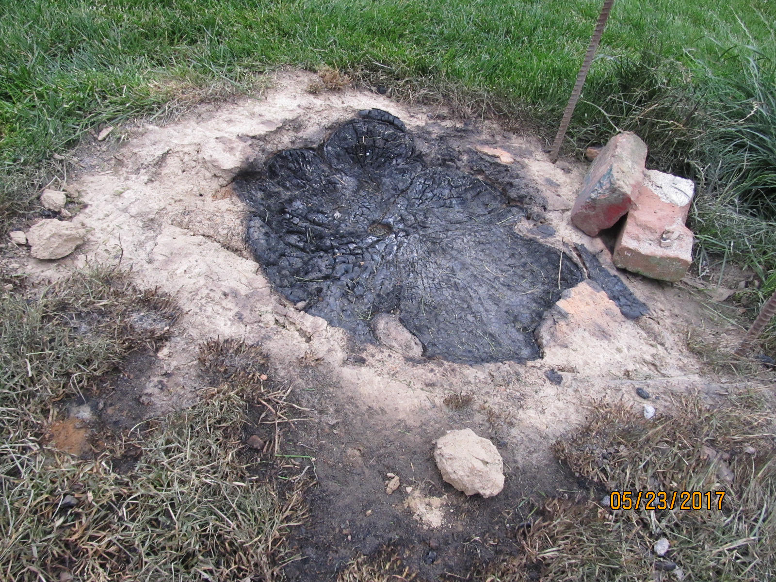

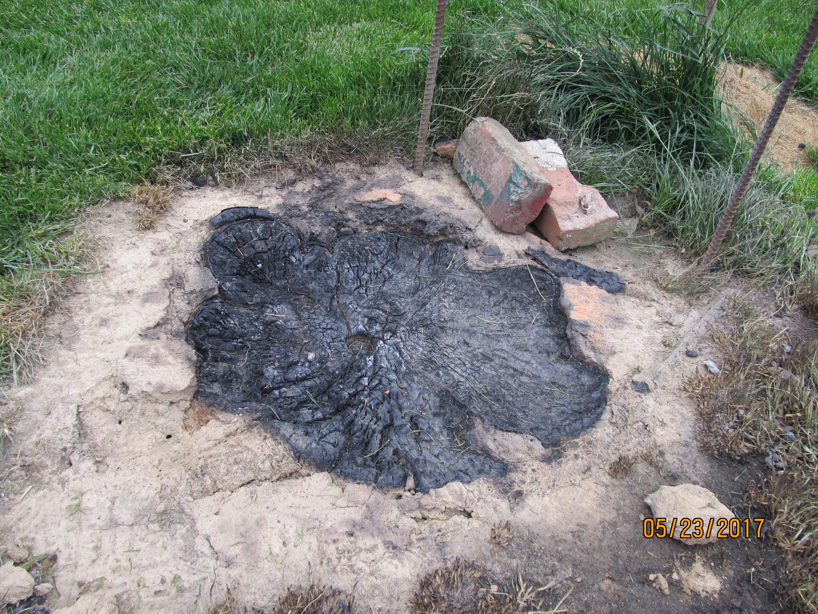

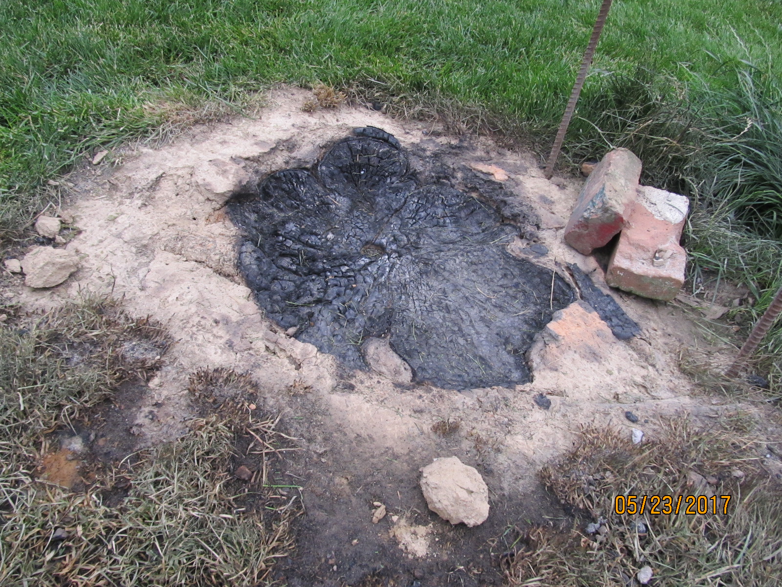

Back in post 52 I showed the stump with the holes I drilled and my plan to burn. Today was the day and I learned how and how not to do it.
First, I soaked the stump in charcoal lighter fluid and let it sit for an hour. Then I neatly layered on half a big bag of charcoal and soaked that with lighter fluid. and lit it. After an hour, what was going on was that the charcoal on top was not letting enough air in and t was just turning the stump into charcoal itself. I scraped back the charcoal and got out the leaf blower as was suggested in the thread.
The charcoal dust blew away easily and the remaining wood embers started to really glow and burn the stump. Twenty minutes later the stump was burned to a crisp, below grade and I was as happy as a clam. It won't grow grass for a long time but I can fill it in with dirt and that will pack down nicely. Before that and after a couple hard rains I'm going to dump some fertilizer in before the dirt goes in. I do believe it hastens decomposition.
So, to get rid of a stump by burning, forget the charcoal. Instead, drill some holes first, let it dry and build a wood fire on top. As it burns down get a leaf blower and get those embers going to burn the stump. I didn't want to grind out just this one stump so burning worked for me.
Pics after the burn are below. Thanks to everyone for the help.
