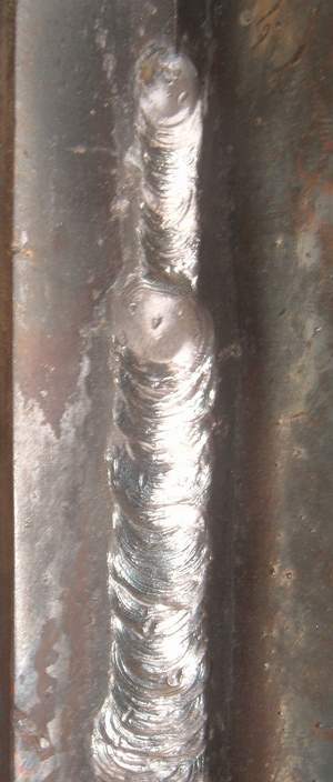

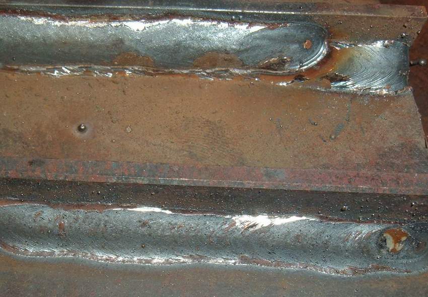

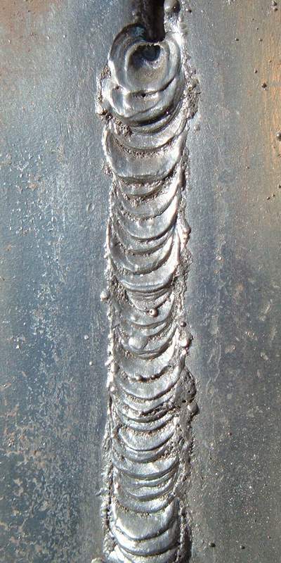

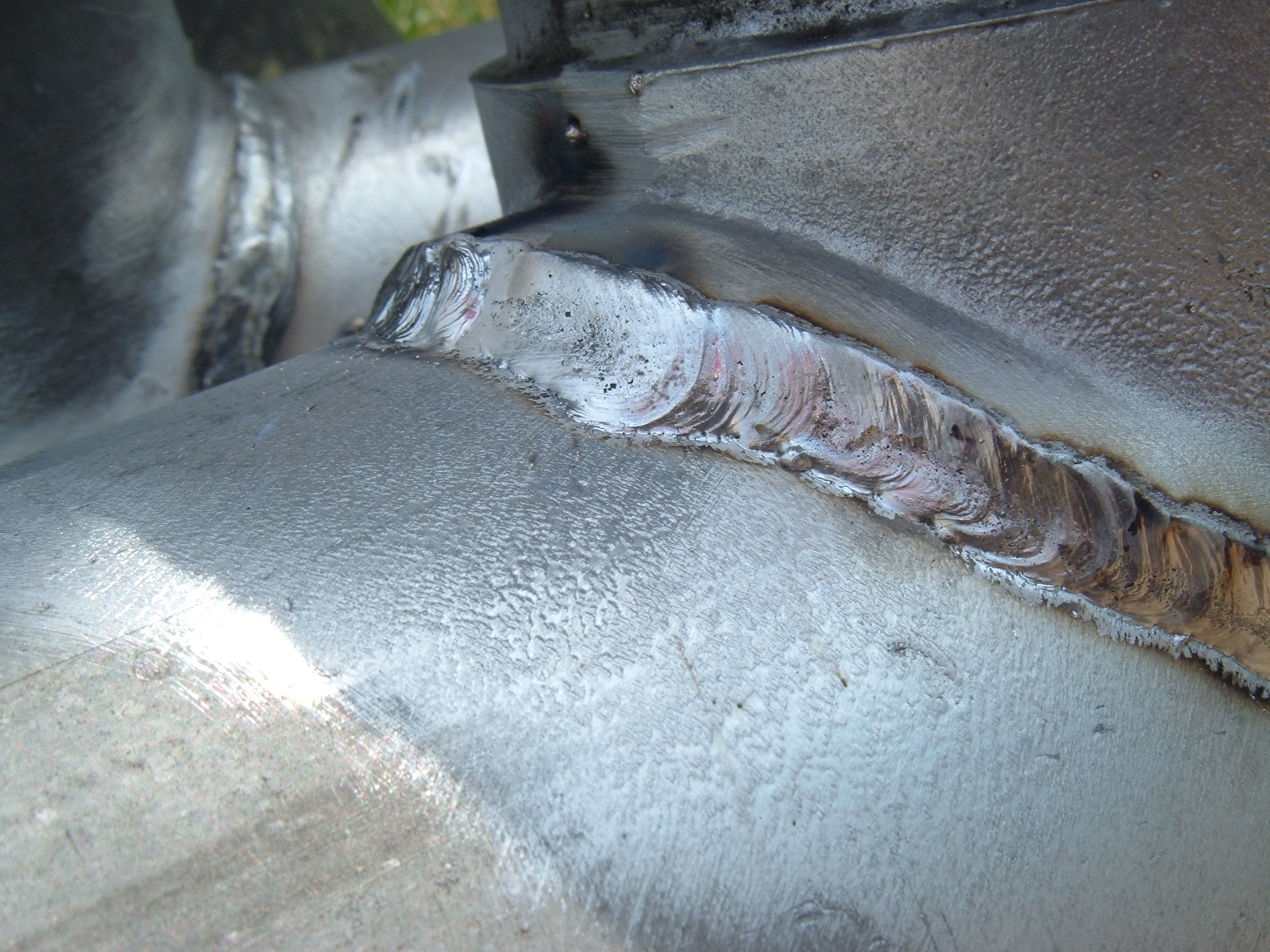

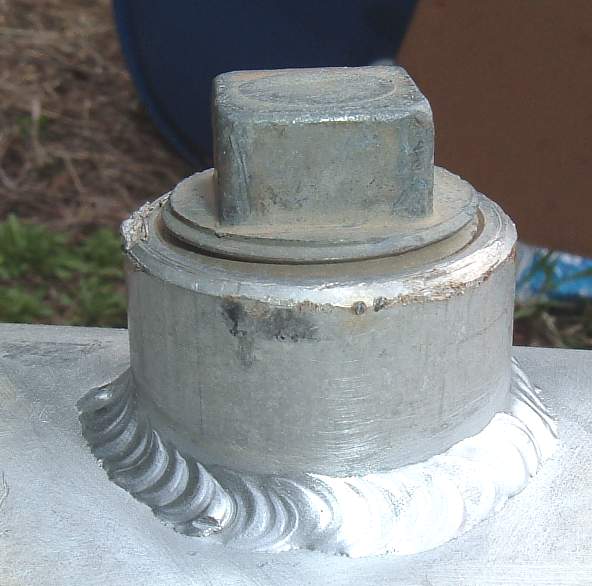

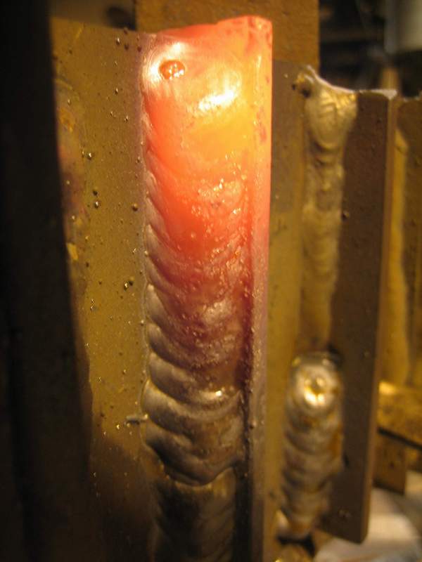

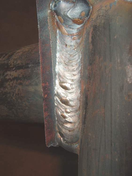

First machines,,,, most for the buck that do the most work. A 180-211 mig and an Everlast 150 class dvi stick inverter. Those are machines I would want even if I got othjers, they are the workhorses in a small shop and the 120V stick is about as handy as a pocket on a t shirt, maybe more.
I got 4 feeders, I use 1 mainly, a 180 and a little stick with a DC buzzer. Welder deals are not great in my area, I got a 140 around with 023, its a lately thing and is really nice for car exhaust. I can do it with 030 but its a lot easier on foil thickness with the smaller wire. I just never scored a deal on a Dialarc class, just didnt, I got a 300 Synchro and rarely use it but for a little alum,,, mostly use a HH210 and spooly when I got to.
Its a matter of ease and got to for me,,, I got them, can use them but dont, I really gravitate to simple anymore and back where I started with 6011 a lot of times. Poor fits, cracks and gaps outside and occasion just to try to keep a little hand in running a rod.
What I can do and what I regularly use are somewhat different things. About the only time I use anything different than the 2 small things is contractor work, mostly other peoples things. I got stuck behind a 180 the other day and finally said,,, wtf and got a 250 out. So much faster, 2x and half the material cost.
