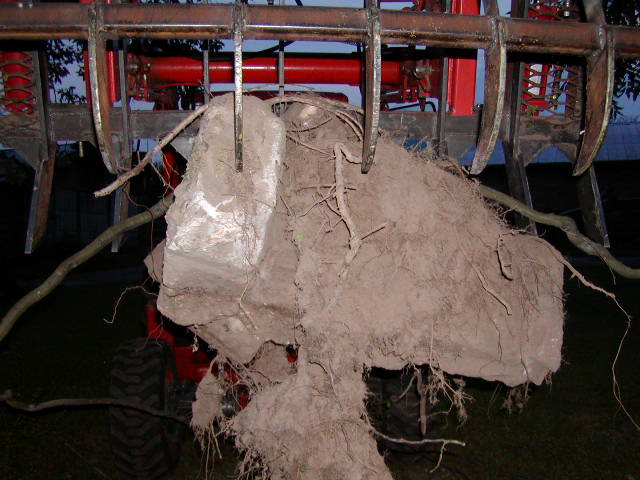

Sorry, I didn't take a pic of that view.
As previously mentioned, I was trying for 180 degree swing and was using 8" stroke cylinders. This meant, 4" below to 4" above the center point of the pin, which I didn't figure a simple way to make this happen because it would hit the pin.
I chose to try giving up some metal on the side of the pin, next to the cylinder.
That part is holding so far. Tonight I picked up 3 pieces of concrete and was amazed at how well it was staying in, so I had to turn it down to see if it would fall out. It didn't. Only 1 tooth of the grapple was hitting this 3' long piece of concrete.
I even cut the tractor off & went to the house for the camera, was still there, as you see.

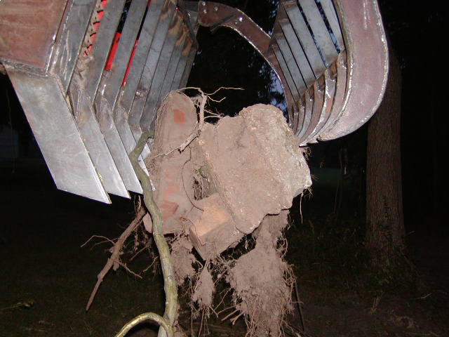

This view shows the 3 pieces sandwiched together.
If something else doesn't rip or tear, I think this may be one handy implement to have.
