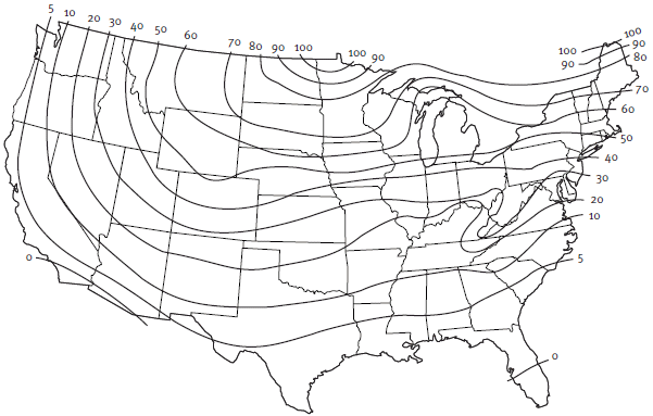

6 ft sounds perfect for laying water line- no fear of frost reaching it, and if in spots you can't get to the six- you'll still be below 5. What is your frost depth?
Back when we used to get 25 below with a wind- the 1.5 inch pipe coming from the well would freeze just below where it entered the house in the crawlspace- despite being foam insulated and wrapped very thickly with fiberglass batting. Cold penetrates- plan ahead.
   / Need input on insulated/heated water supply hose-
#16
6 feet would be a minimum, heavy clay soil and ledge in areas although where I want to run it- I can go down far enough.
This chart is used for determining foundation depths based on the frost level. 70 to 80 inches down in out area is a possibility. Even with a yard hydrant that drains the stand pipe, I may still need to install componenets to drain out the line or blow air through it.
It would appear that getting a 300 gallon skid tank, floating heater and running electricity to it might be the better option. I would ony have to top it off every 10 to 14 days. Whatever method I use to refill, the less often I have to drag hose or exert myself during the winter will keep my cardiologist happy with me..
