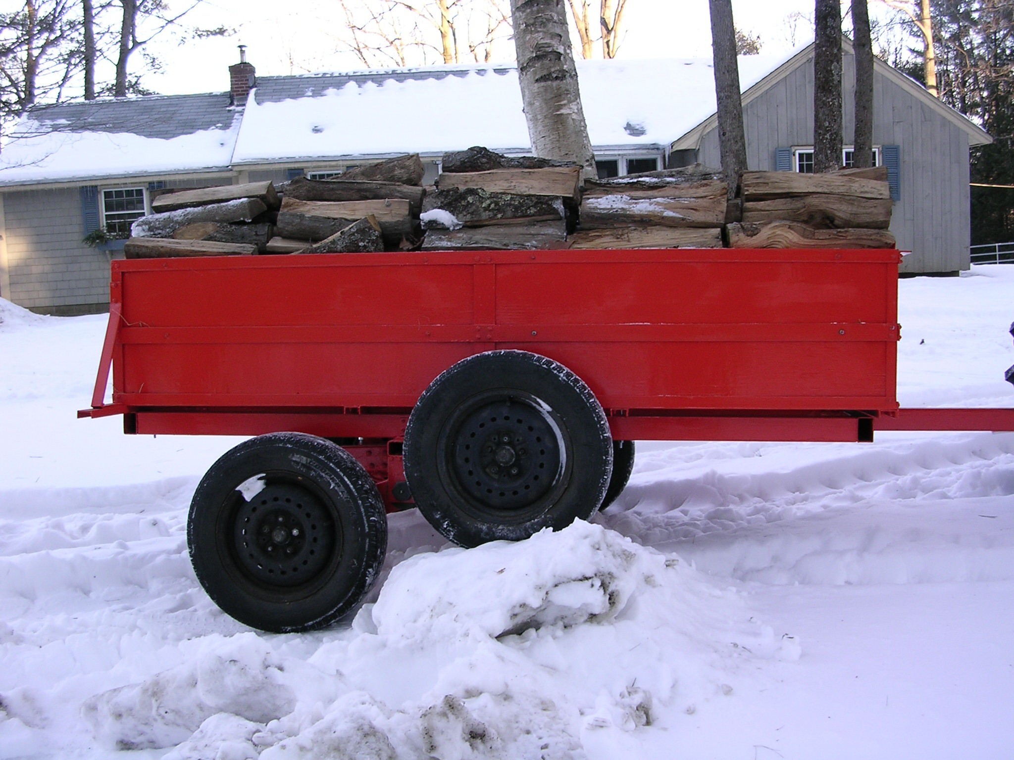

I built a trailer for the same purpose about 4 years ago. The features I wanted was a trailer that was narrow enough to reach across to load and unload from one side. It had to carry about 1/2 cord of green wood and be able to go over rough terrian without a lot of tipping.
I made a walking beam axle. This gave me four wheels to spread out the weight and the ability to have the trailer go over some pretty rough ground with ease. Tongue weight is about 150 pounds if loaded evenly.
The axle stubs are from a Dodge caravan.
Randy

As first posted, I think you will have more problems than you care to think about with that trailer. I think besides having to drag one of the axles sideways in a turn which requires some serious hp if the trailer is loaded, you might also have some problems with the tongue. With it swiveling you are loosing the mechanical advantage of a longer tongue which requires even more hp. Is there a reason for the swiveling tongue? Turning radius might be shortened, but at the risk of running the tires off the bead in an offroad situation.
I have a larger version of the stub axle trailer, using short tractor trailer tires and wheels, and 3x6 tubing for a frame, 27 foot long. The axles are near the back so the turning problem is non existant.
David from jax

If you are going in tough terrain a tandem trailer with sufficient front overhang to generate some drawbar downforce will get you further. It provides more grip on the tractor rear axle, and more positive steering when the trailer goes through ruts. In North America they seem to like 2 or 3 axle trailers with slew ring (or turntable) steering but in Europe, most harvest trailers are tandem trailers with 2 or 3 ton drawbar load since the 60's
In Germany you see some 2 axle trailers but in Holland they are very rare, just because tandem trailers are so much better off road, and they cannot jack knife on road.
