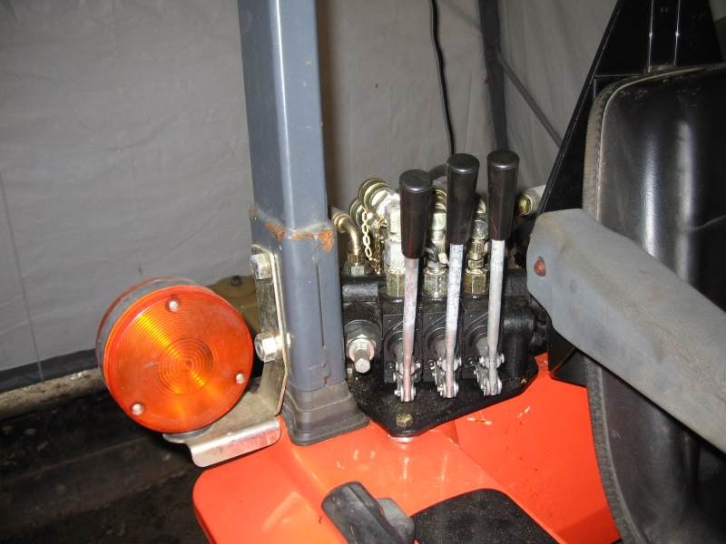

I believe the Gearmore setup (3 spool valve, top link, tilt link, hoses and mounting bracket is around $1400 or more. You can have the whole thing for less than half that using a 3 spool Prince SV valve ($250 max), CCM top link ($150), CCM tilt link ($150) and hoses and fittings ($125 or so) and hydraulic block ($65). This also eliminates the long hoses from the valve to the loader that Gearmore uses (they do not use the rear hydraulic block).
This gives you the best of all worlds in that you have 3 spools, and cylinders with check valves. I went that way and would not look back. Pic attached.

</font><font color="blue" class="small">( This gives you the best of all worlds in that you have 3 spools, and cylinders with check valves. I went that way and would not look back. Pic attached. )</font>
Am I seeing the picture right? It looks like the valves are behind and to the right of the seat. Aren' they hard to reach?

</font><font color="blue" class="small">( Am I seeing the picture right? It looks like the valves are behind and to the right of the seat. Aren' they hard to reach? )</font>
Not at all. In fact, it is much easier than your possible setup in that you are turning sideways and looking back at the implement and steering with your left hand. The right hand is almost in perfect position to use the valves. In your possible setup, the right hand would have to cross over the body to get to the levers which are much further up front. Go sit in the tractor and pretend to use it as you would while in the field. If you got long arms and are a contortionist then it might be comfortable.

Not at all. In fact, it is much easier than your possible setup in that you are turning sideways and looking back at the implement and steering with your left hand. The right hand is almost in perfect position to use the valves. In your possible setup, the right hand would have to cross over the body to get to the levers which are much further up front. Go sit in the tractor and pretend to use it as you would while in the field. If you got long arms and are a contortionist then it might be comfortable. )</font>
Is your right arm reaching over your seat. I can see it being a natural position for your right arm assuming seat clearance isn't an issue. Of course with the ROPS mounted valves there's always the "left hand on the valves, knee on the stearing wheel" approach. /forums/images/graemlins/crazy.gif
