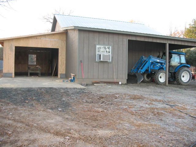

I dont like blown in insulation as it settles too much. In a year, you will have a void at the top. I have 6" bat in my house with 15" of blown in fiberglass on top when new and it is less than 12 after 1 1/2 years. I prefer the fiberglass batts or foam. I used the 6" R-19 bats in my shop in walls and ceiling with insulated garage doors and a 1500 watt heater will keep it as warm as you like. I have one in it now on low heat (750 watt) and with 25F outside this morning it is nice and warm inside and the heater thermostat had it cut off. I also have the reflective insulated boards under the galvalume roofing which helps keep it cooler in summer. I have it sealed in the ceiling(9' 8" height) and walls with 3/8' plywood inside and 1/2" exterior grade plywood outside so there is some insulating value to the wood compared to sheet metal siding or vinyl. Attached photo of shop with currently under construction 14 x 30 addition for boat/ lawnmower storage. I dont plan to insulate this portion right away, maybe later if it starts getting too hot in summer.
