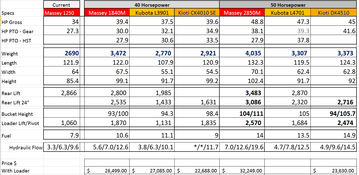

Adding the regular and steering GPMs together is pretty much meaningless as they are never used together. It makes a bigger number though, that's why manufacturers do it....
Of total flow, about 4 gpm is used for PS on tractors this size, the rest for everything else. The chart IndyJay posted shows Kioti's total gpm including PS, while only Kubota's w/o PS.
   / Need L3901 alternatives #16
The spreadsheet evolved over a period of several weeks/months, before I even joined TBN. I started out comparing Kubota and JD. As I added more tractors to the list I started adding more details. I never really thought that I would be sharing the information so I didn't necessarily go back and fill in missing or incomplete data, especially as I narrowed down choices (like going to a larger frame and HP). Since I have shared this a few times and may again in the future I will make corrections to the Hydro capacities. There was no intent to deceive, just plugging in numbers as I found them on Tractor Data at the time.
I wish I had kept the green and blue tractors in the spreadsheets. I didn't think I would ever have use for the information again once I narrowed down my choices.
