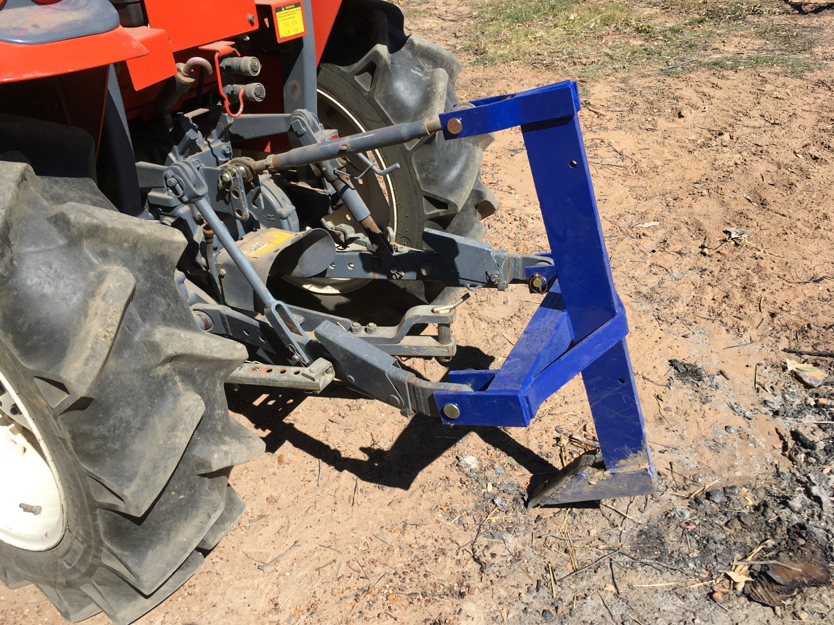

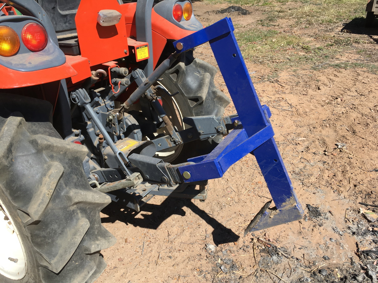

I will try and add a photo of the set-up next time I get to use it.
   / Need more down pressure on my 3PL for a Ripper
#9
2 x photos.
fully up and sitting down.
